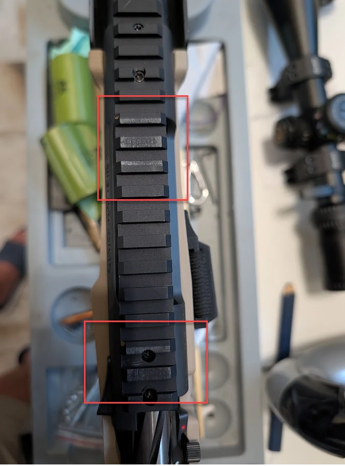

Not sure yet, but the issue all along may have been here:
Outside of some pressure sign I had on my SGKs, I was getting sub moa groupings. And since for these loads I tried moving the jump back just a bit, I knew my pressure my be up. And since I made the change I load 10 round of ELDx and the first 5 were .52 MOA. Next 5, 2.4 inches. left right stayed true, but the rounds POI were all elevated.
I can’t explain why all the first shots were sub MOA and the last were over 2", but I know that when I load and shoot my 6.5 CM I am at least .75" in heavy winds. So, my loading process shouldn’t be the issue.
I have never seen this before on a Pic rai, but I assume (and someone please confirm if this is right) that this is most likely the culprit. The action screws were tight, the suppressor was tight and the rings were tight on the scope. I mean, what else could it be?
