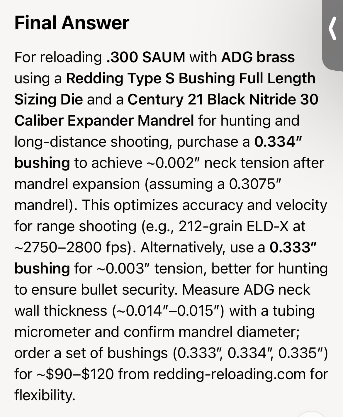

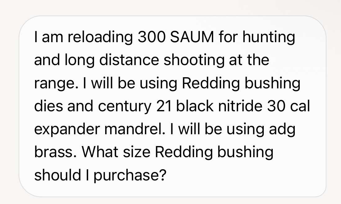

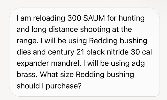

If you go the expander mandrel route and bushing die route it can be a bit confusing at first. Redding and whidden and others make bushing dies. Then you also get the bushing and the expander mandrel and the expander die body. The trick is you have to choose the “correct” bushing size. You could figure it out on your own or you can plug your information in to AI and it will give you the answer. For example…
