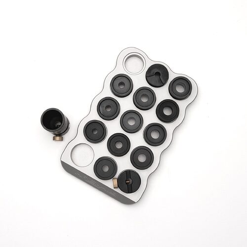

Area 419 claims that their guages take actual measurements, not relative.
Don’t know how accurate that claim is.

Their claim is very dubious, and only applies to comparing your measurement with other people that have the same set. The Whidden case gauges are the only ones I know of that will give you a consistent measurement, and they calibrate them against a ‘go’ gauge.
