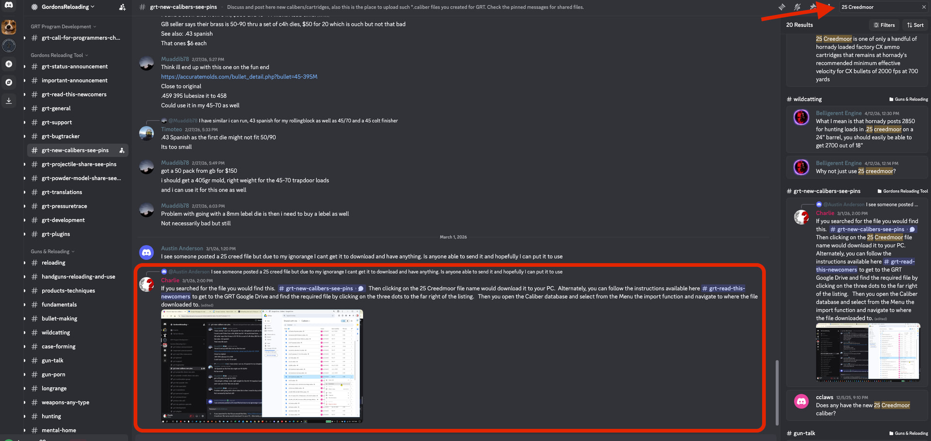

If you haven’t already, I’d install (GRT) - Gordon’s Reloading Tool on a computer, create a Discord account, join the GRT Discord channel, and you can download the 25CM profile to your local GRT instance you installed on your home computer. From there you can tweak and experiment with all of the powders and projectiles you have interest in. If a projectile isn’t in the database, you can find another similar one and change the dimension to match the one you’re testing to get you close. There’s also a ton of “How-to” videos on YouTube on how to use GRT.
Verified, there is a 25CM profile you can use:
