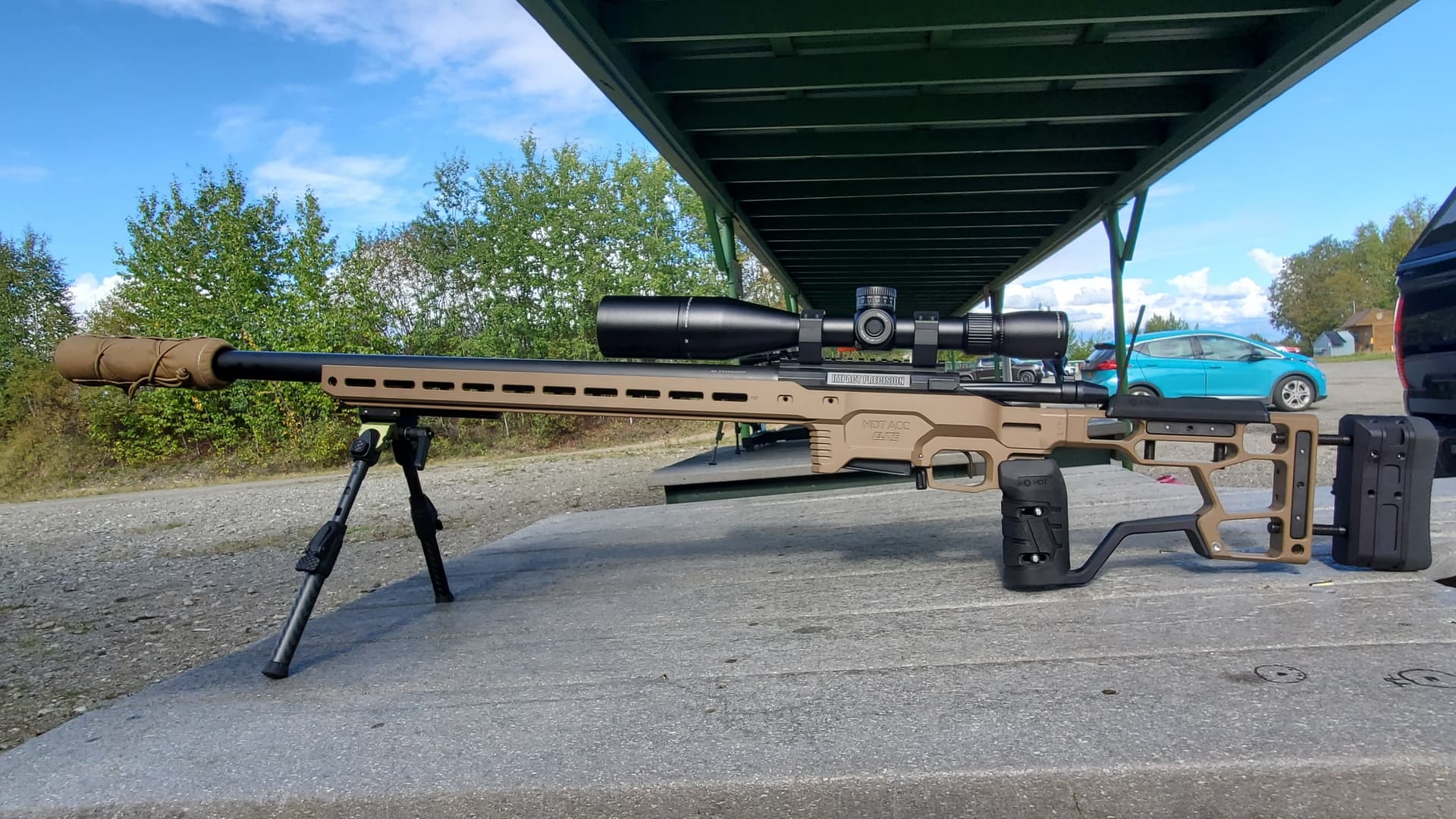

I thought I would share the finished product from Altus barreled action with Timney "The hit’ trigger set at 8 oz. I have to say I am already in love with the trigger pull never having used a light trigger before. Topped it with a Vortex Razor HD LHT 4.5-22 x 50 and Ultra 7 suppressor. I already had the MDT bipod but will likely search for another more stable one if anyone has suggestions. I really love Elite Iron Revolution bipods but it won’t work for this build. Thanks again to Jim for the awesome chassis.

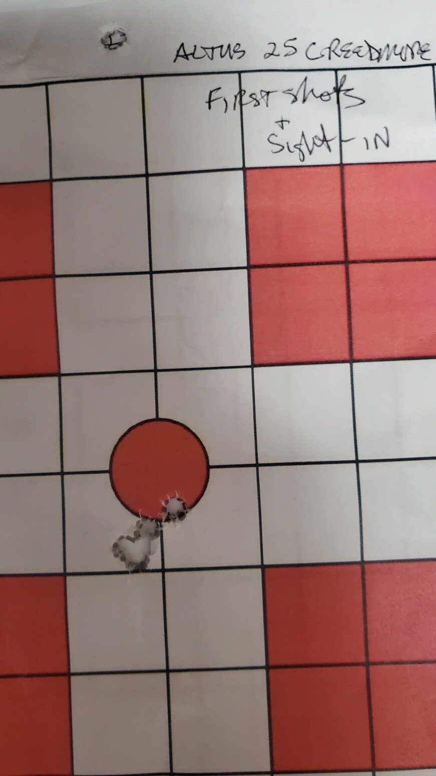

This is a 100 yd group of 5 of my first handloads out of the rifle after sighting in. Looks like a shooter to me…
If you want stable I love my accu tac bipods. Built like a tank. Nice shooting
Murray,
Which model did you get?
I have 4 different ones based on the type of shooting. I have the tall f class one that pans and tilts, love it for bench rest. The narrow tall and short version that tilts and the intermediate width one tall I use for prs. Love them all. Mine are all arca but they offer both mounting ooptions
