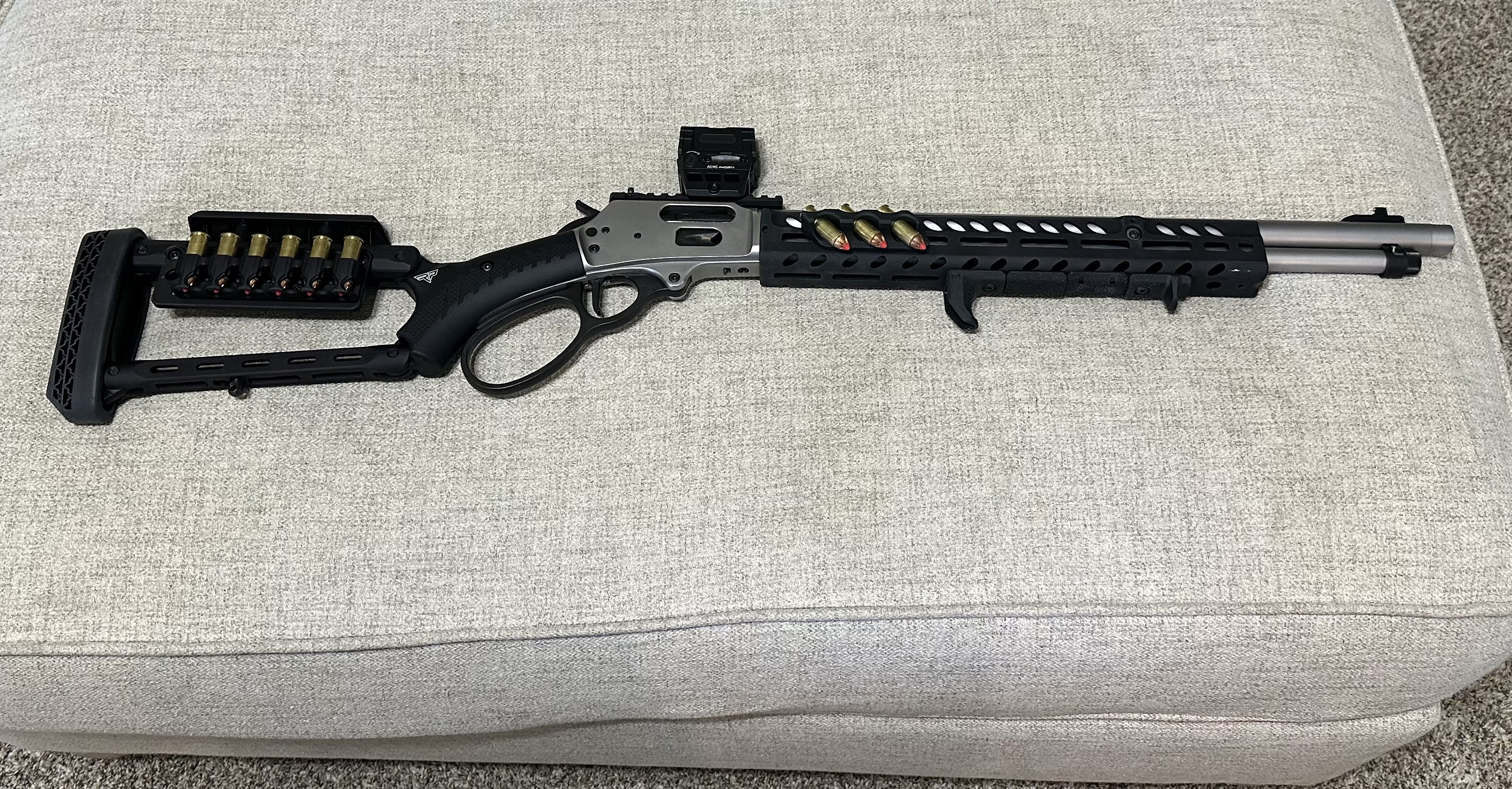

Now for the fun part. Im very new to building rifles,
But I’m wanting to build something that I’m excited to shoot.
Chassis, barrel, action, can, scope, mounts, the whole 9yds
I want to start with 300prc. I know a rifle can be built with thousands of dollars, but my goal is to stay away from 10k. I am expecting it may take me every bit of 5k for the rifle I’m wanting to build just from some pieces I’ve looked at, but I have no idea what I should get or what I should stay away from.
I seen a 7prc Jim built that got me interested in making one for myself.
This is all I’ve ever built so I’m very lost past the lever guns
