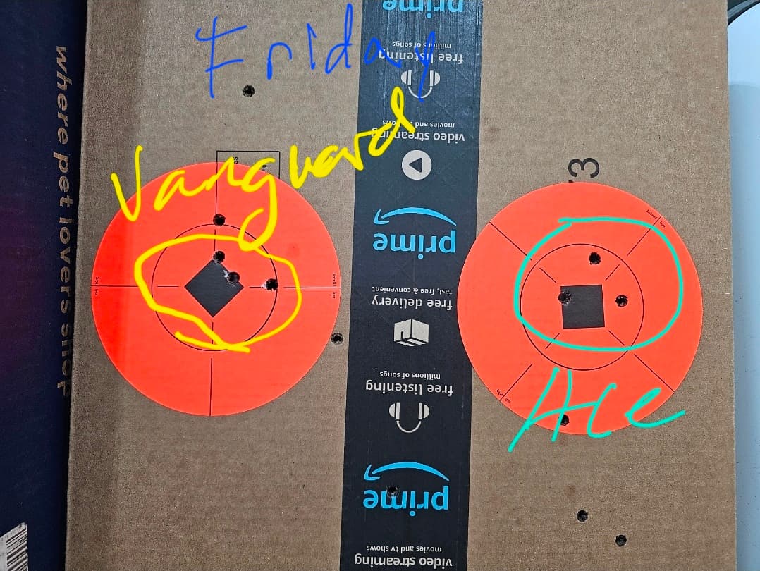

I have a new Ace Game in a 300 WM. Also have a Weatherby Vanguard S2 in a 300 WM. Used to group really well till I dropped the scope. New scope on both guns. I have a mule deer hunt that starts Friday. So I have not had time to reload and find a load they both like. Even though I still have some loads the Vanguard liked in the past. Working through 3 factory loads I felt like I was getting close. But the Ace I could not get under 1” MOA. (Ordered my suppressor but thanks to the government shutdown it won’t be here in time, who knows when I’ll get it. :laughing:)

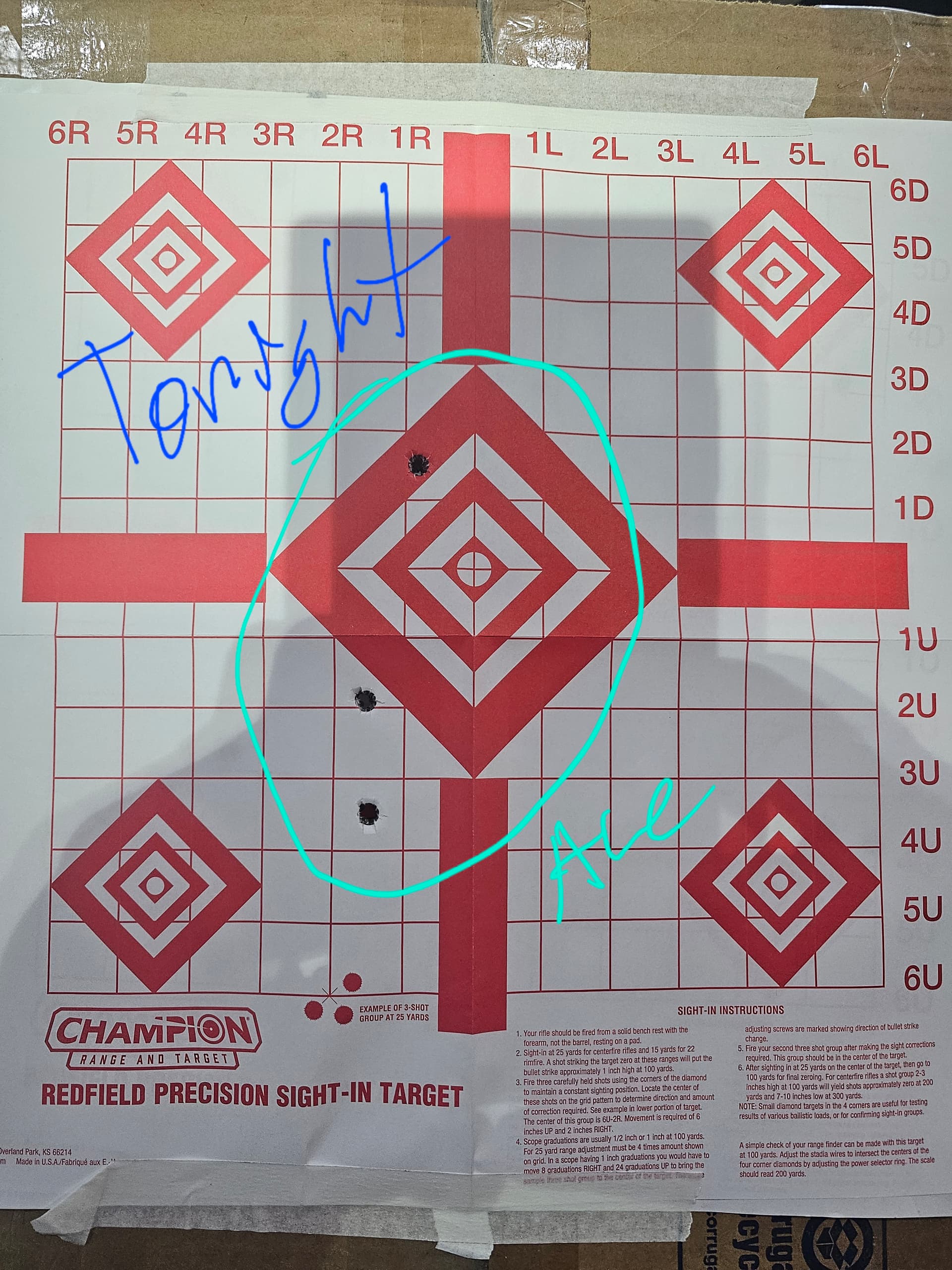

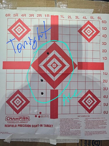

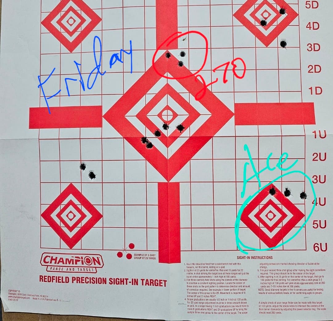

Friday grouping ok and getting closer. Today 5” groups. What gives? Nothing changes on the rifles. I did remove and then add again my bipod. MDT Oryx and Accu-Tacc. Same ammo. Not sure what the crap.

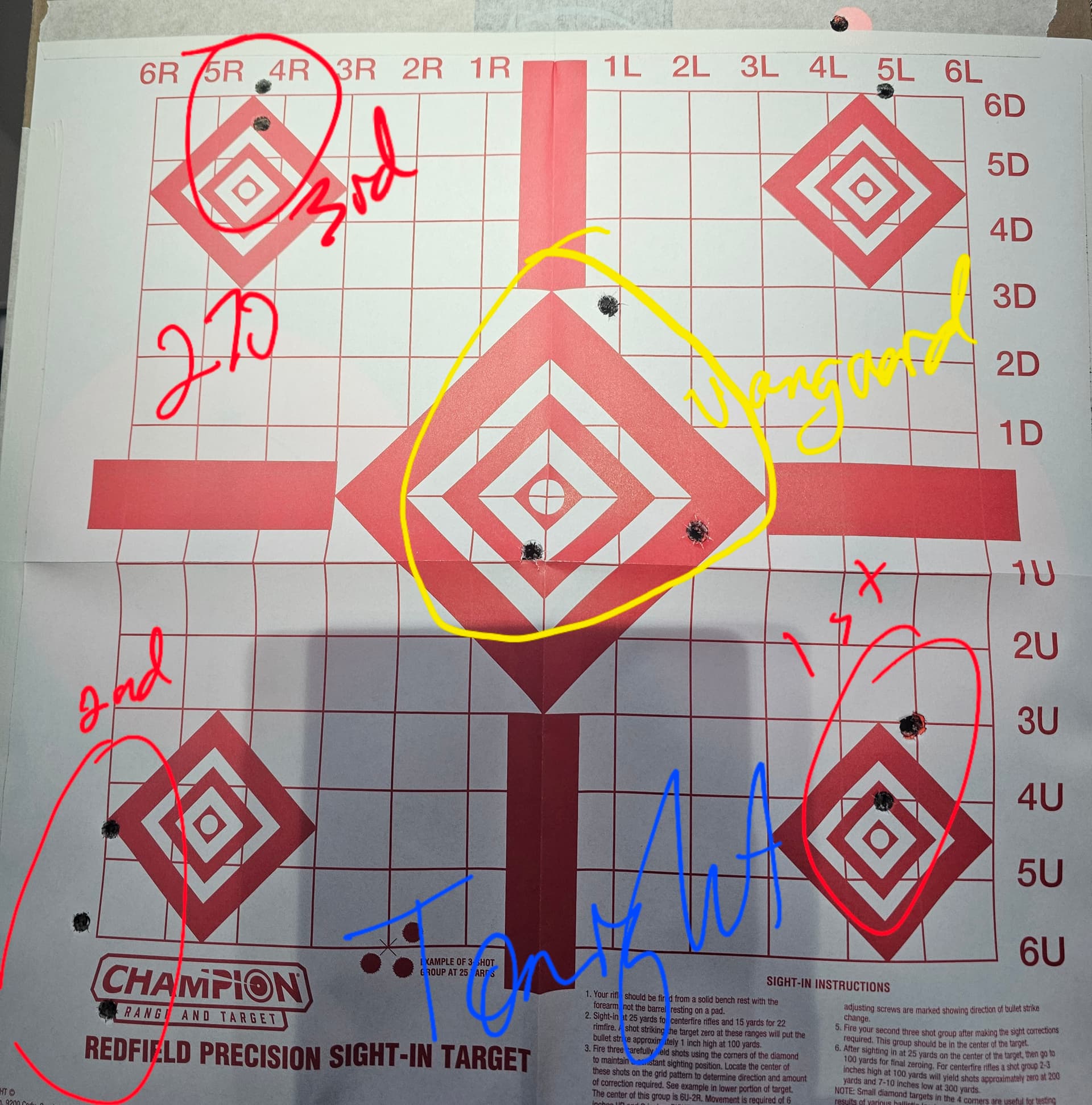

I also had a 270 that I added a new scope from backfire to the gun. Barely foresight it Friday and got it on at 50 yds. Tonight… not tight at all. I felt solid. Using a bipod and a rear bag. But I just must be way off today. But now I am scared to death of my Idaho hunt on Friday. :scream:
In the pics attached you can see my better groups and then all over the place tonight.

Thanks for everyone’s input. I will definitely go back and check all 3 guns to make sure torque was correct and check the action screws. Frustrating thing is that it happened to all 3 guns. I did clean all 3 guns thoroughly between Friday and last night. I am going to check Torque and go shoot again tonight. I really think it was just me last night since all 3 guns were off. Didn’t help that it was in the low 40’s with some wind. I was in shorts and probably rushing shots trying to beat the dark. Even though I thought I was solid and taking plenty of time with my shots.
