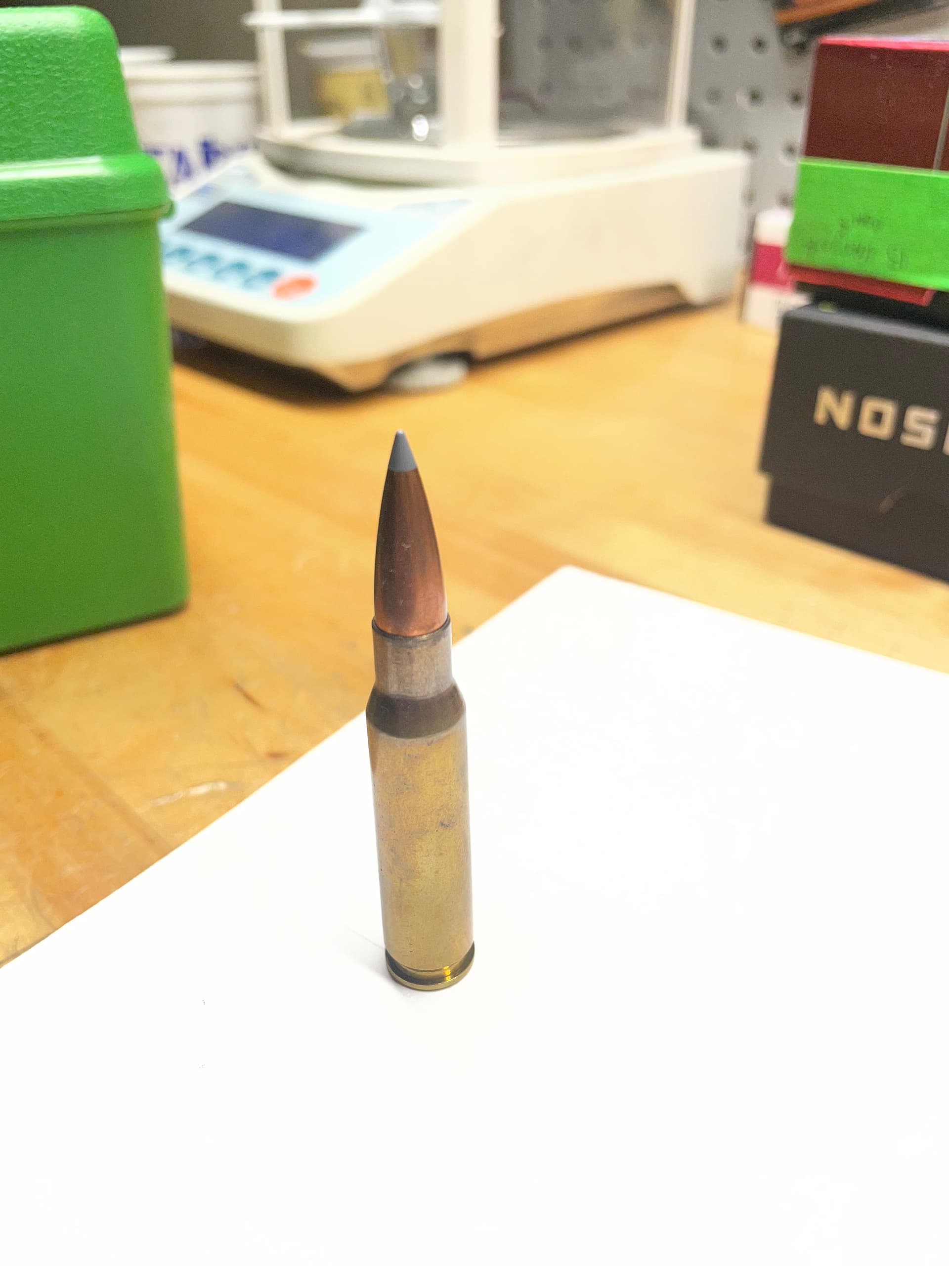

I know it varies from gun to gun, but I’m interested in some of your 308 loads that perform well. Anybody got a good one that shoots well in a bergara? I’ve been shooting 150 grain accubond with ok results. Lapua brass, 45.5 gr of varget COL 2.8 and Ogive 2.1860. I can’t find my groupings, but they were probably just under a MOA.
I’m fairly knew to reloading and haven’t reloading in several months, so I’m scratching my head where to pick back up.
I probably need to play with the jump, but would love to see some of your good loads.
168 ABLR with 46.0 grains BL-C . I load to 2.170 BTO in F.P. stamped brass. Just over 2700 fps and shoots sub .7” groups out of my 20” rem 700. Also have some very accurate target loads with bthp. shoot even better. I do anneal mandrill size and moly lube my necks.
