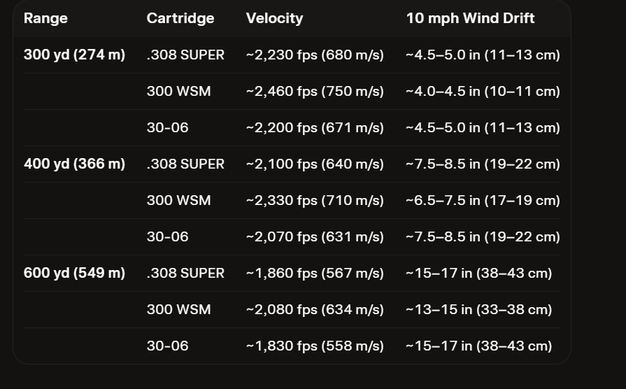

You’d need to work up a load, but you’re looking at a solid copper round that’s 212 gr with a G1 BC 0.705 G7 BC .350
Recoil is a bit heavier than a .308, but not a lot. And it’s better at longer ranges 300+ than a .30-06

The guys at Barnes are talking about it on their podcast as well…and I actually talked at length with the guy at Barnes who is playing with the 308 Super. Muzzle velocity is only 2500 (with Varget), but incredible long range terminal performance due to 1. the very high BC and 2. because the functional window on this bullet goes down to about 1600 fps (some would say 1500 but…). Effective hunting range 800+ yds (some say 960 yds max assuming 1500 min terminal velocity), not that I would take that shot. But great for 1000-1200 yds at the range.
