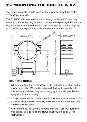

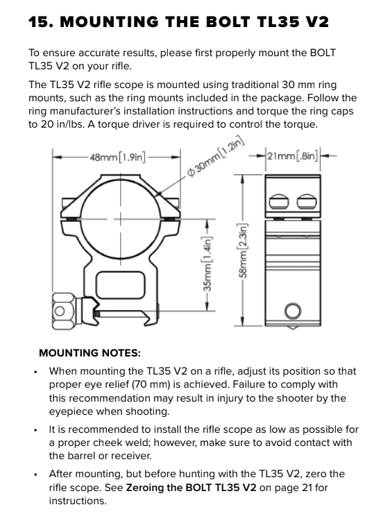

30mm scope rings. My tube tl53 thermal says it has a 30mm tube. Says its 30mm scope rings but its a 1.2 inch tube which is not 30mm typical scope ring fit. I knew when i bought 30mm rings they looked small. Can someone explain to as my first wife called me, a public school moron, whats the measurements and a 1 inch tube vs 30mm scope rings and whats all this mean and how this all comes together. Hope im making this clear. Thanks…and btw I think i would be around 50% on the 600 yard challedge…maybe. Happy off season guys!!!

1.2” is pretty close to 30mm - .05mm off - I think .

30/25.4 = 1.1811 inches. 1.2” is bigger. 25.4 mm is the official definition of an inch. Well maybe 2.54 cm but the same regardless.
