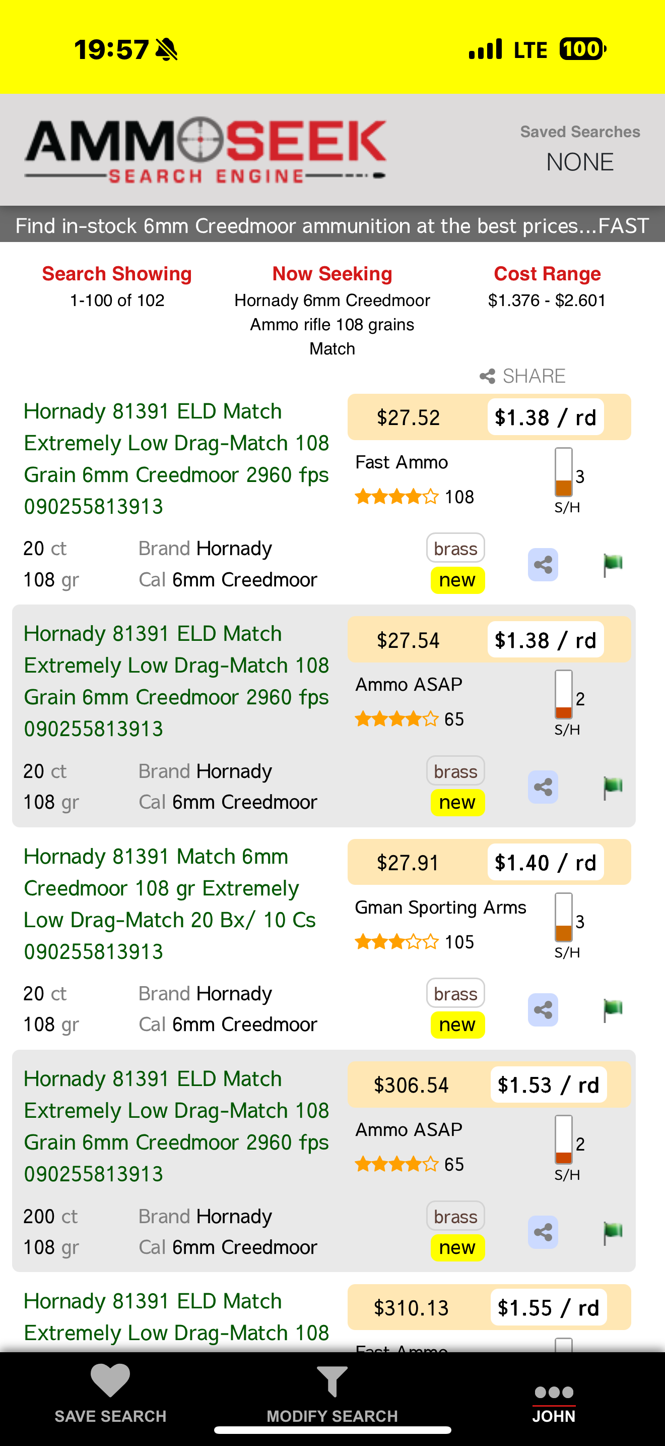

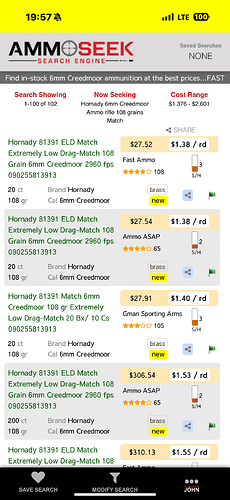

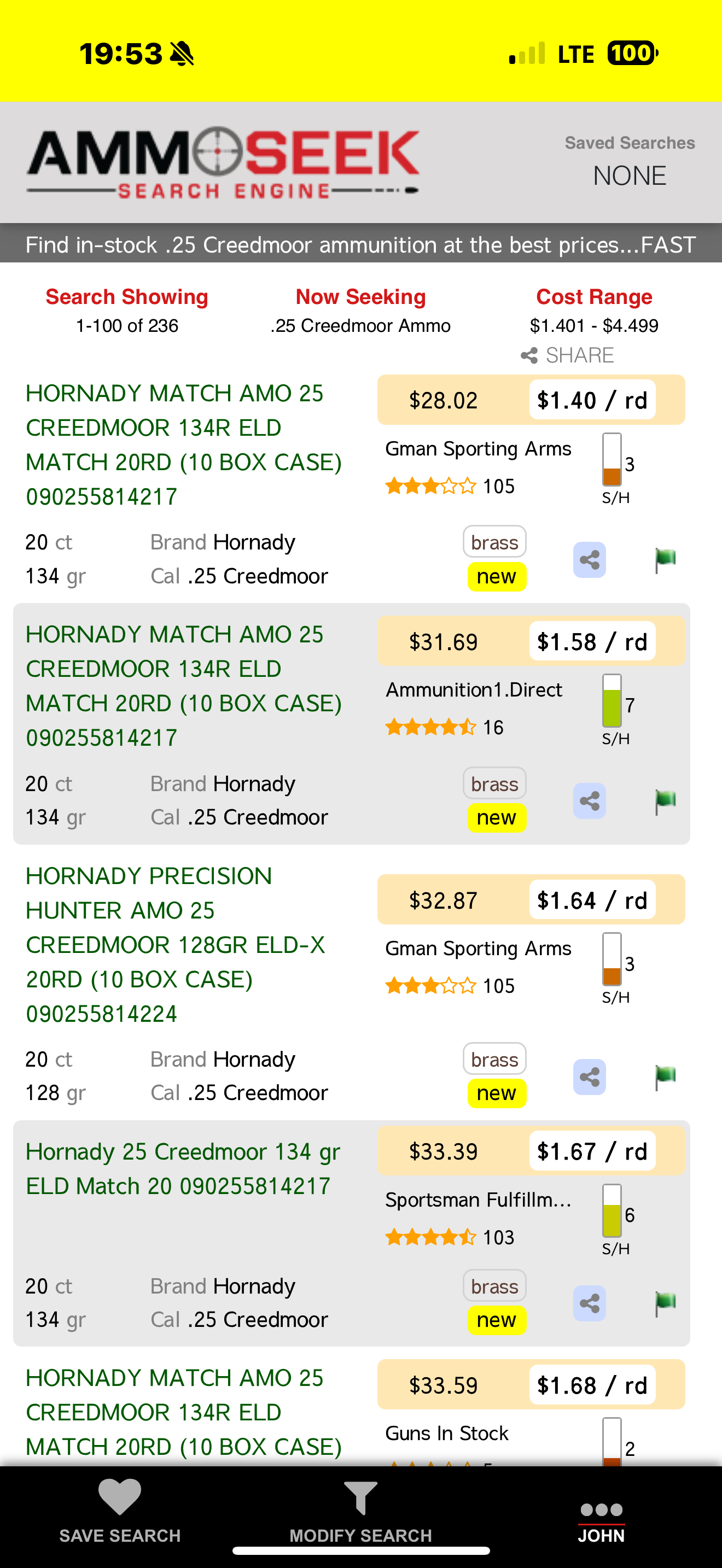

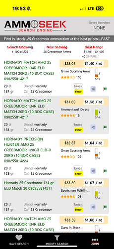

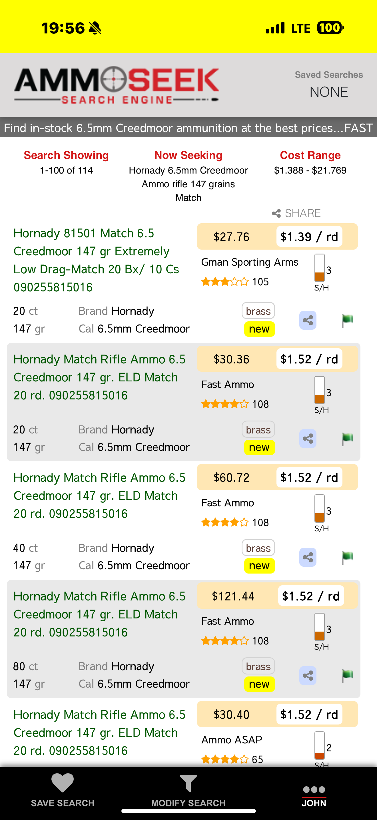

If it’s price your factoring into the whole discussion, your looking basically the same cost in ammo between the 6.5 creedmoor
6mm creedmoor
25 creedmoor
My choice would be the 25 creedmoor, I think long term your going to have a larger range of bullet weights

Interesting thoughts on the 6CM. But, to be honest I think I am leaning to the 25CM at the moment as it bests the 6.5 in BC, has better barrel life than the 6CM, and I found ammo pretty easily at Buds; which was only about 50 cents more per box of 20 than the 6.5CM - which is really why I was considering the 6.5.
