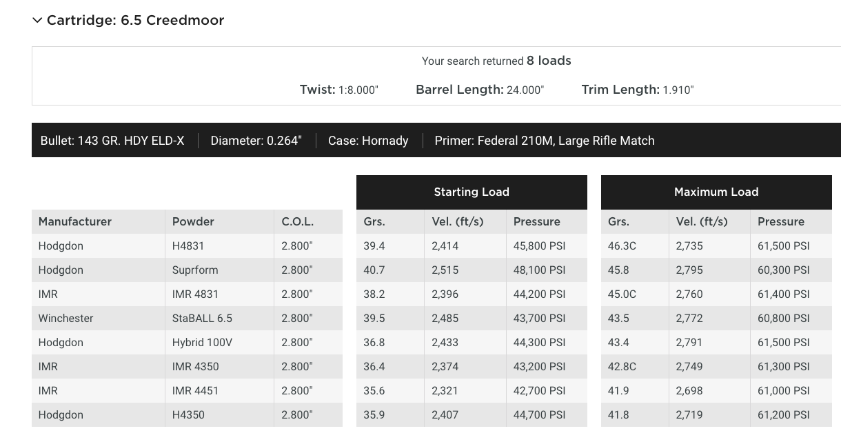

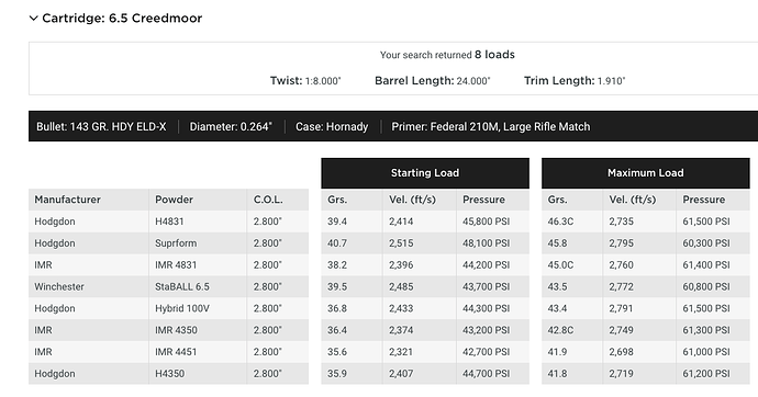

Depending on what powder you have on hand, this is what Hodgdon’s site recommends for the 143gr Precision Hunter.
https://hodgdonreloading.com/rldc/?rdc=true&type=54
