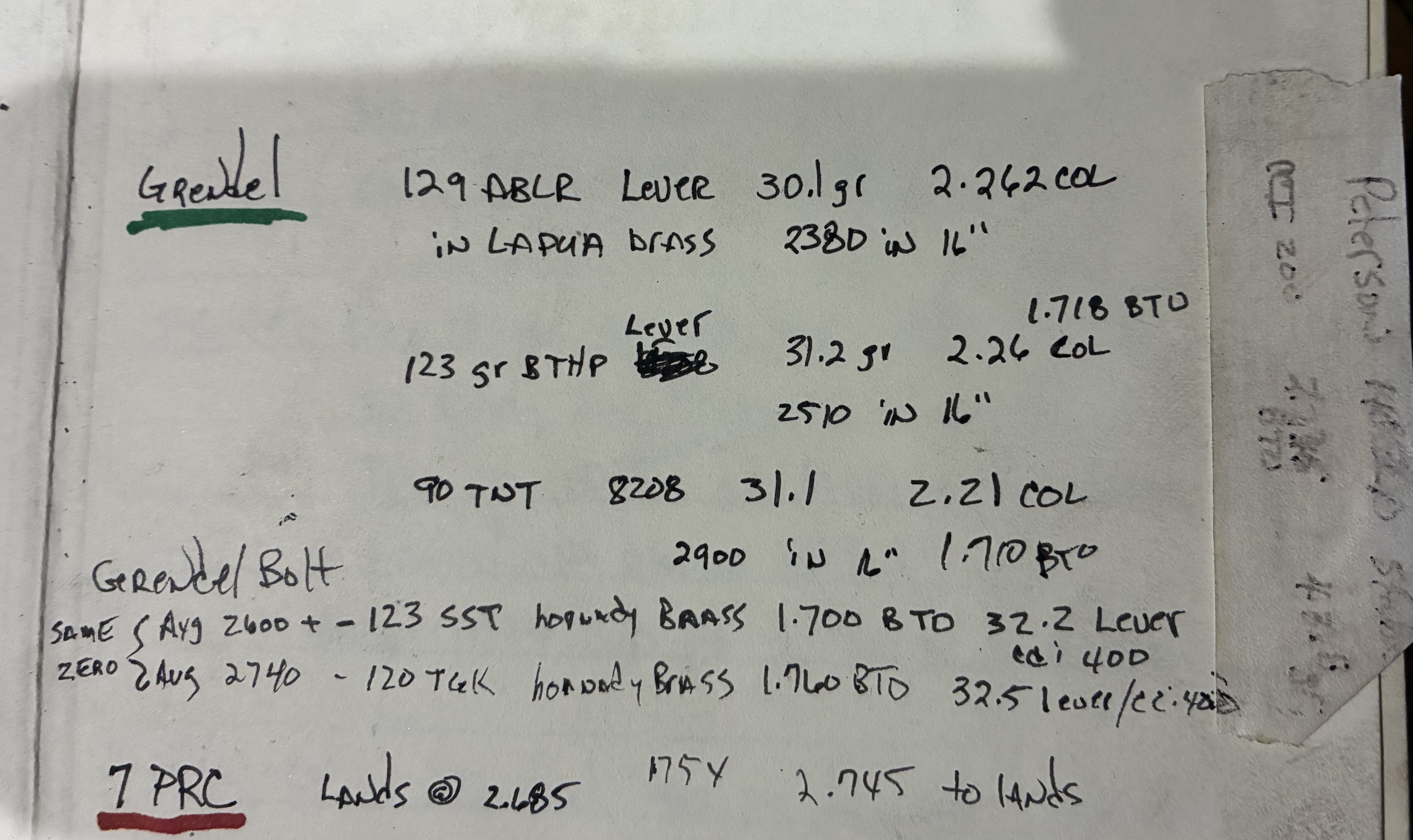

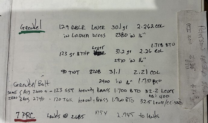

Im definitely interested in the AR setups. I have a 16" barrel and I use it 100% for shooting out of box blinds during whitetail season. Furthest shot would be about 200yrds. Im getting decent results from box ammo but would like to tighten it up a little.
Here is a good starting point. The sst and bthp load the same.
What powder and primer are you running on these?
Leverevolution is what i use for grendel mostly. It will get you the best speed with good accuracy, not great standard deviation. Ok dont see that a15 or 20 S/D would matter inside 300 yds anyway.
