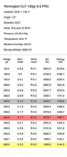

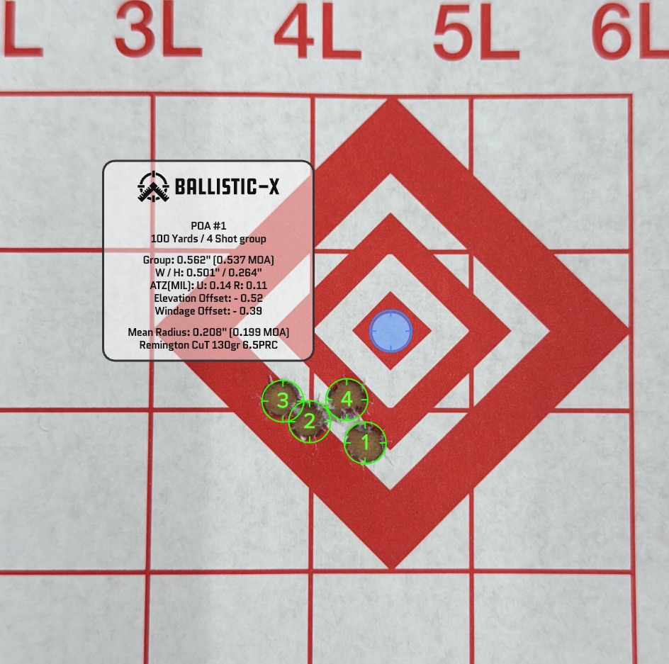

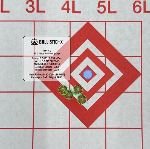

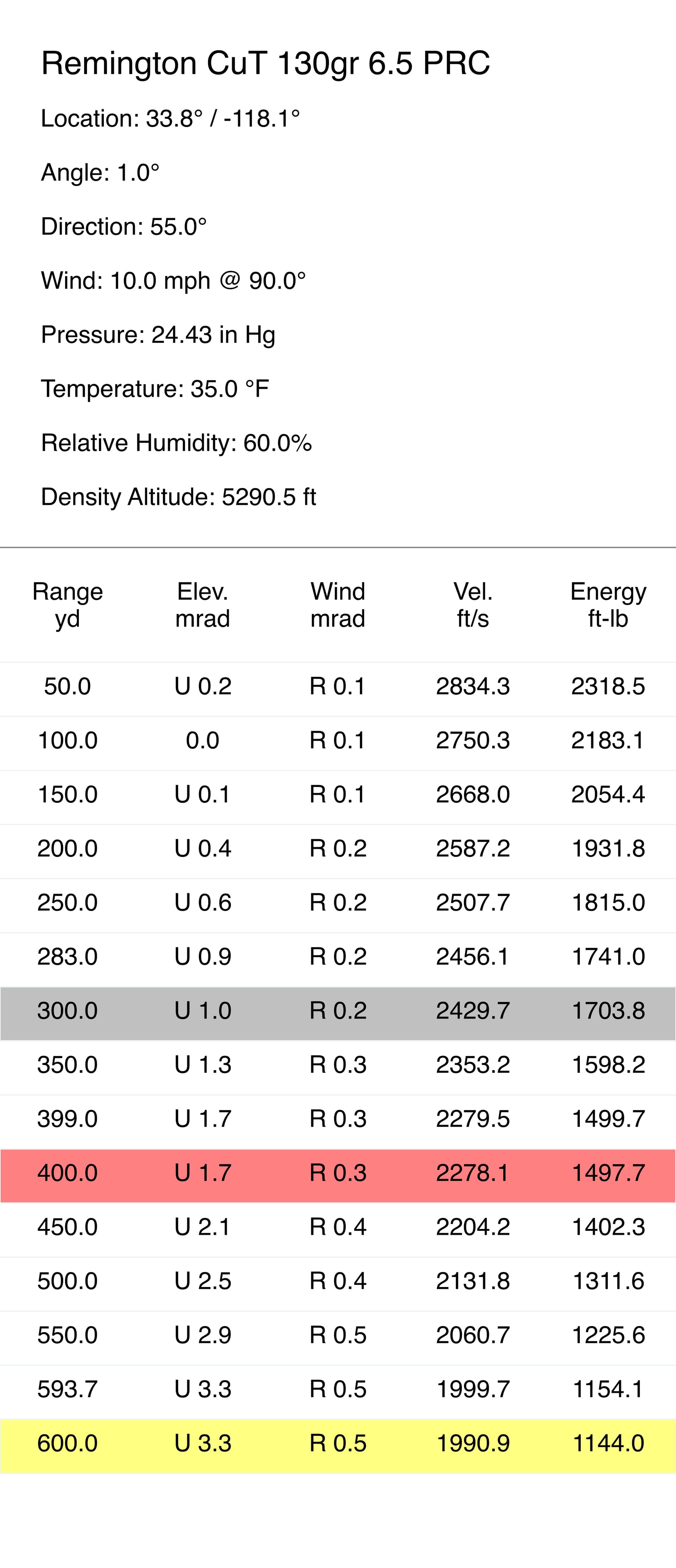

  1. Remington Premium CuT 130gr. shoots awesome (~.5” moa groups) and performs well @ 2920 7 SD. (SOLID COPPER)

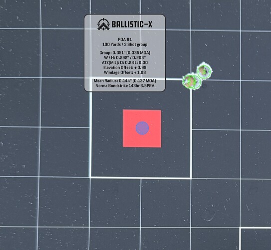

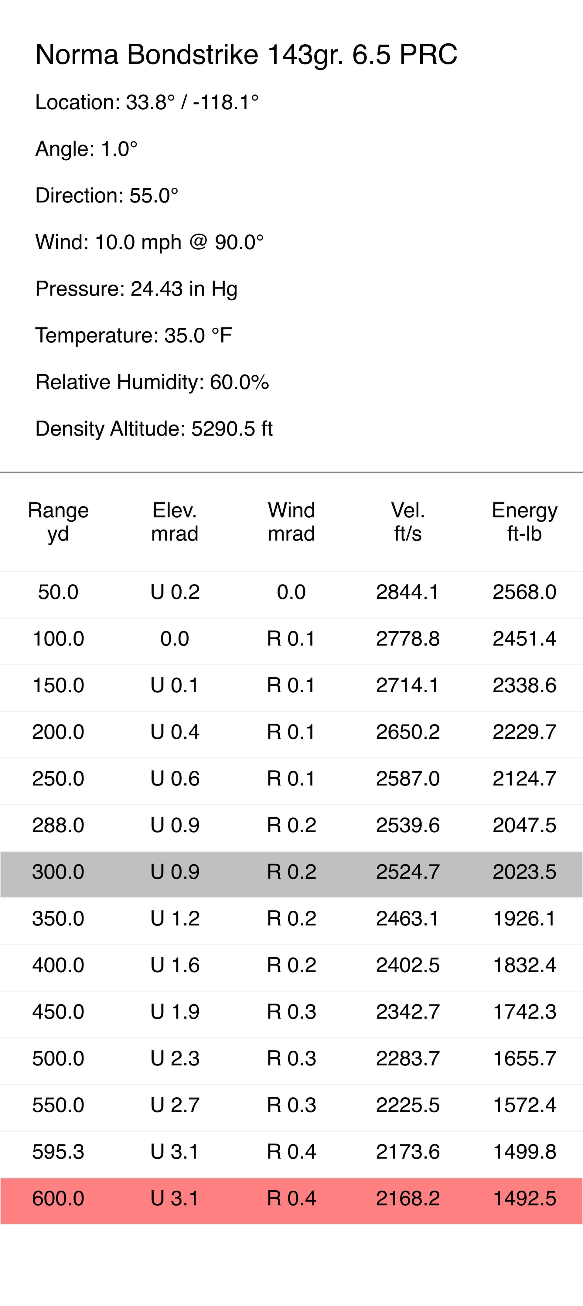

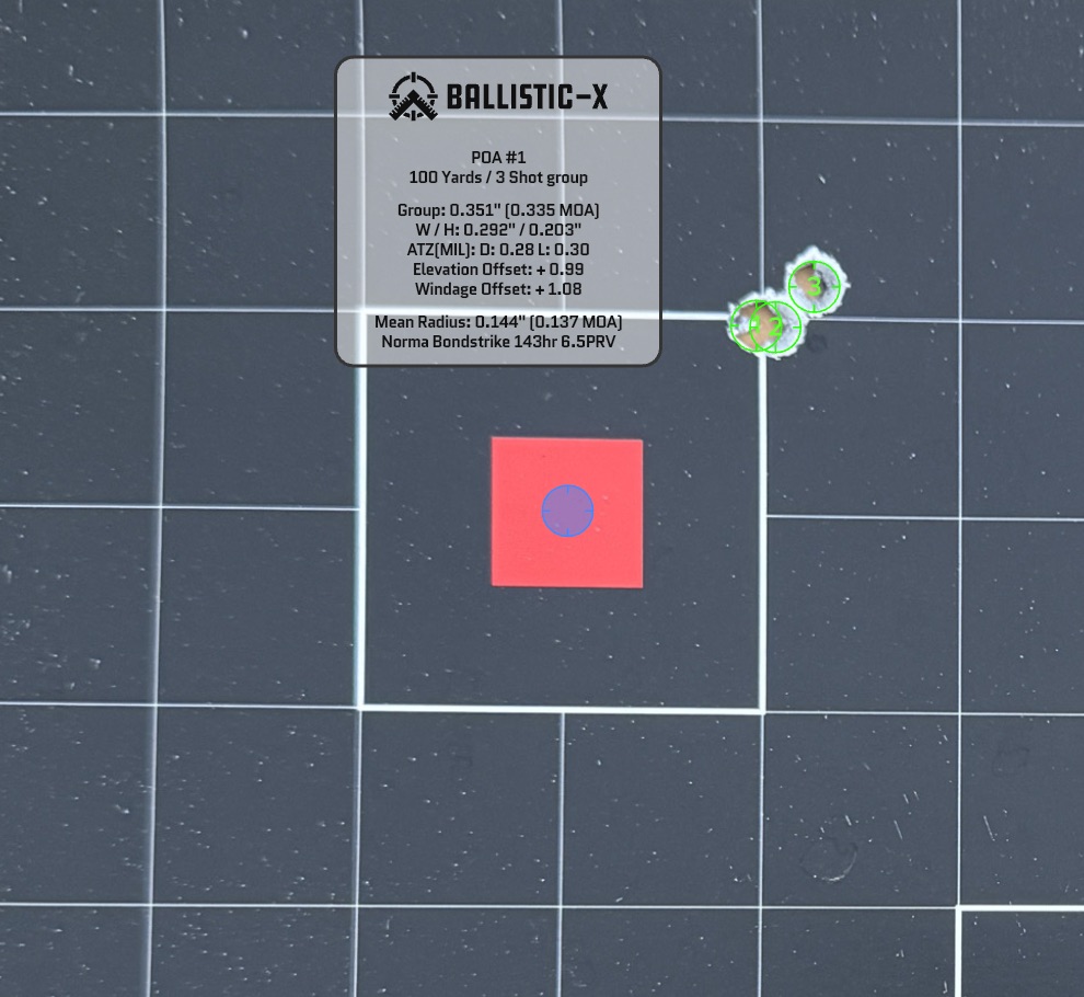

  2. Norma Bondstrike 143gr. shoots even better (sub ~.5” groups) and also performed well @ 2910 15sd (BONDED LEAD CORE)
The Norma has a much higher BC and really retains velo and energy.(see attached ballistic charts) wind is also better, but not much.
So, monolithic copper with a max range of 400 (probably my max hunting range anyway?), or a Bonded bullet with superior range and ballistics?

My preference would be the bond strike for elk. It’ll stay together well and still penetrate deep, but a bigger mushroom. For CA, it might be worth testing some other copper loads like Hornady CX and Barnes to see if there’s one load you can just stick with.
Thanks, Jim, yeah, I actually tried both, lol. The CX grouped just fine, sub MOA, but just did not perform as well as the Remington CuT. CX was 2830fps 25sd

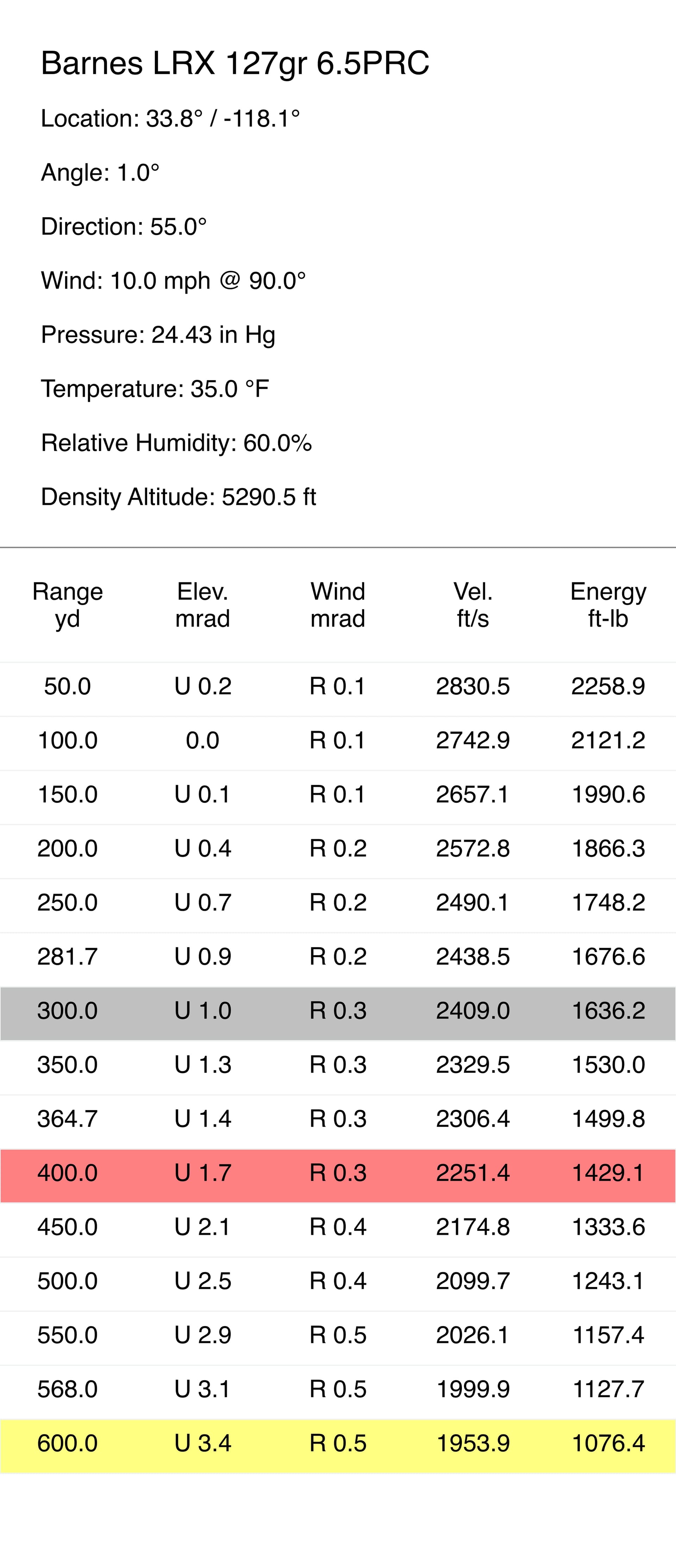

I really wanted the Barnes LRX to perform well, but surprisingly, my rifle just didn’t like it, and it would not group under 1moa. also, being a127gr. it too did not stack against the Rem CuT. Barnes ballistics below
Ok, so Remington CuT for CA and Norma BS for MT Elk! Ok, thanks!
I can vouch for the bond strike . Shot a spike last year 380 yards pass through heart shot. Did not recover the projectile but the damage could be seen.
He didn’t go 20 foot..
That’s great to hear. After posting this, I did some reading and watching on the Bondstrike, and my takeaways were that it’s a ‘softer’ bonded bullet that seems to fragment at close range and doesn’t seem to penetrate as deeply as other bonded bullets (Accubond or Scirocco). The Accubond shot well out of my rifle as well, but much more expensive($20 more a box) and the ballistics were very similar to the Remington CuT, so I eliminated it as an option.

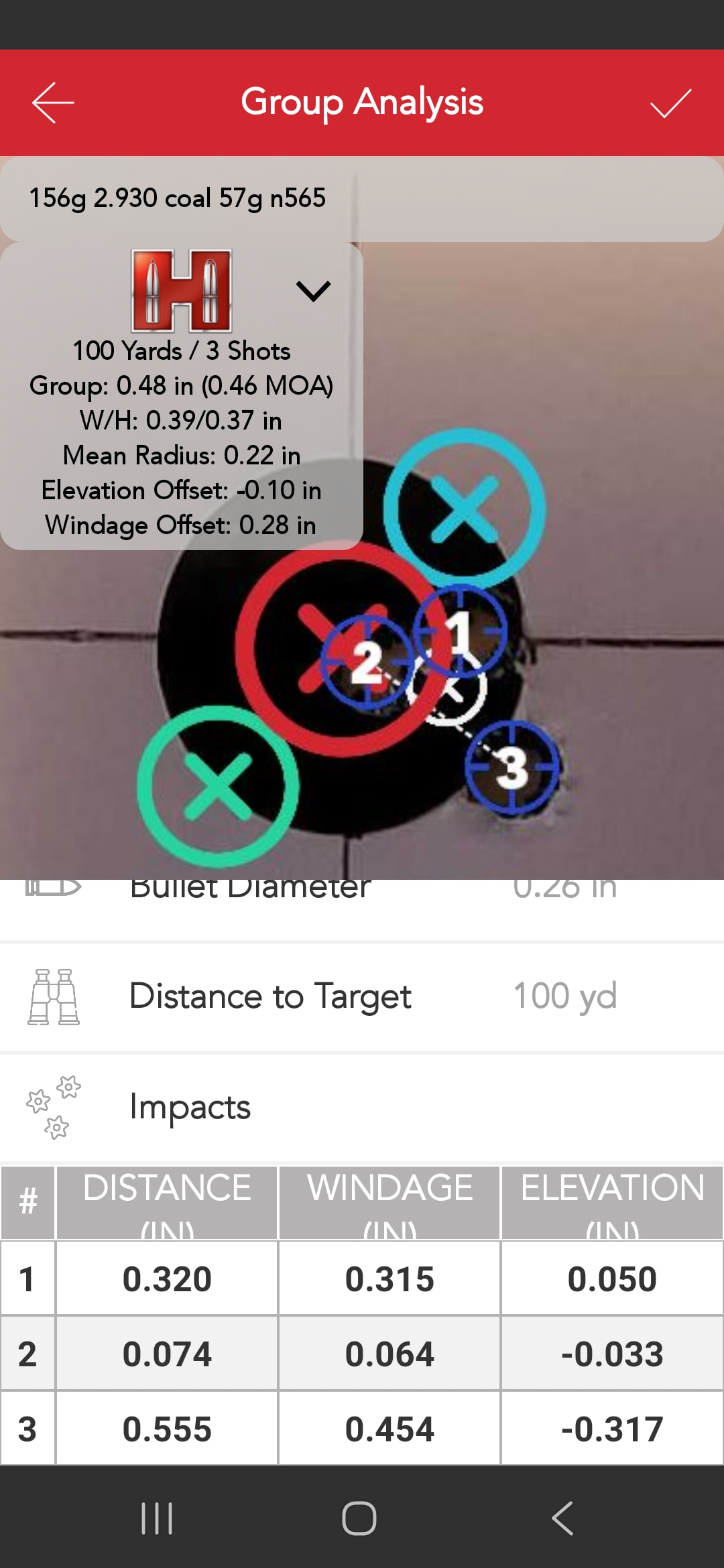

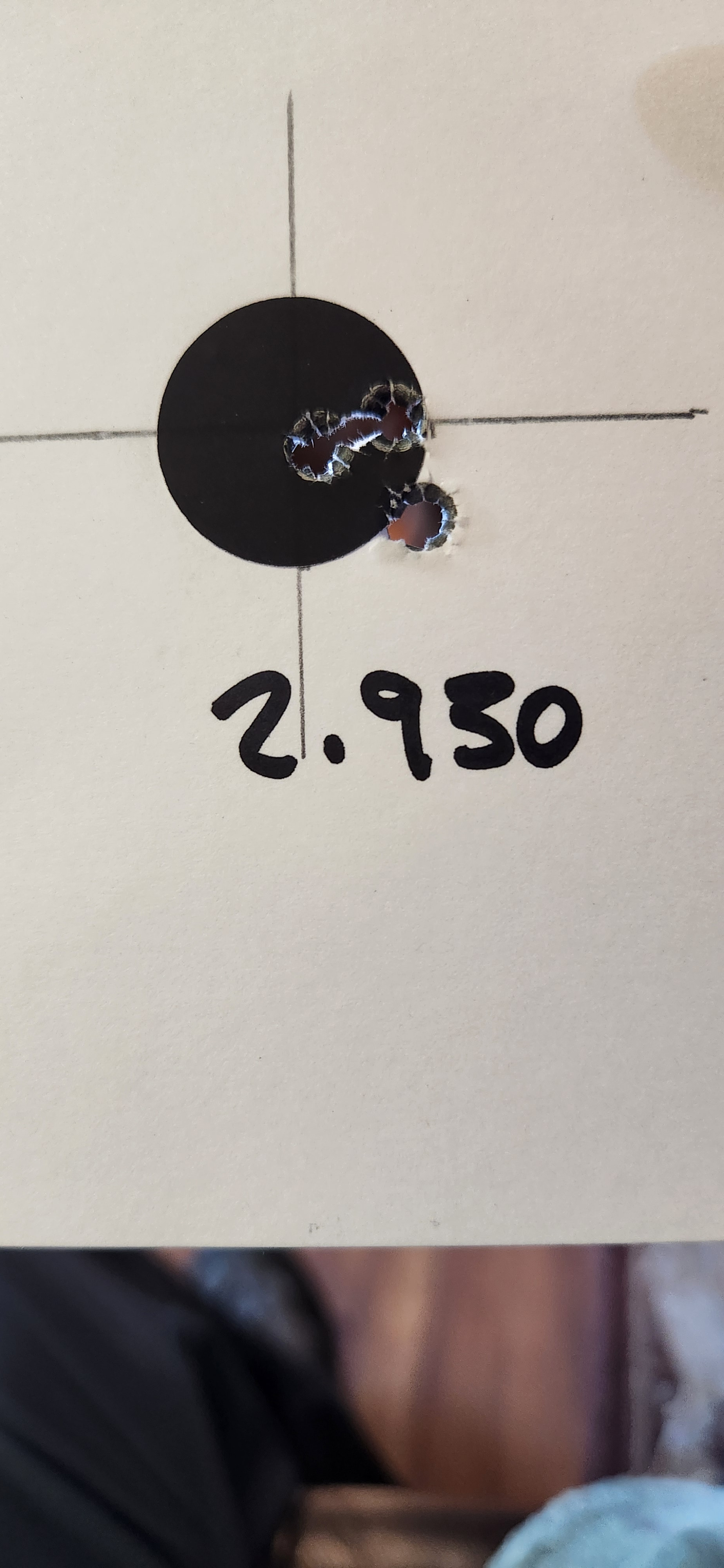

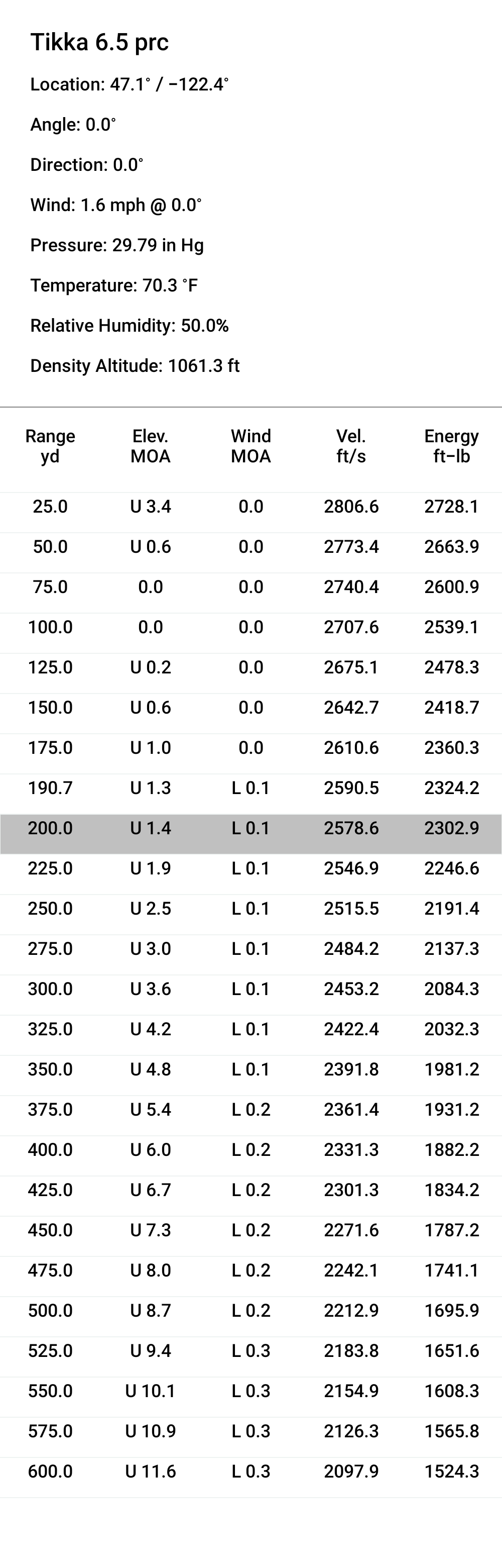

Im reloading 156 EOL for my Tikka Superlite 6.5prc. Getting great groups only 1 photo of a 3 shot group. 58.6g N565 powder.
