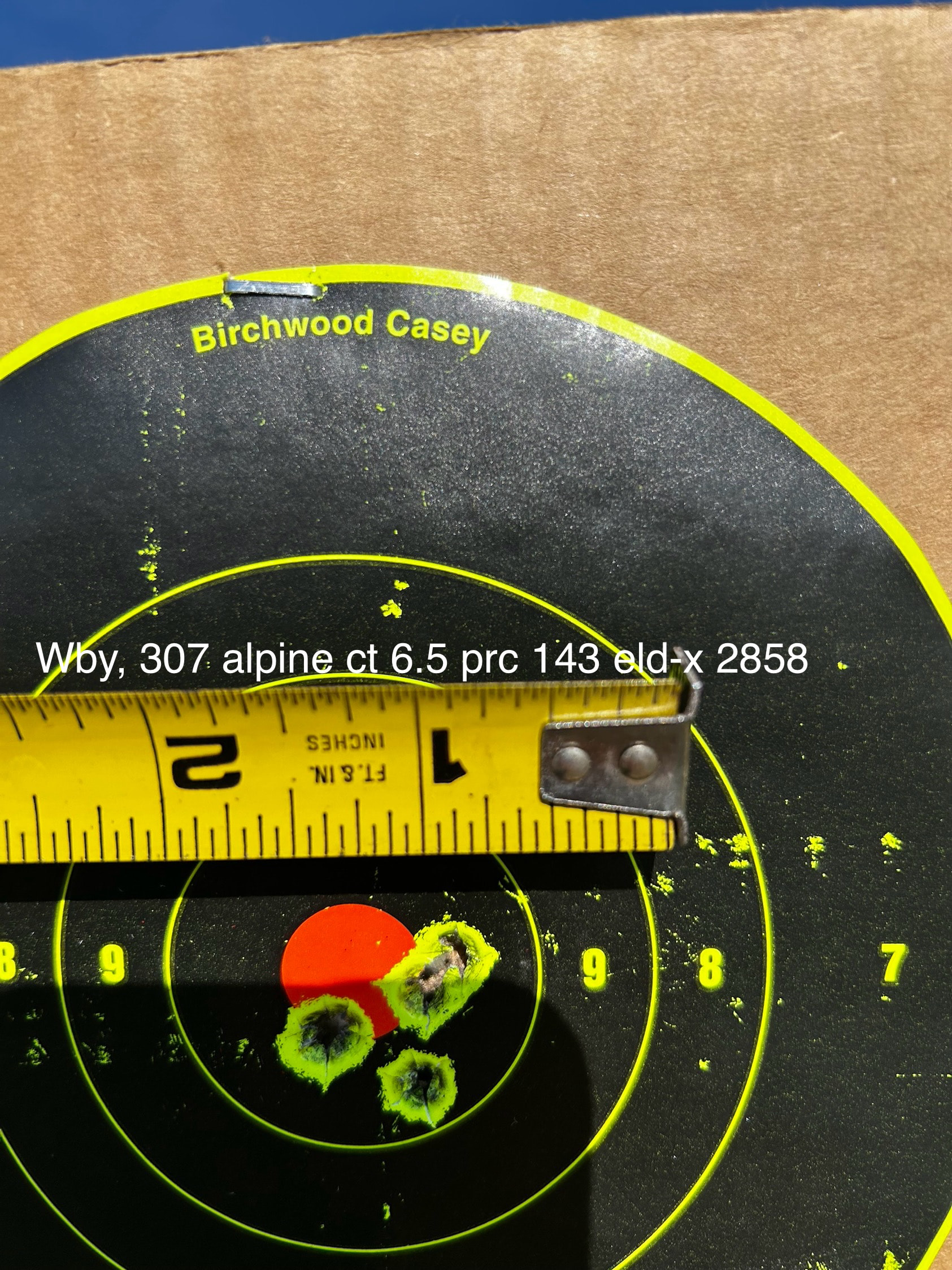

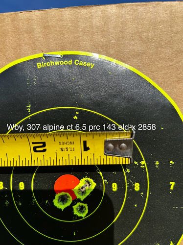

Holy crap I was reading your 6.5 prc info and thought that Hornady MV looks very similar, so I looked up my info I that’s what my range raft came up with too for average fps- 2858. Except I’m averaging a 5 shot-5/8” group with my 24” Weatherby with a carbon fiber BSF barrel on the 307 alpine ct.- we must have the extract same lot # ammo
