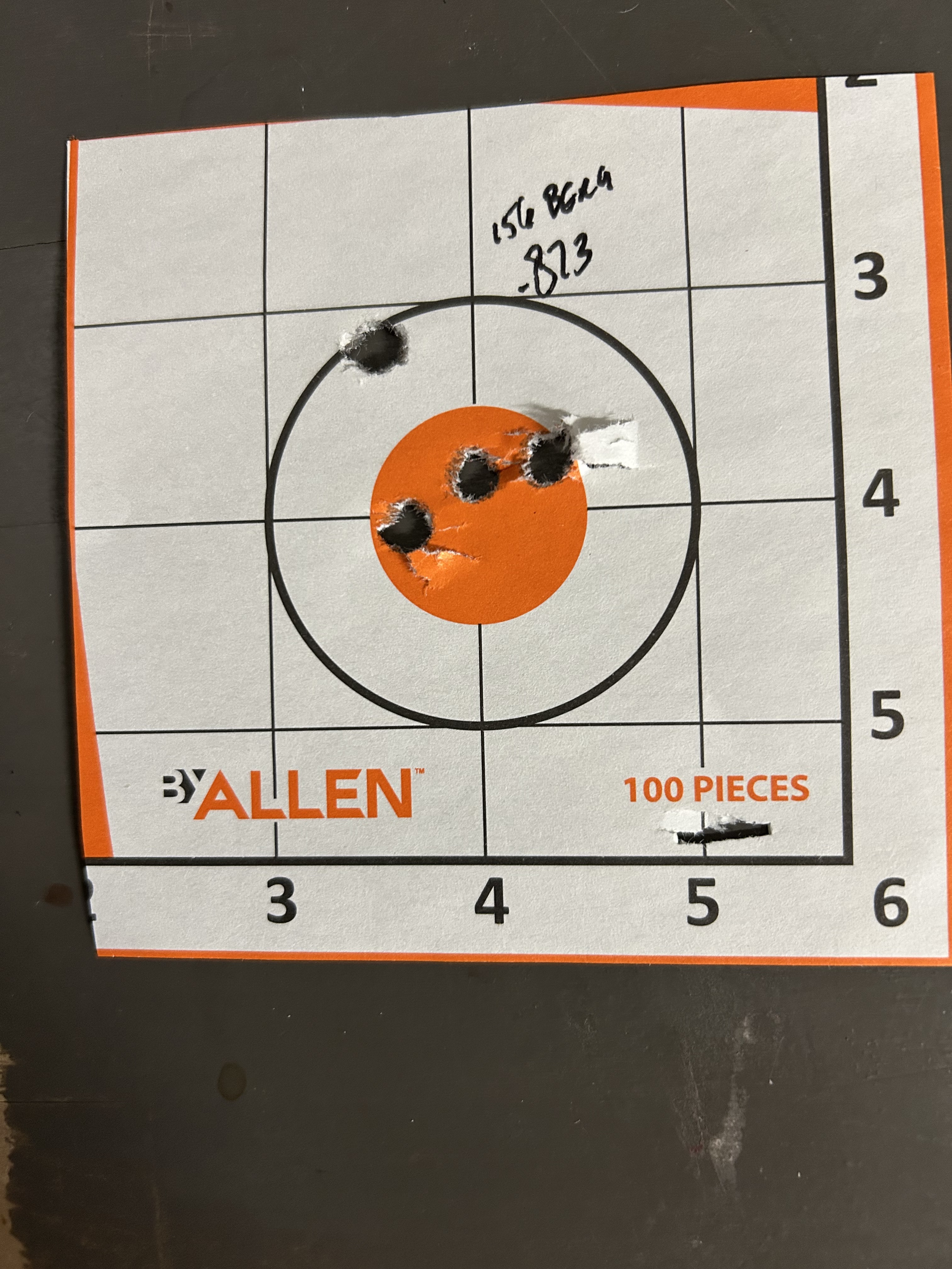

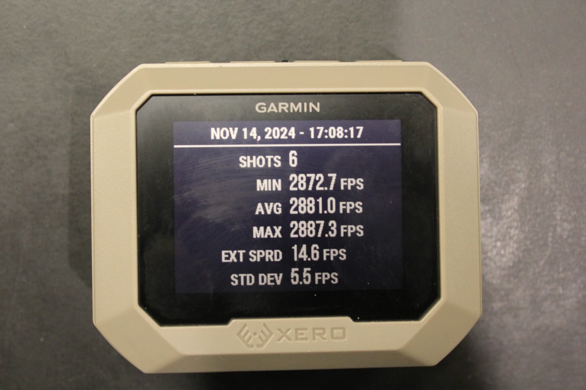

I’ve tried various powders for my 6.5 PRC and many work well, but I’ve had very good success with the Winchester Staball. Here is my load development for it.
Berger Ball: Berger Elite Hunter 140 gr. (.606) 58.8 Gr. of StaBall, Lapua Brass, Federal 210GM (though I’ve tried the CCI and had good luck), Case Trim 2.020, COAL 2.935 (Max Length 2.955) Ogive 2.36 (estimated velocity = 2860 fps)

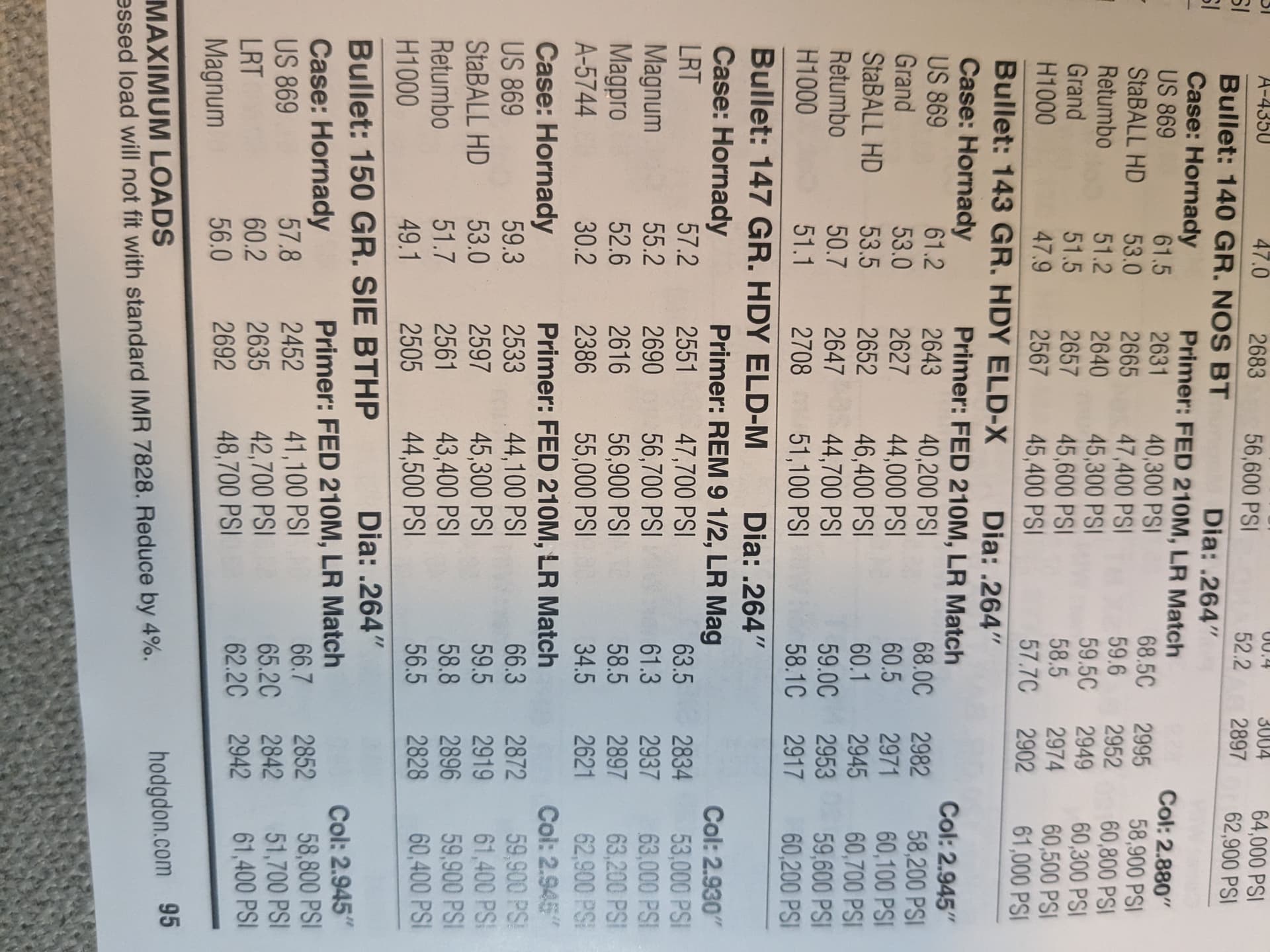

Hey Austin I have the same 2020 waypoint in 6.5 PRC. This is the load I worked up for it. 143 ELD-X , Hornady brass, primer fed no.210 large rifle,59.8 grns Staball HD ,Col. 2.950", avg. MV 2960 fps ,SD always single digit, ES always under 20. Consistently sub moa in my rifle. Hope this helps you some. Photo is from the Hodgon '24 reloading manual

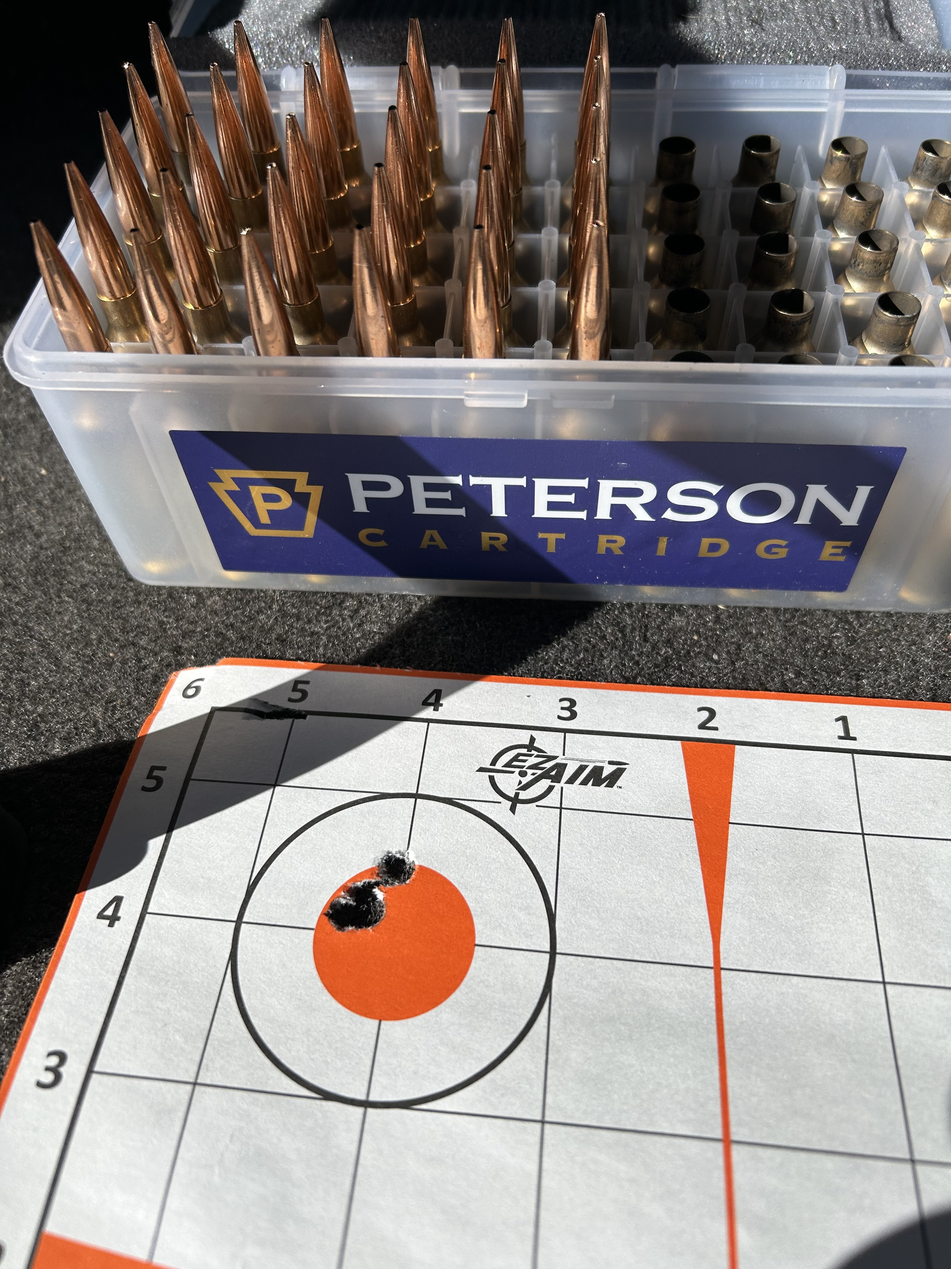

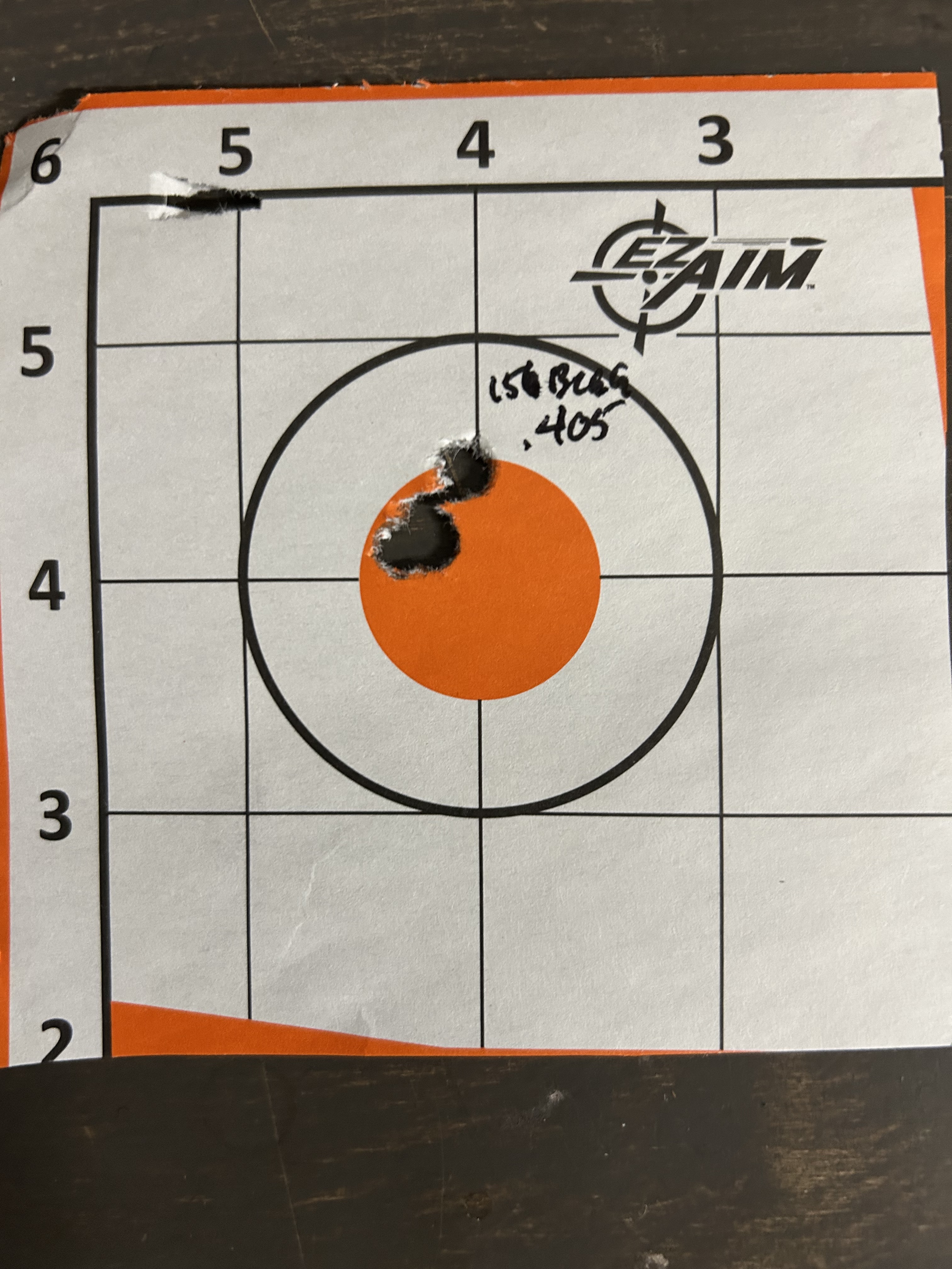

Just got out with 6.5 PRC for the first time today.
Those are 156 Berger Elite Hunters loaded up with 58 grains of Win Staball HD. COAL of 3.030. Pretty happy with the results especially since those were shots 12-20 out of a brand new rifle.
