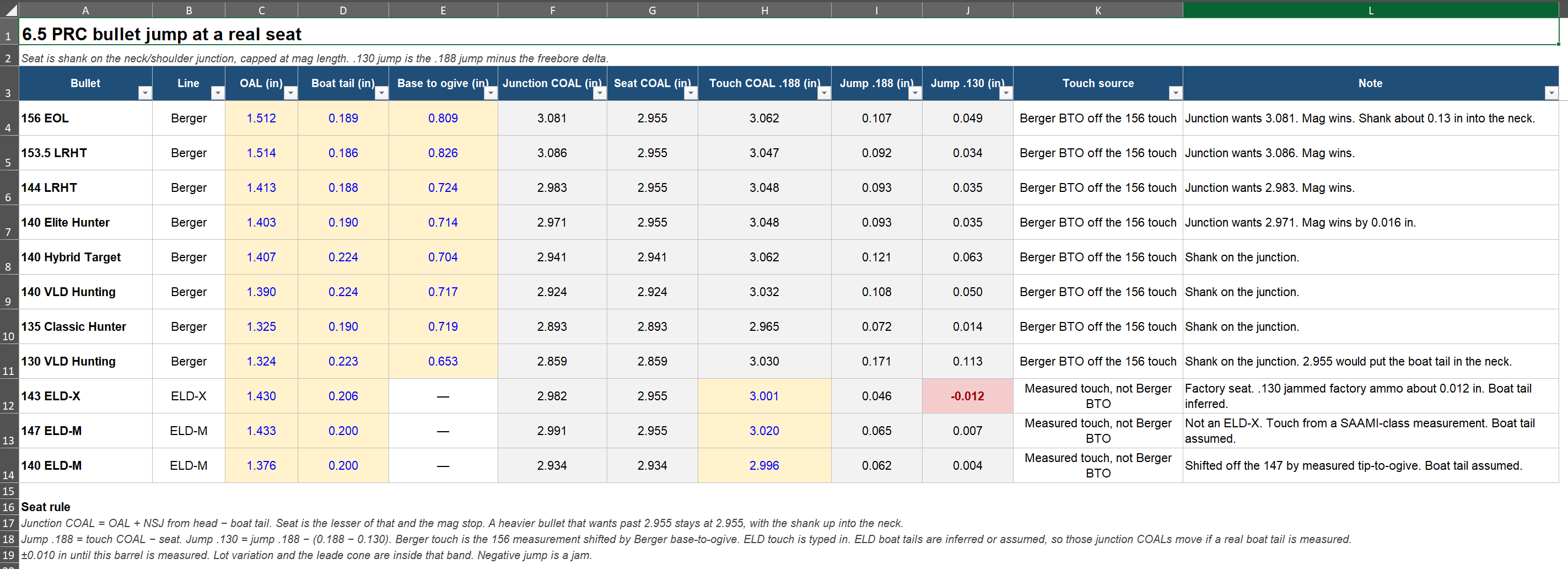

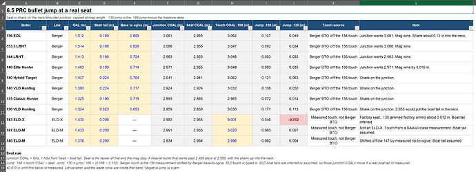

Max magazine length for a short action, and high-BC bullets (Burger 156) pose an interesting problem: You really can’t adjust jump by changing the seating depth - you’re already about as deep as you want to be (shank is partially below the junction, and you’re eating into case volume) and deeper will almost surely run into powder compression. The Max COAL is 2.955 for metal AICS mags with no binder - that leaves (usually about .005 clearance, which is next to nothing). So you can’t seat out to reduce jump.
At that COAL, the jump for a SAAMI chamber is between .100 and .115 (yeah, that’s a long jump), and as the barrel erodes, it doesn’t get shorter. To my knowledge (still quite limited) - the JGS AW2 reamer has the SAAMI throat (.188) and the .535 base - and BPM can supply a SAAMI base, with the shorter .130 throat.
Why a shorter throat than SAAMI? to get the jump into the range Burger recommends - they would like you to start at .015 and increment in steps of .015 - and hopefully land somewhere around .030 and .060 - which isn’t possible with the 156EOL while still having the shank in the neck (more or less) - If you load to 2.955 COAL you’re jump is about .107 (average)
There is a note on the BMP reamer: handloads only, which seems to be based on the factory COAL, not the best seating depth for the lighter bullets. (calculated jump table based on chamber and bullet specs) Since and ELD-X seated to 2.955 puts the ogive very close to the lands (different shape than the Burger hybrids)
I had Grok run this up based on the two “standard” reamers I could find and the SAAMI specs and the published specs of the bullets. This is a small .xls spreadsheet with calculated jumps based on specs for the two reamers.
So - it’s clear that there is no way to seat the bullet out on any bullet where the junction is already longer than the Magazine COAL. And if you’re getting a 0.107 jump on the 156, you have no way to make that shorter (without hand feeding - and I haven’t looked at any of those numbers). If you want less jump, you cut a shorter-than-SAAMI throat.

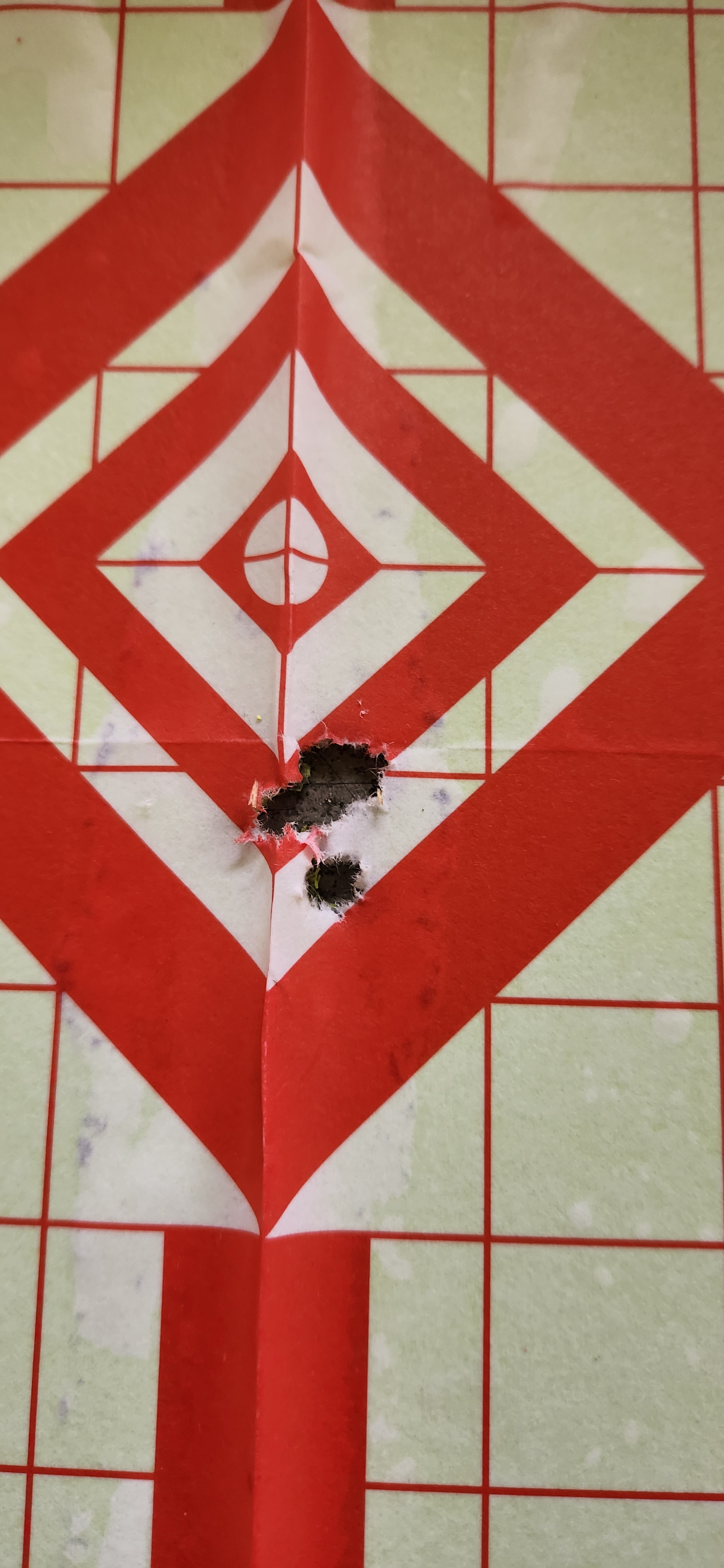

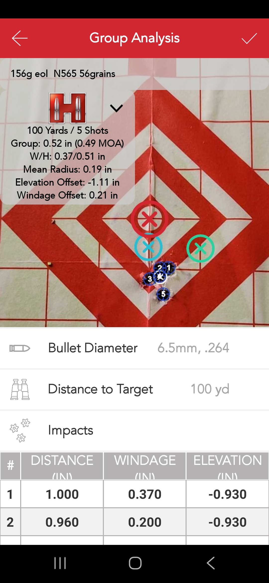

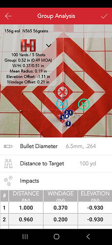

I get good results with Berger 156g EOL 56g N565 coal 2.930. I have the EC dies the FL die takes care of clickers. CVA Cascade XT ive put almost 1000 rounds through it no loss of accuracy.
