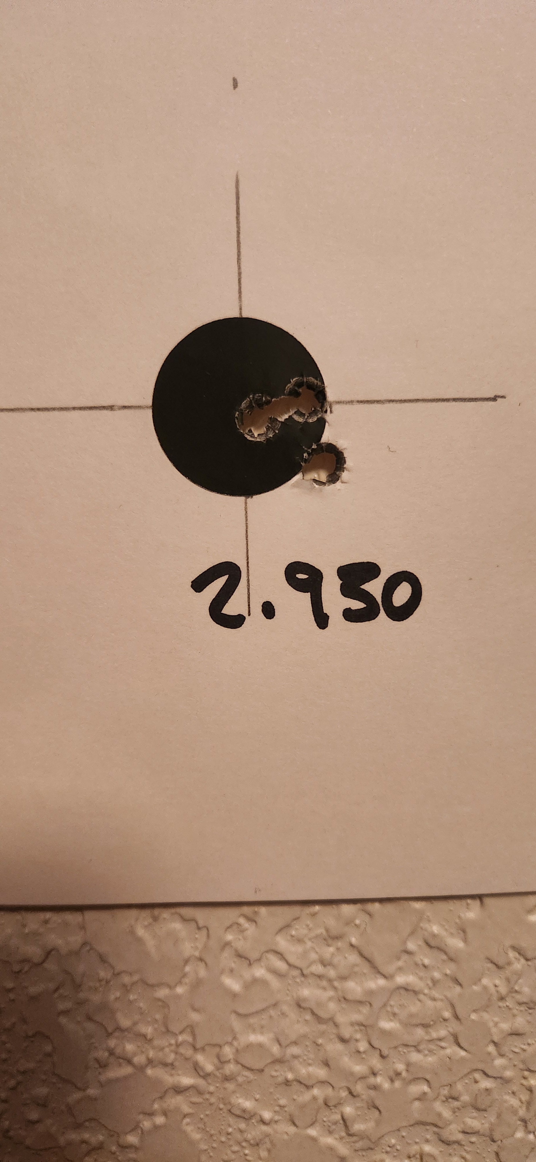

I had an accurate load with 156g berger eol and n565 but 3.2 graines over max concerned me so i pulled bullets on 70 rounds and back to powder charge test.
Grouped pretty good hope ill find a similar node at safe charge weight.

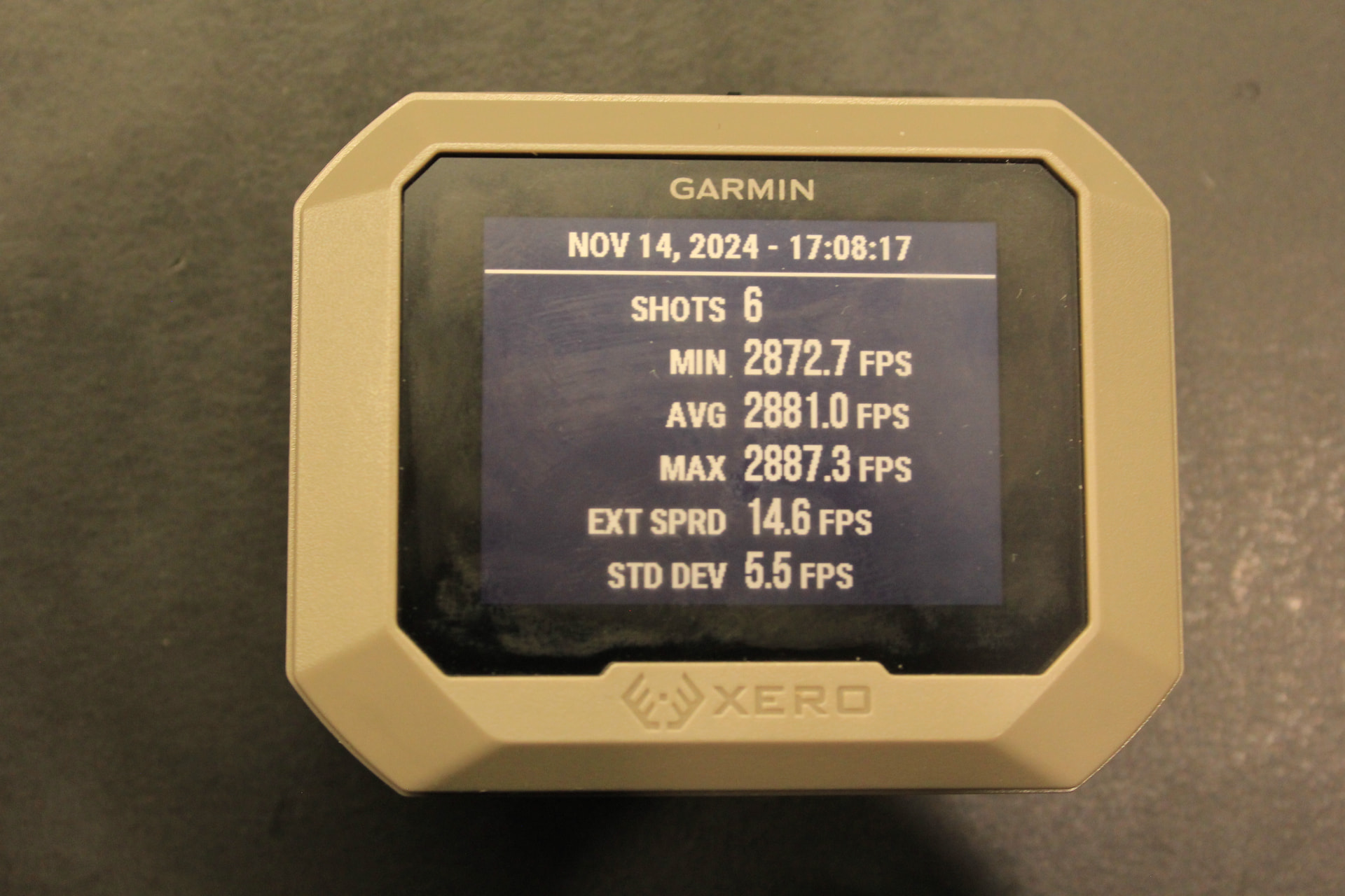

I have a decent 6.5prc reload.

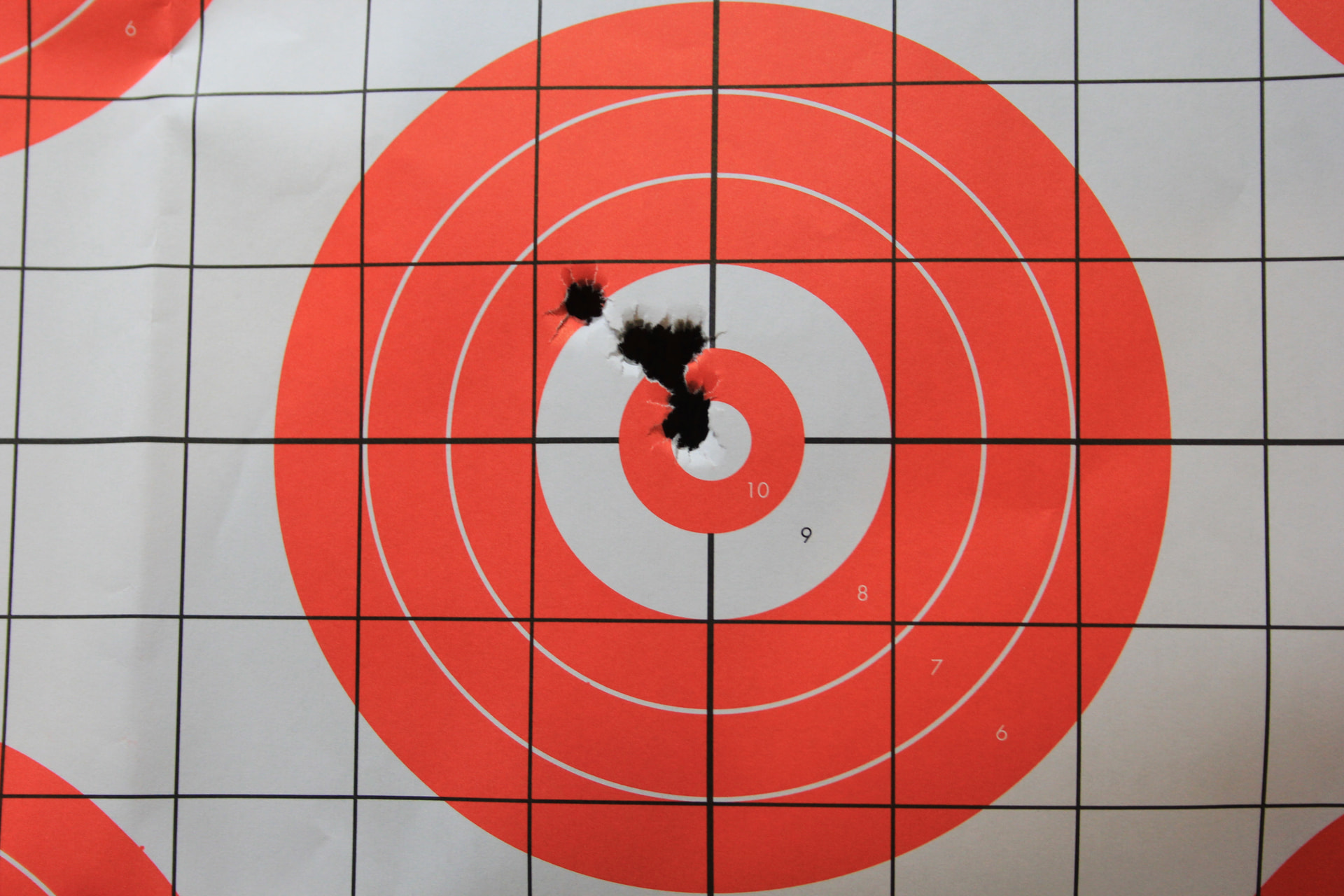

The flyer was due to premature discharge. The Seekins Havak Slam’s trigger was a little under 2 pounds. I dialed it up a bit.
Thanks for sharing Robert. This looks like a great starting point. I have some H1000 and ELD-X sitting around. Ill give it a try.
Someone else tried this dope and got the same results. Btw I used Lapua new brass
