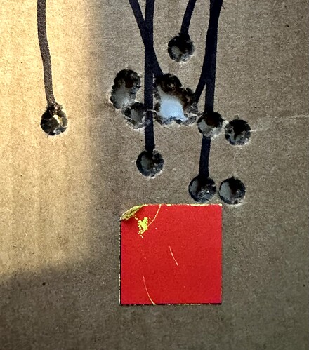

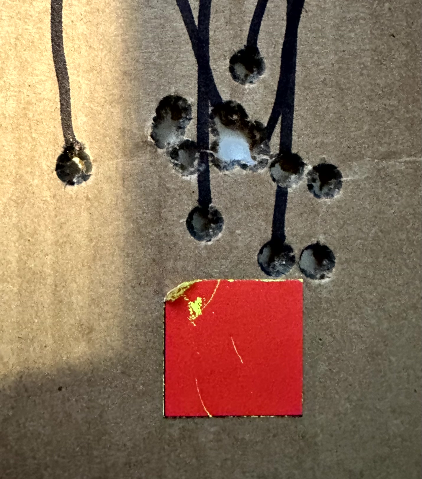

In regards to your other question. Yes, you can absolutely shoot great groups with Winchester brass. Just to give you an idea, last weekend I was trying out a new bullet/powder combo and shot a 15-shot pressure test that spanned 9 grains of powder with these results. Just be consistent with your case prep and you’ll be happy.
