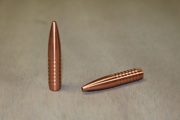

I live in California, so we are restricted to lead free projectiles for hunting. Eventually I do plan on moving out of state, but for various reasons, right now, I am rather tied here. Barnes has a 150 grain TSX. Two questions. Because of the excellent weight retention in the mono-metal projectiles is it correct to think the 150 grain TSX will perform like a heavier lead core projectile. Have you heard about anyone developing a heavier mono-metal projectile in .277?
I haven’t used these yet, but I did just place an order for 50. They are very highly recommended by a lot of hunters over on https://www.longrangehunting.com/
Interesting. Let us know how they do. I am trying to decide between a 6.8 Western and a 300 WSM.
