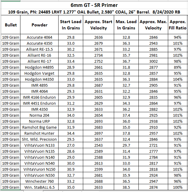

anyone here mess with 6GT and Berger’s 109gr long range hybrid target? Spun up a couple test rounds with my new MPA and got some decent initial results but any additional recommendations / suggestions are helpful. There isn’t much OEM data out yet. i know Hornady dropped their boxed stuff, but i havent seen anything spec wise for it.

I have 2 MPA 6gt. I run 105 begers and Varget. .035 jump is the sweet spot and im running just shy of 2900fps. Try to stay around 2875. Dont worry about trying to develope a load until you get atleast 150 rounds down the barrel. Stick with 32.2 varget until round 150 then start load work

if anyone is interested… Berger just sent me this for the 109’s
