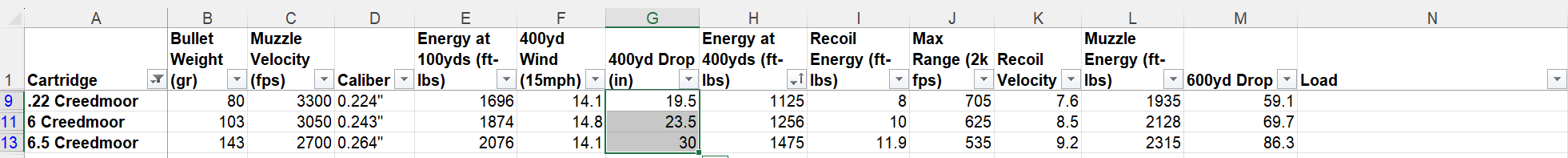

Have you seen Jim’s spreadsheet that you can get from backfire.com/ballistics? He does have the 22 creedmoor on there. Looks like 6 creed only drops about 4" more than the 22 @ 400 yd, and about 10" difference at 600. I might wait until shot show, hopefully some more manufacturers will announce offerings for these. Choices right now are limited even for the 6mm which has been around a couple years already (of course, not as limited as the 22 creed which is brand new and pretty much only made by Horizon from what I can see).

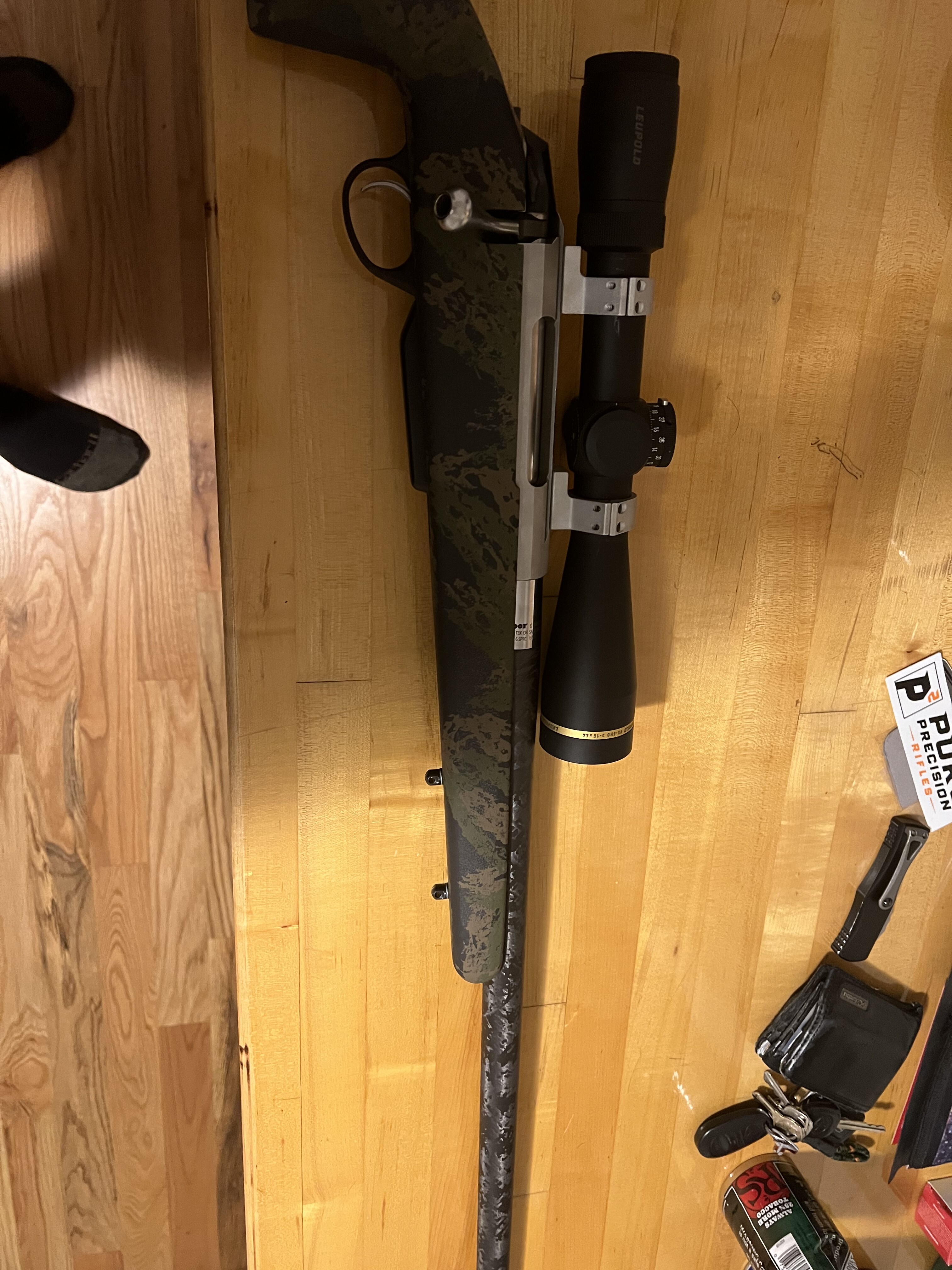

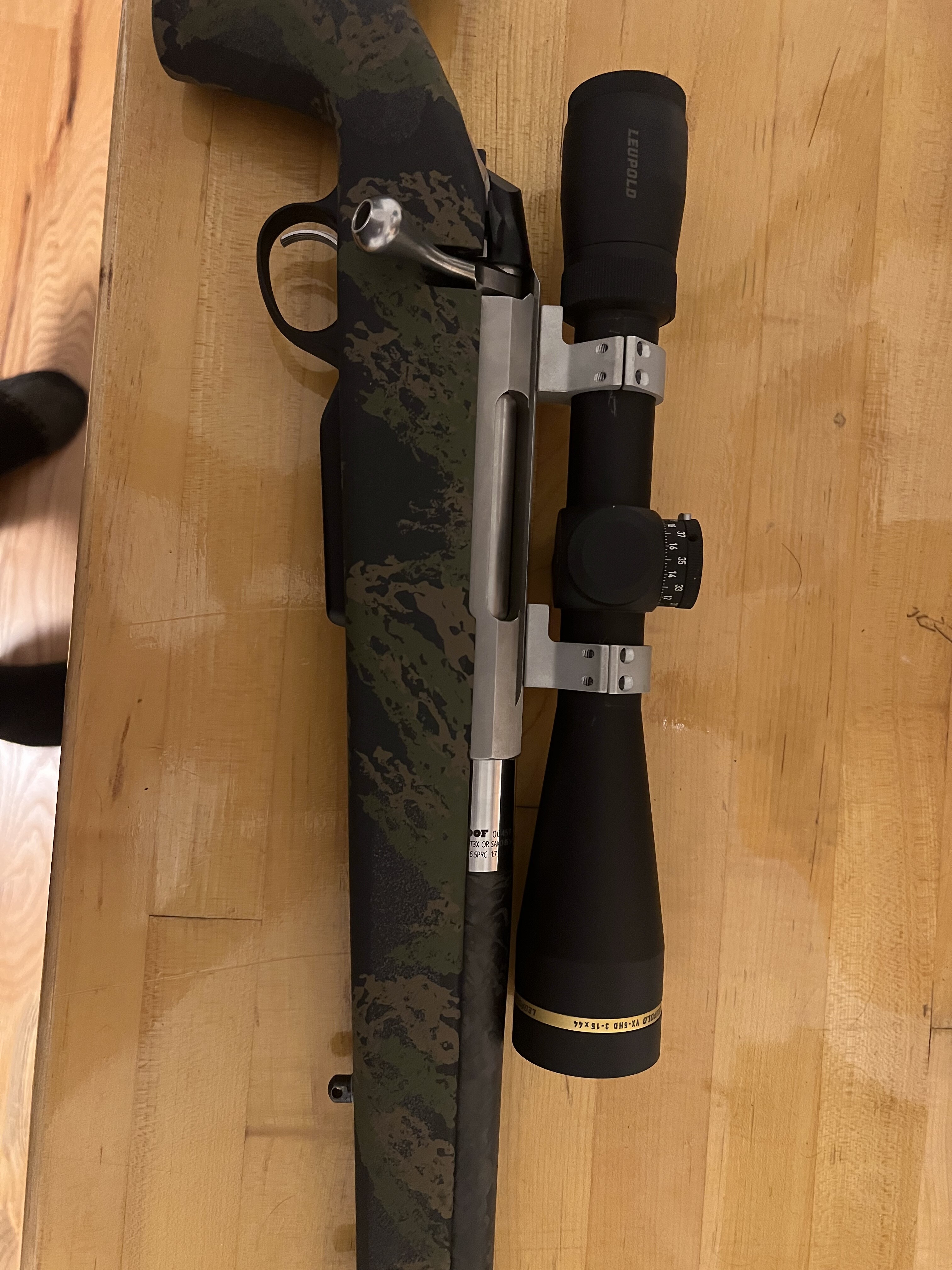

This is 6.5 prc that I just got through building on a tikka action.
Nice… if you don’t mind my asking…
Looks like a proof research barrel–and the stock is from?
Total build dollar amount?
Total build weight (w/o optic)?
Aside from stock and barrel, did you have to get a new bolt or bolt face for 6.5 PRC? What other components are necessary (I have one Tikka now that I could repurpose but not sure what all is involved yet).
Yes it was a proof prefit barrel and the stock is a mess precision I already had the rifle so my total cost was around $1700 if you don’t have an action to build on go ahead and figure another $750. The rifle was chambered in 270 wsm so no I did not have to change the bolt I did have to buy another magazine but that’s no big deal. You will need a barrel vise, tikka action wrench, a torque wrench, and so go-no go headspace gauges. Also to take the factory barrel off you will need a external action wrench and possible a cheater bar. All in all once the barrel and stock came in it took about 5 minutes to take the only gun apart and put the new one together.
