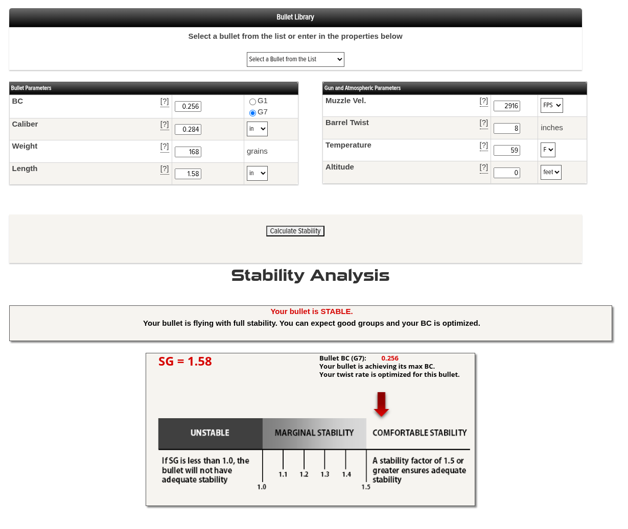

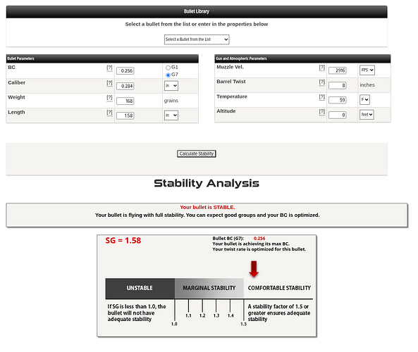

This bullet requires an eight twist. It works perfectly beautifully in my 7prc. I actually tried it with a Bergara 28Nos with a 1:9 twist and saw similar results to what I saw today.
I had a few more of the 175s lying around and shot two groups with them. One was 0.9 and the other was 0.6 moa. So at least in the same general ballpark of what I was seeing last week with them.
Came home and did a Quick test with a cleaning rod, tape measure, and a paint marker and I got that this was a slightly faster than 1:8, almost certainly within the error of measurement of This crude technique. It’s kind of difficult to do this with such a short barrel.
I always thought keyholing was due to an inappropriate twist rate. Is there something that can be wrong with the ammo that would lead to that instead?

Doesn’t seem to be a twist rate issue
Yeah my PRC loves them at 2860 with a 22 in barrel.
So what’s different? Barrel is shorter, velocity is higher, pressure is significantly higher.
Higher pressure at the muzzle might be destabilizing the bullet on its way out, especially with incomplete burnout is the only thought I have. Maybe try another box/lot of the same bullets to make sure you didn’t get a bad batch.

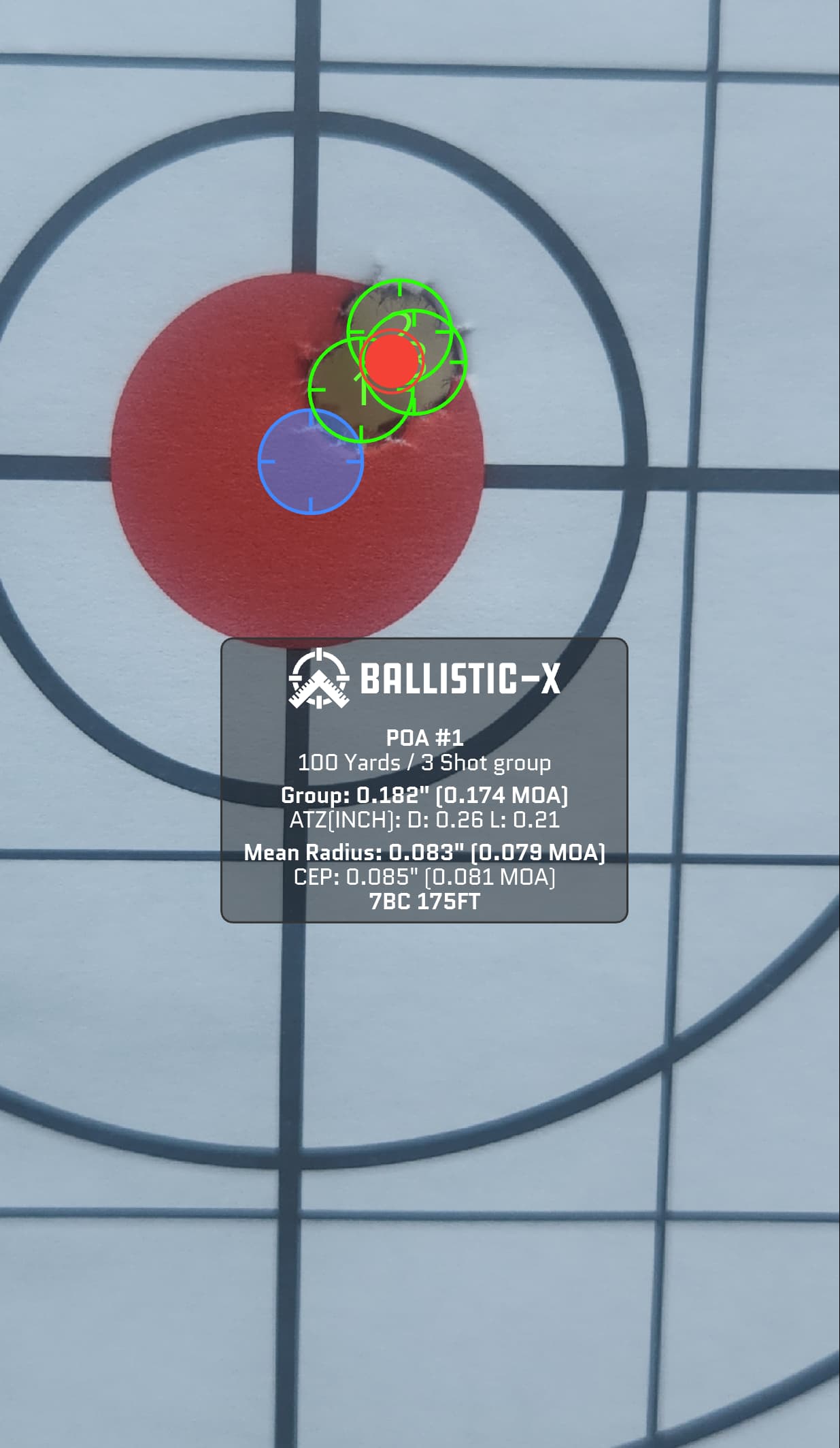

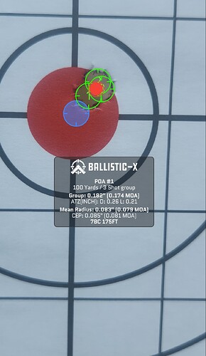

Update #3/Range Day #4
I needed to do some testing with another rifle today and decided to take the backcountry out and shoot it some while I was waiting for the other rifle to cool in between groups.
First thing I did was shoot a three shot group on a cold barrel of the tipped Fusion just to see if there might have been some major change in how the rifle was performing.
A 0.174 MOA group!
