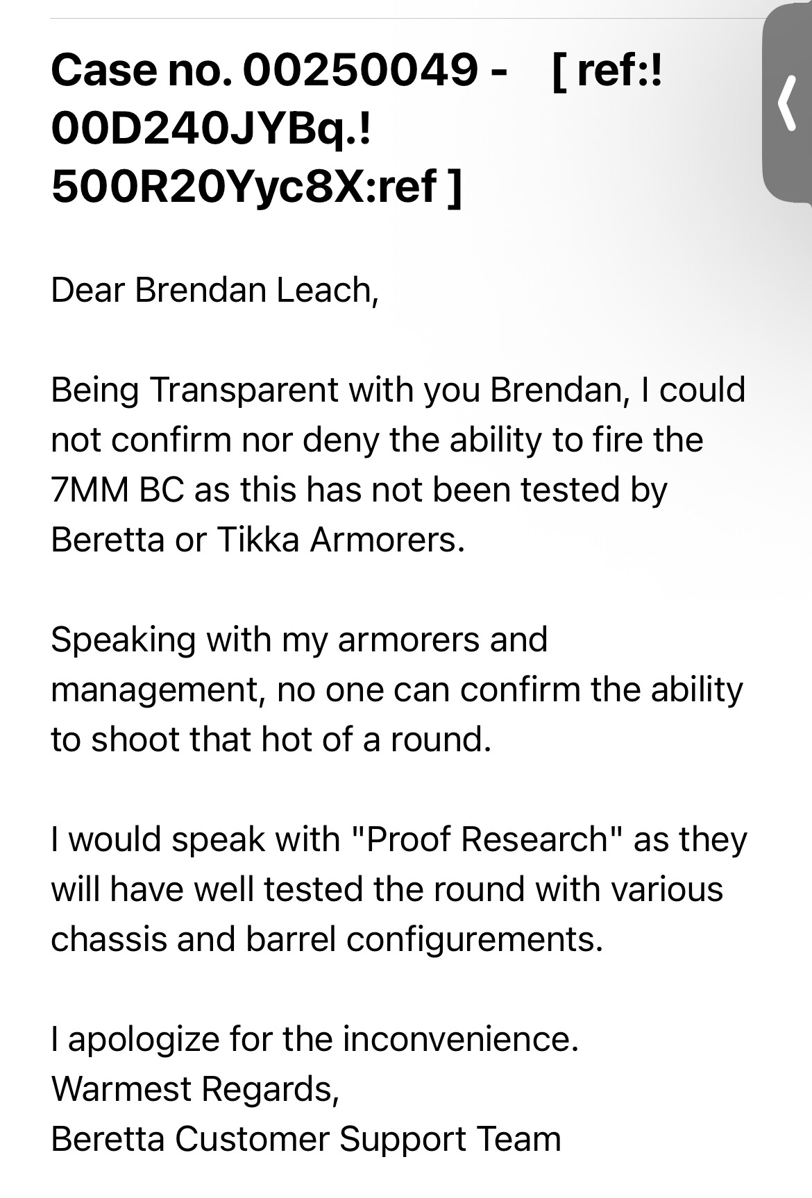

I reached out to both tikka and proof to see if their action can handle the excessive pressures associated with 7 BC. Haven’t heard back yet. But I figure since proof is offering 7 BC prefits for tikka they either have a guarantee from tikka or have done their own in house testing. The only info I could find says tikka test their actions 120-130% over pressure. Their highest pressure cartridge I believe is 65000 psi which means theoretically they test up to 85000 psi which seems to be cutting it close to 80000 psi of the 7 bc. Having handled their actions, they seem hard and dense compared to other actions so I can’t imagine they wouldn’t be able to handle the excess pressures but it just seems too cowboy to assume they can tolerate it without any assurances. Anyone slap a proof 7 bc barrel on a tikka yet?

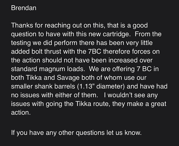

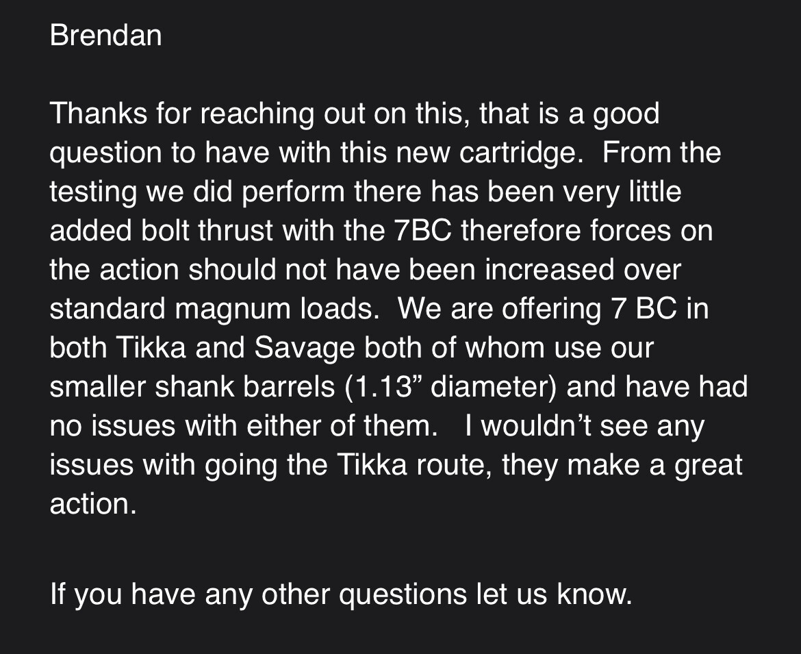

Proof’s response
Cool.

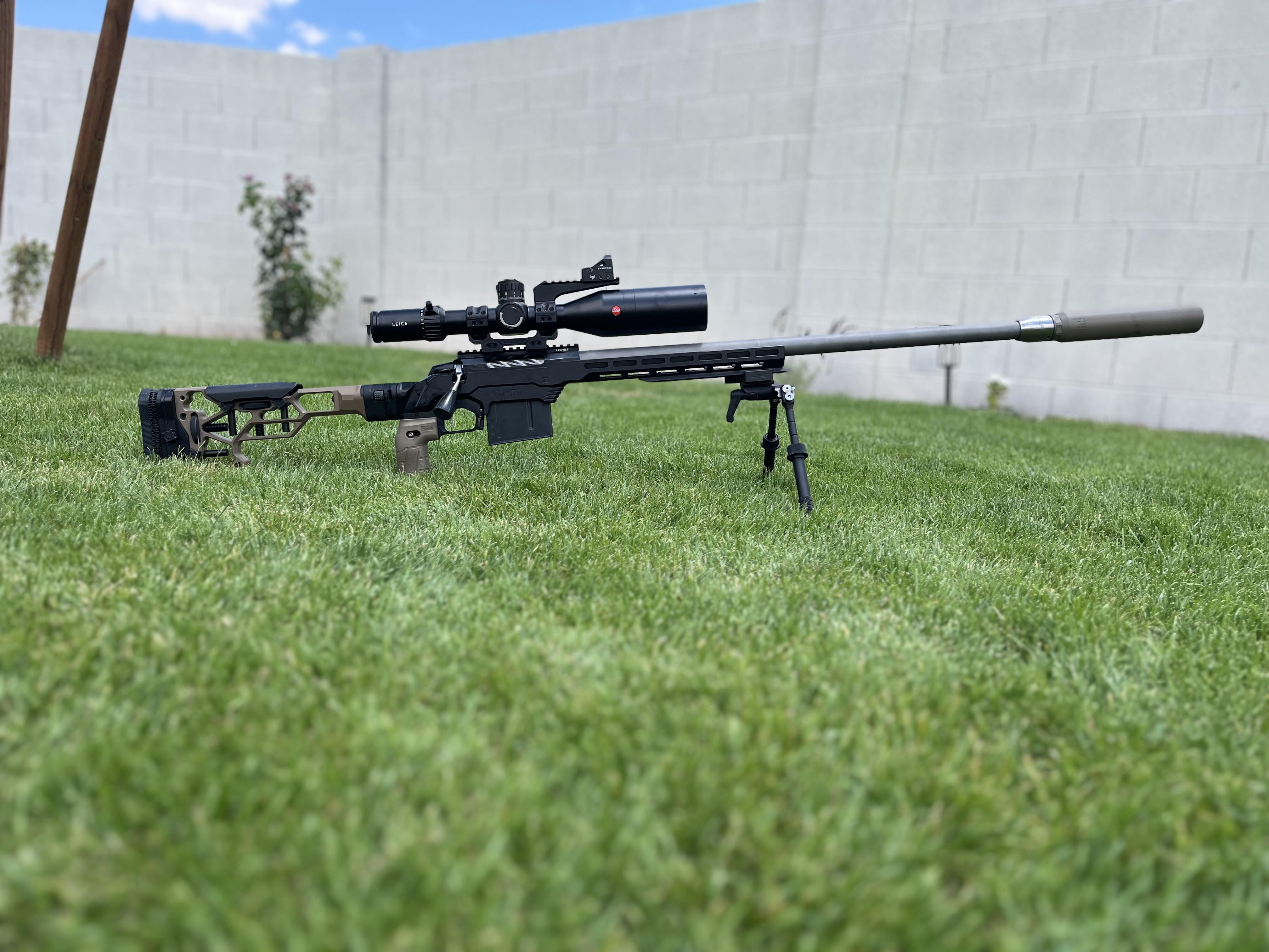

It’s a tikka action with a 28” mcgowen barrel in an mdt chassis. Lot of fun to shoot out to 1000.

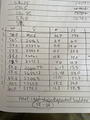

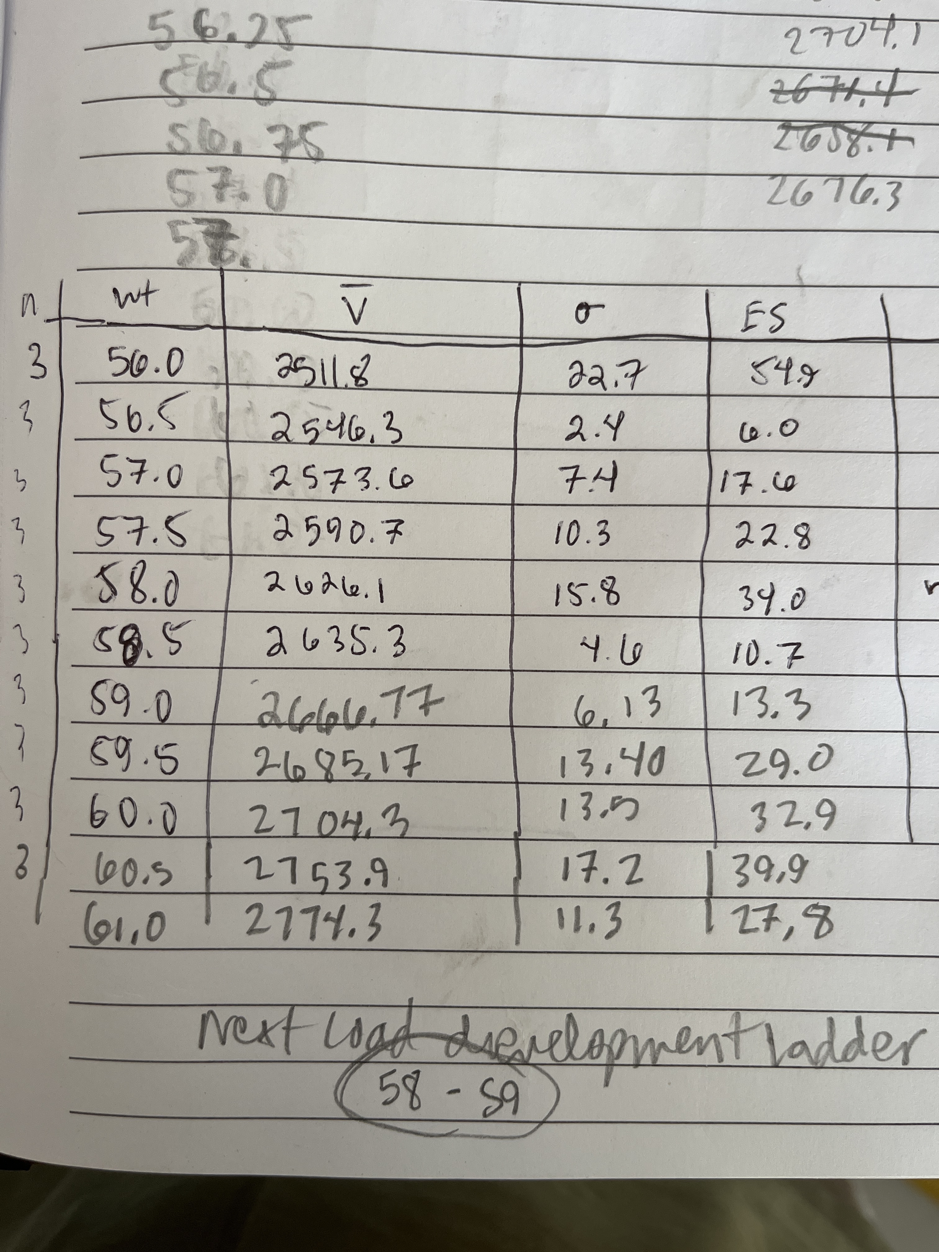

It was about 95 degrees when I got those velocities down here in AZ, so assuming it’ll be cooler for a fall/winter time hunt, I’ll probably lose some velocity. That was the top of my ladder and there was some slight flattening of the primer but no heavy bolt lift, ejector mark or anything else to suggest over pressure. My SDs were a little better at around 58.5 to 59.0 gr so I might back off a bit, which would put me at the mid 2600s which is still pretty good for a 20” barrel slinging 175 grains.
The load that got me 2770 is 175 eld-x
N560 61.0 gr
CCI 200 large rifle primers
ADG brass

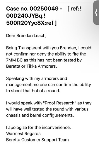

I asked an executive at Sako/Tikka about the action and he said they haven’t fully developed everything for high pressure but he thinks it’ll work.
Good to hear! This inspires confidence that I won’t blow up an action in my face. That 20” proof 7 BC tikka prefit is looking mighty tempting.

I love the use of the Glomar response :joy:
I bet they ran that by their lawyer before responding
