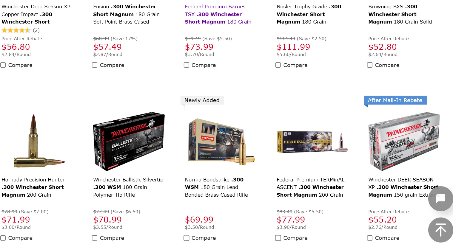

Maybe extinct is too harsh, but before I ordered my action I checked availability of commercial ammunition (Cabelas, Midway, Ammoseek)- none was available except from small reloading companies at over $100 a box. I don’t hand load so I went with a different cartridge.
On the commercial ammo side, I’ve found it’s hit or miss with 300 WSM. It is sometimes hard to find at the big box stores, but I have found it out there. I have usually had better luck online. Right now, for some reason, optics planet has 38 loads in stock and some at a more reasonable price point. For me though, getting into handloading changed the calculus a little. Out of curiosity, what cartridge did you end up with?
