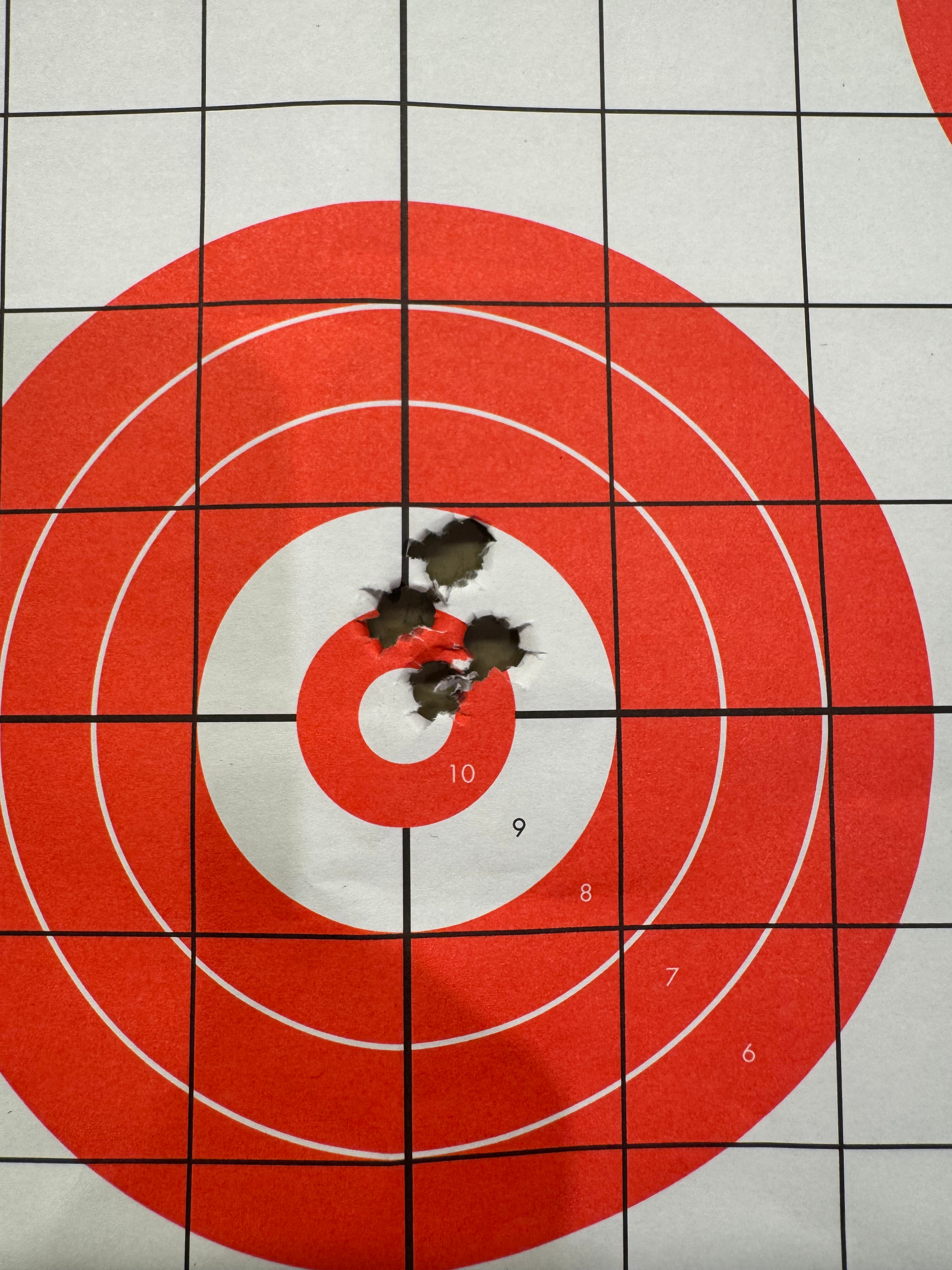

I have a browning xbolt and the first ammo I tried (hornady precision hunter) shot a 3/4 inch 3 shot group at 100 yards.

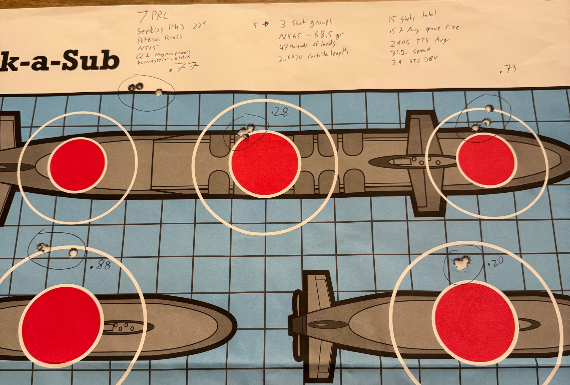

Thanks for sharing. Any info on the components you used for this load? Powder, primer, charge weight, etc…
Peterson brass
175gr eldx
Cci magnum primers
N565 68.5 gr.
47 thousands off lands
~2905 velocity
Iv tested up to 68.9 gr N565 and got up to 2926 avg and groups were similar to the picture above.

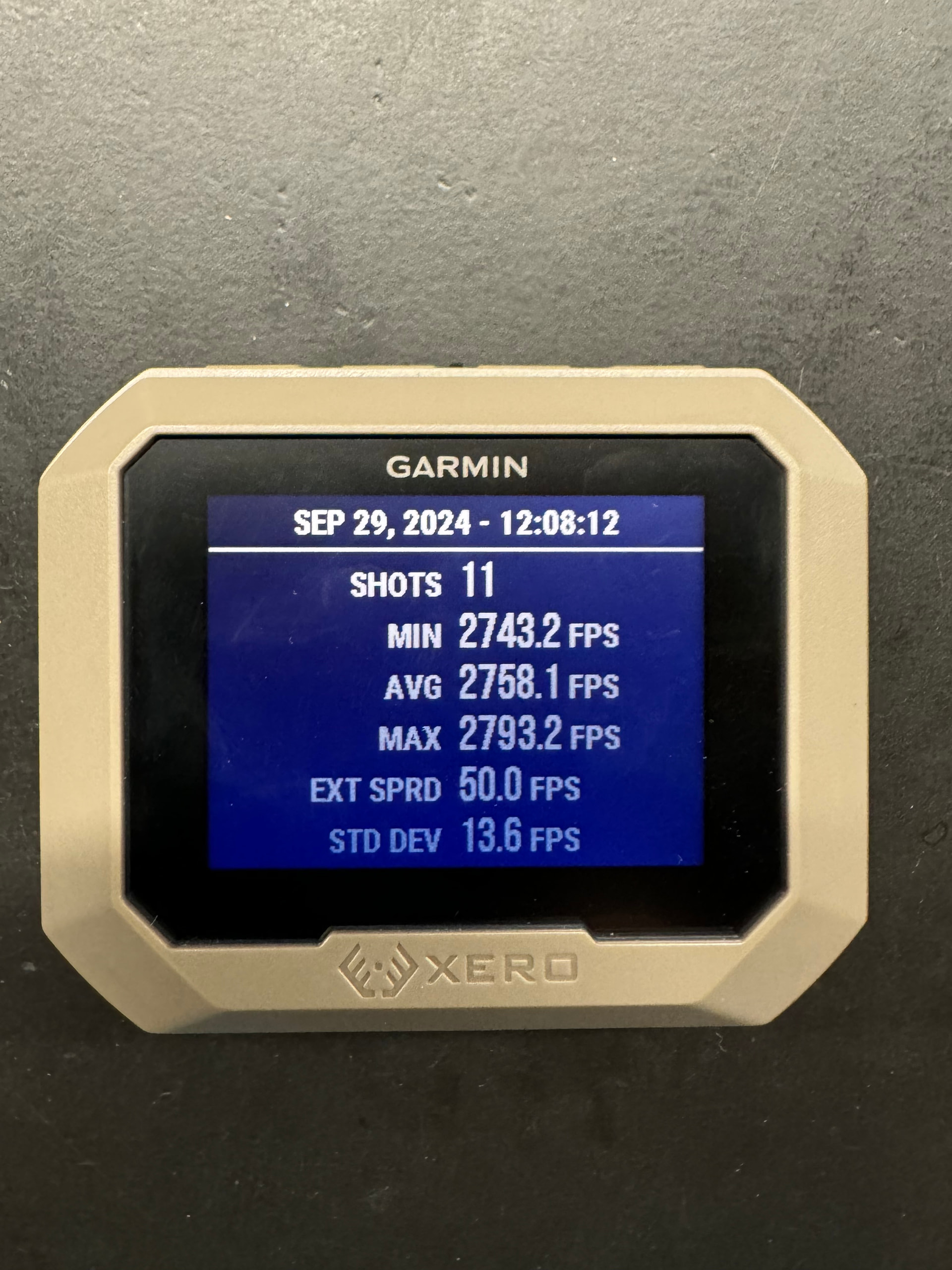

Zero pressure signs at 68.5gr. First loads I did I used hornady/ vhitavouris max load “recommendation” and was in the high 2700/ low 2800s range.

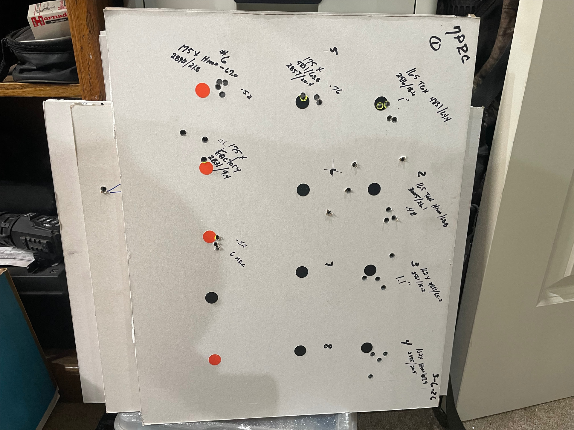

If you can excuse the mess on this target it shows some potential for a couple of powders. H4841 is the most accurate, but H1000 is also a good load. Been playing with Ramshot Grand with lots of promise and getting closer to 3000 fps. I’m having better accuracy with Sierra TGK 165’s. Really i’m moving to the TGK in most of my calibers now. They do excellent job for us in the field and the range.
Thanks for sharing! I actually have some rams hot grand loaded. Just haven’t had time to get to the lease to test!
