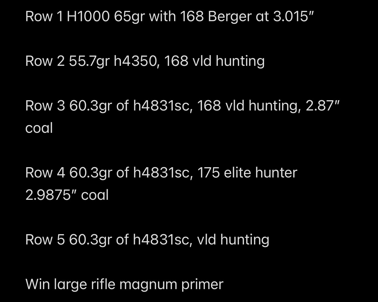

Would love to see some 7 SAUM loads that are working well for you guys. Here’s what I loaded but the velocities are just too slow in my 21” SAUM. Gotta keep working on that one.
