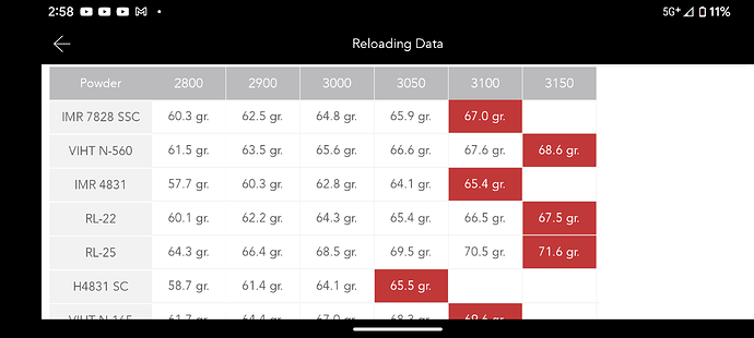

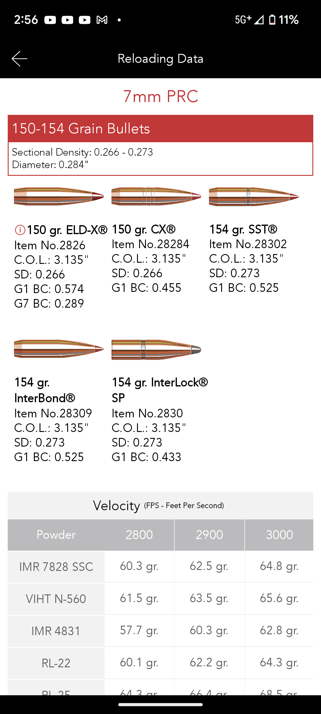

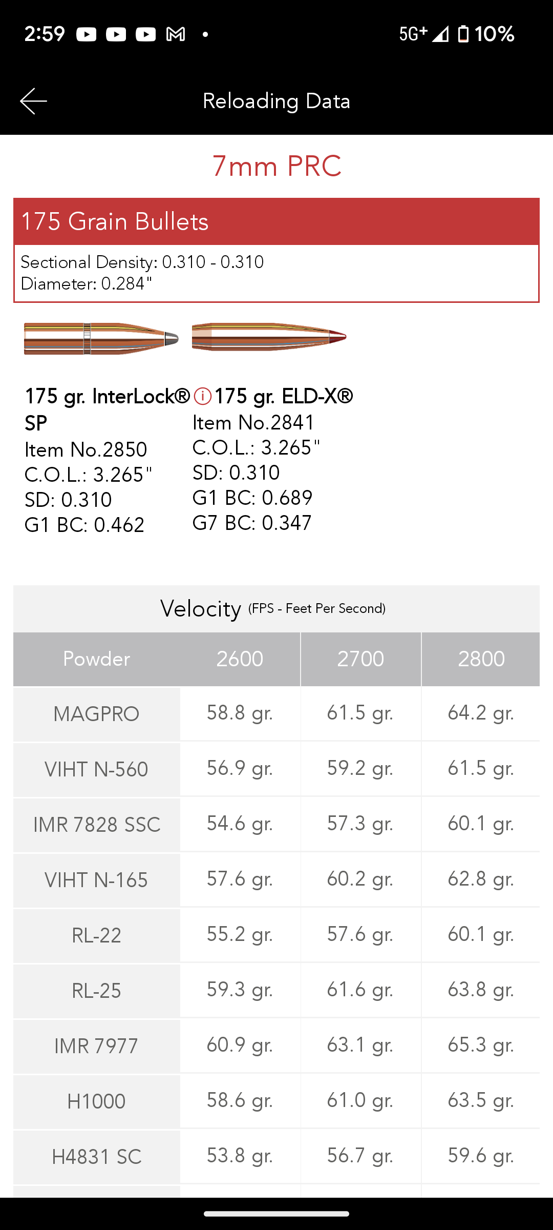

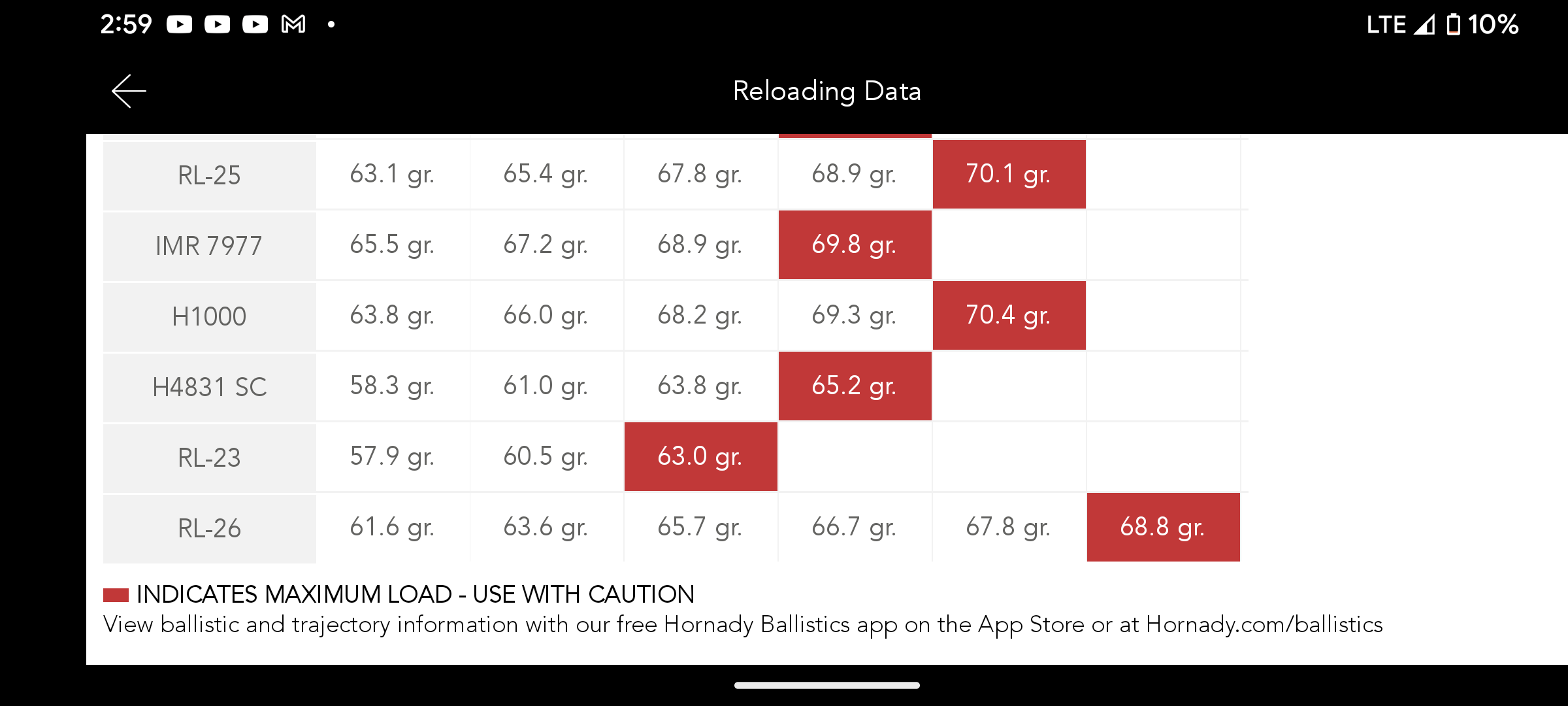

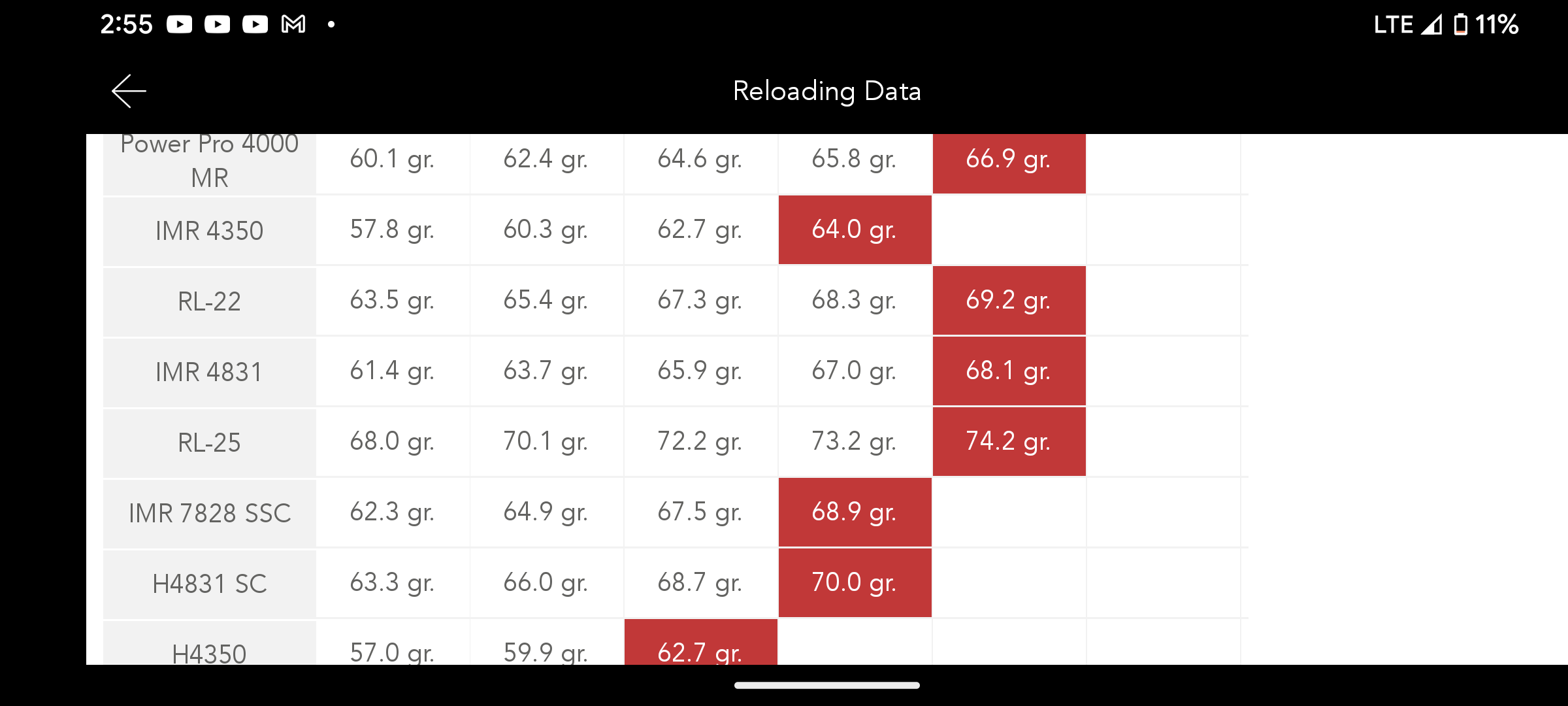

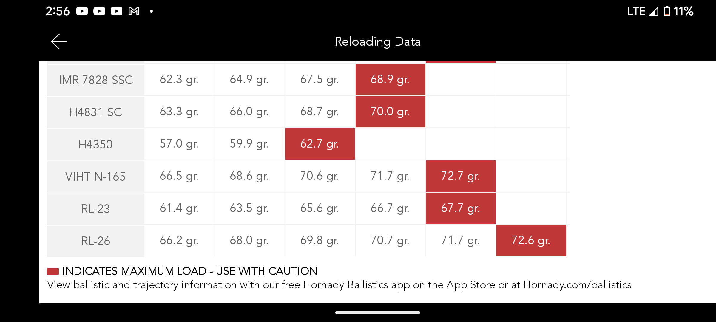

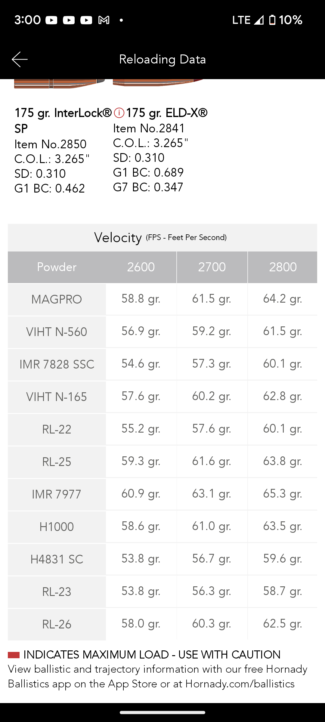

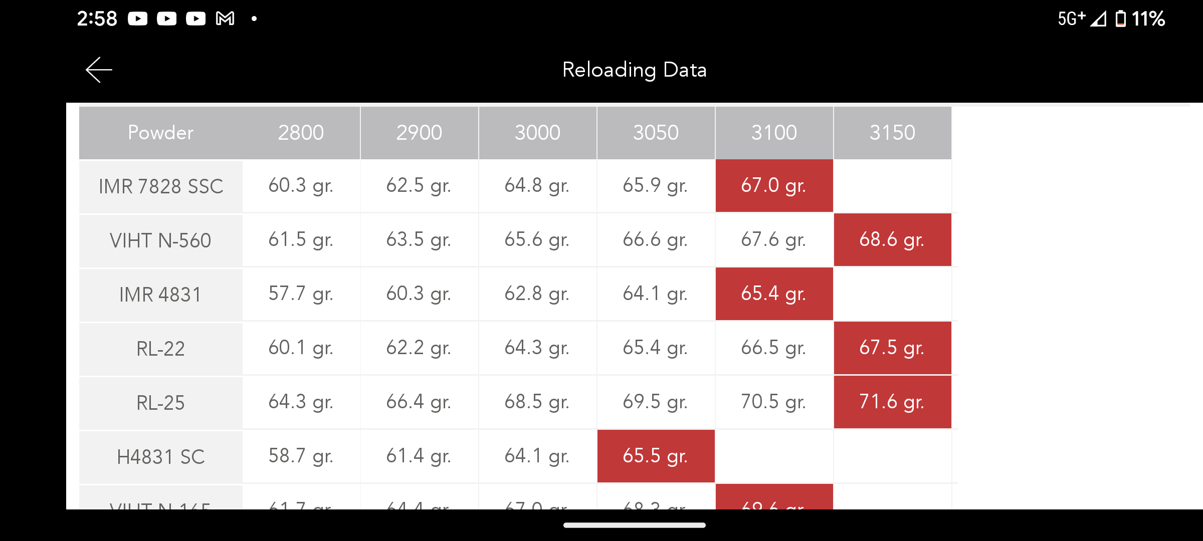

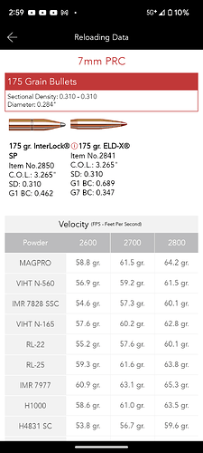

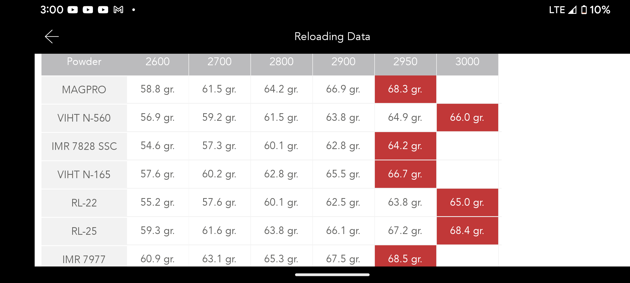

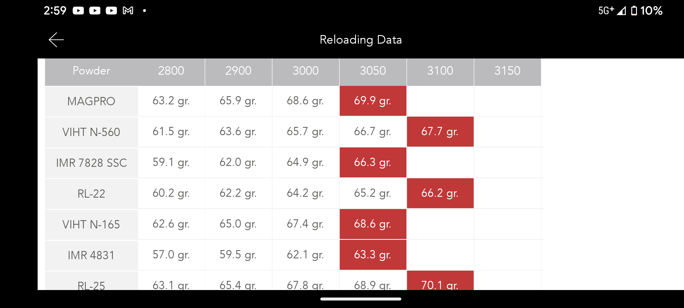

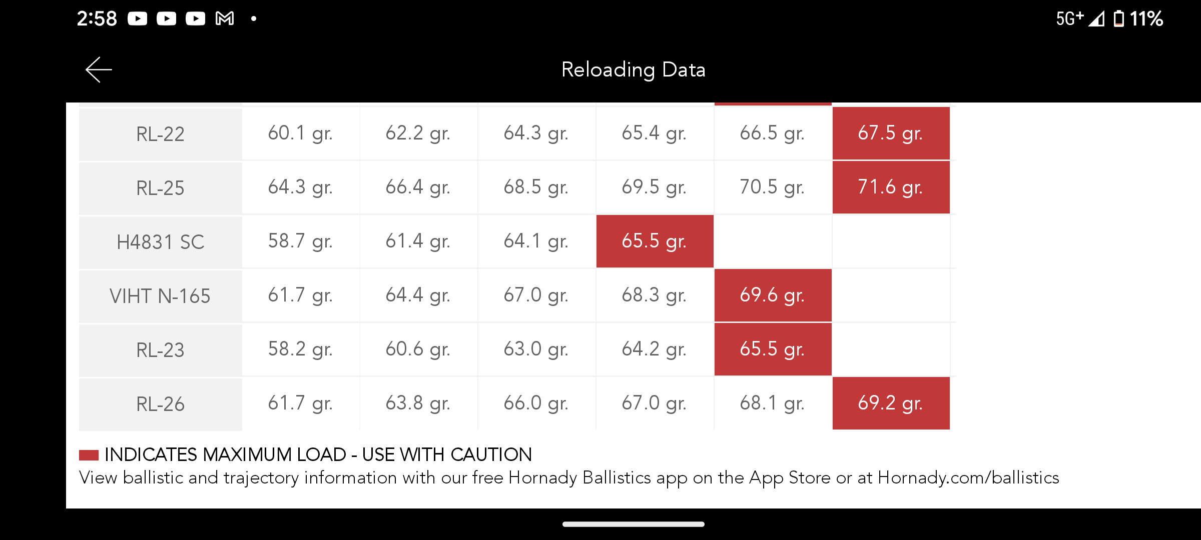

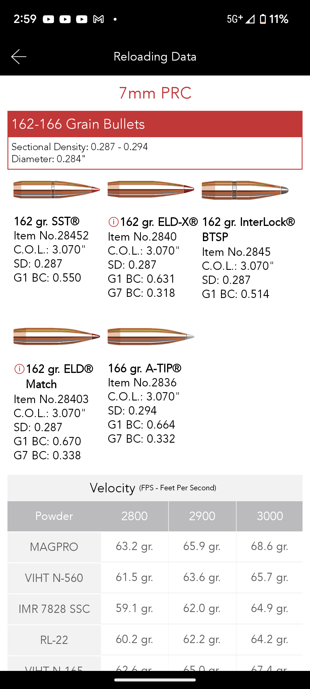

Also, given that a range of 7mm bullets are widely available - Hornady alone offers 20 diff bullets 120-190gr, has anyone seen published load data for 7mm PRC with any or all those lighter bullets? (I don’t have a manual that incl 7mm PRC; Hodgdon website publishes for 150gr Nosler E-Tips, but I’ve seen nothing else online.)

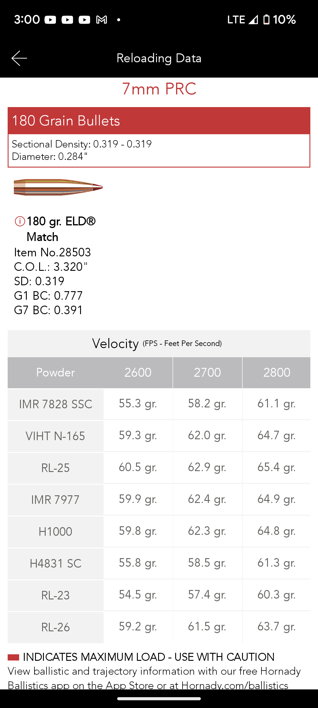

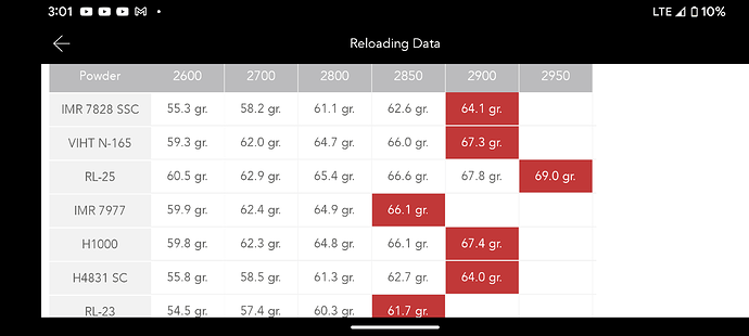

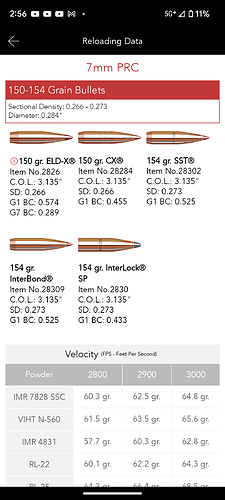

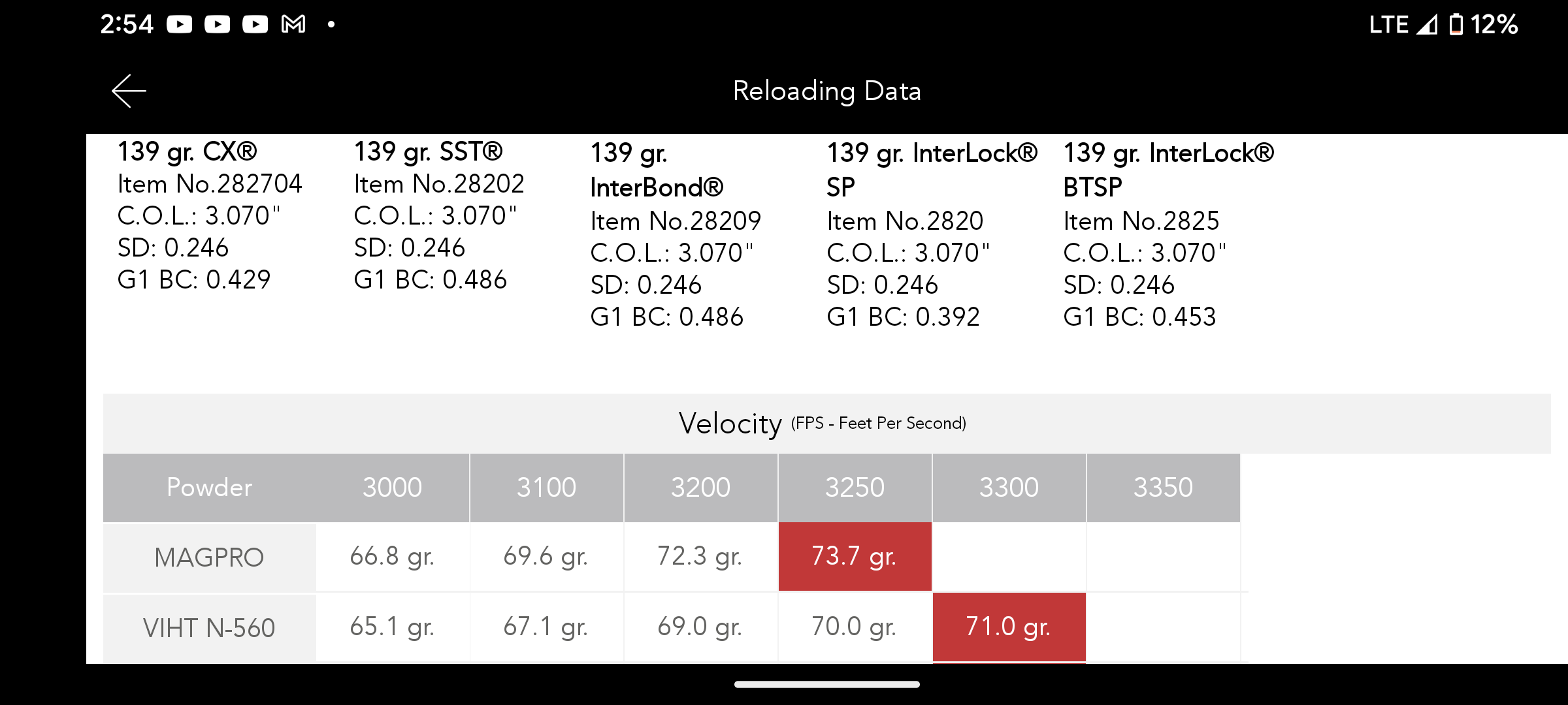

The lowest weight I see listed on the Hornady reloading app is 139 grain. All the way up to 190.

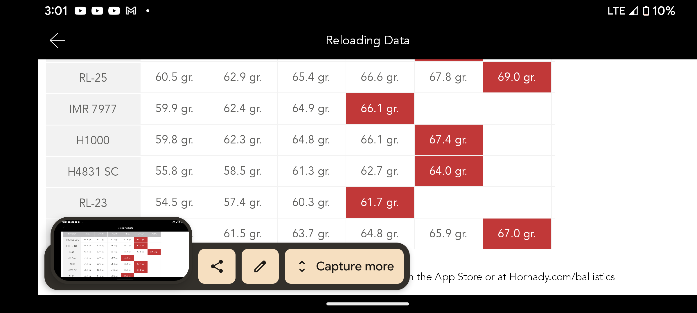

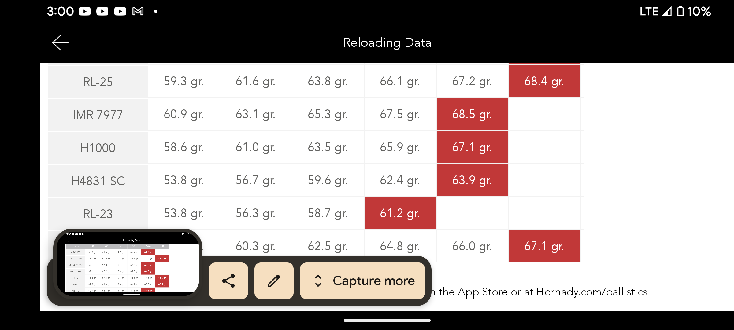

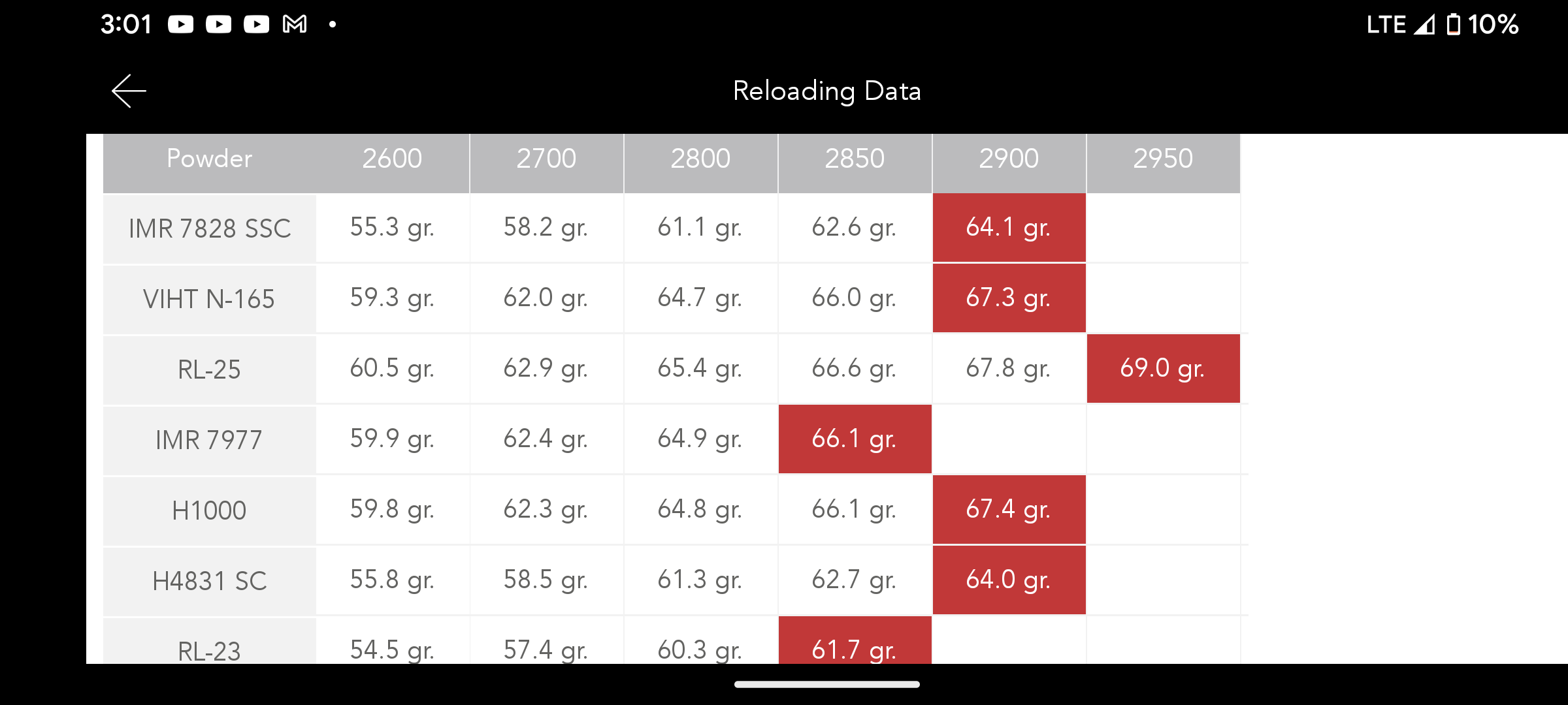

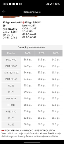

I can’t find any data on 7 PRC reloading for 168gr ABLR. Or should I not try it? I found info on Barnes LRX 168gr. I saw that 175gr is ideal. But I wanted a little variety. When I try to look up through Nosler, it takes me to 180gr ABLR as the only option. However, I am getting the impression not all 7mm bullets belong in a 7mm PRC? No?
That bullet Should work just fine. I load it in a 28 Nosler behind Retumbo
