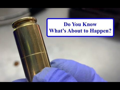

Jordan, the issue with magnums ( I assume that is what your are shooting) is not the neck tension (which annealing addresses), but the stretching of the case on the bottom end. Do some googling on case head separation “things to look for” and it will help you understand what I am talking about (and they will have pictures to explain). Pressure loads just generate greater stresses on brass, so it wears out faster; really no different in concept than engine parts; the higher the rpm, the quicker things wear out from heat and friction. Don’t get pushed away from reloading; just do your research and learn what to look for as you go; tons of good data from people that have researched all these types of things.
F-Class John on youtube has an excellent video.
Thanks John. Which video are you referring to?
