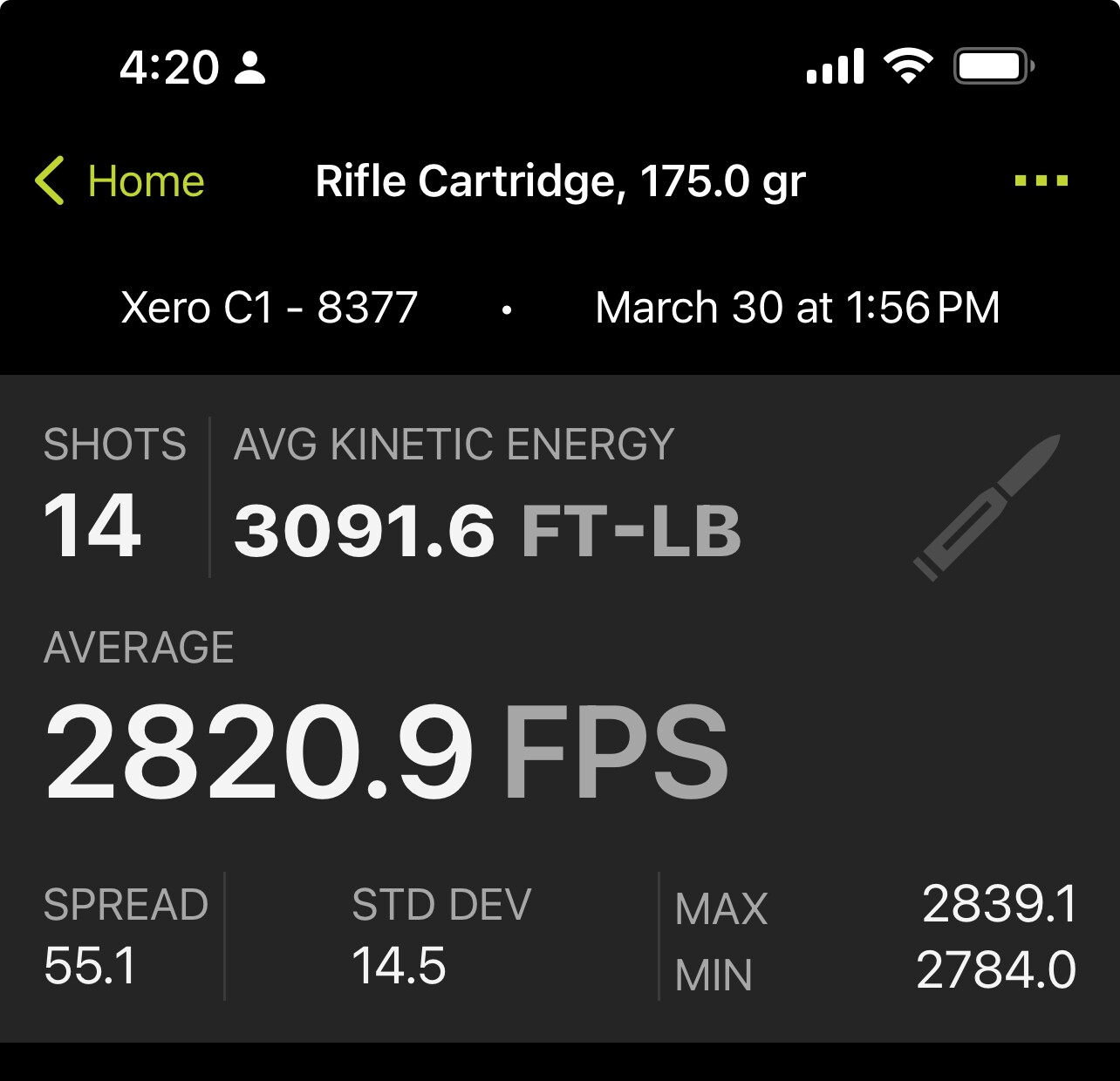

This is mine for 14 shots

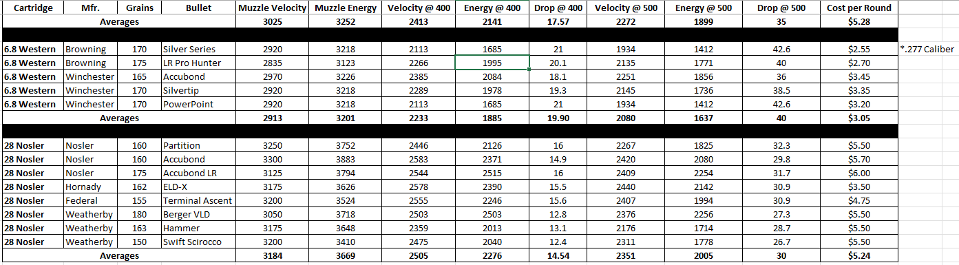

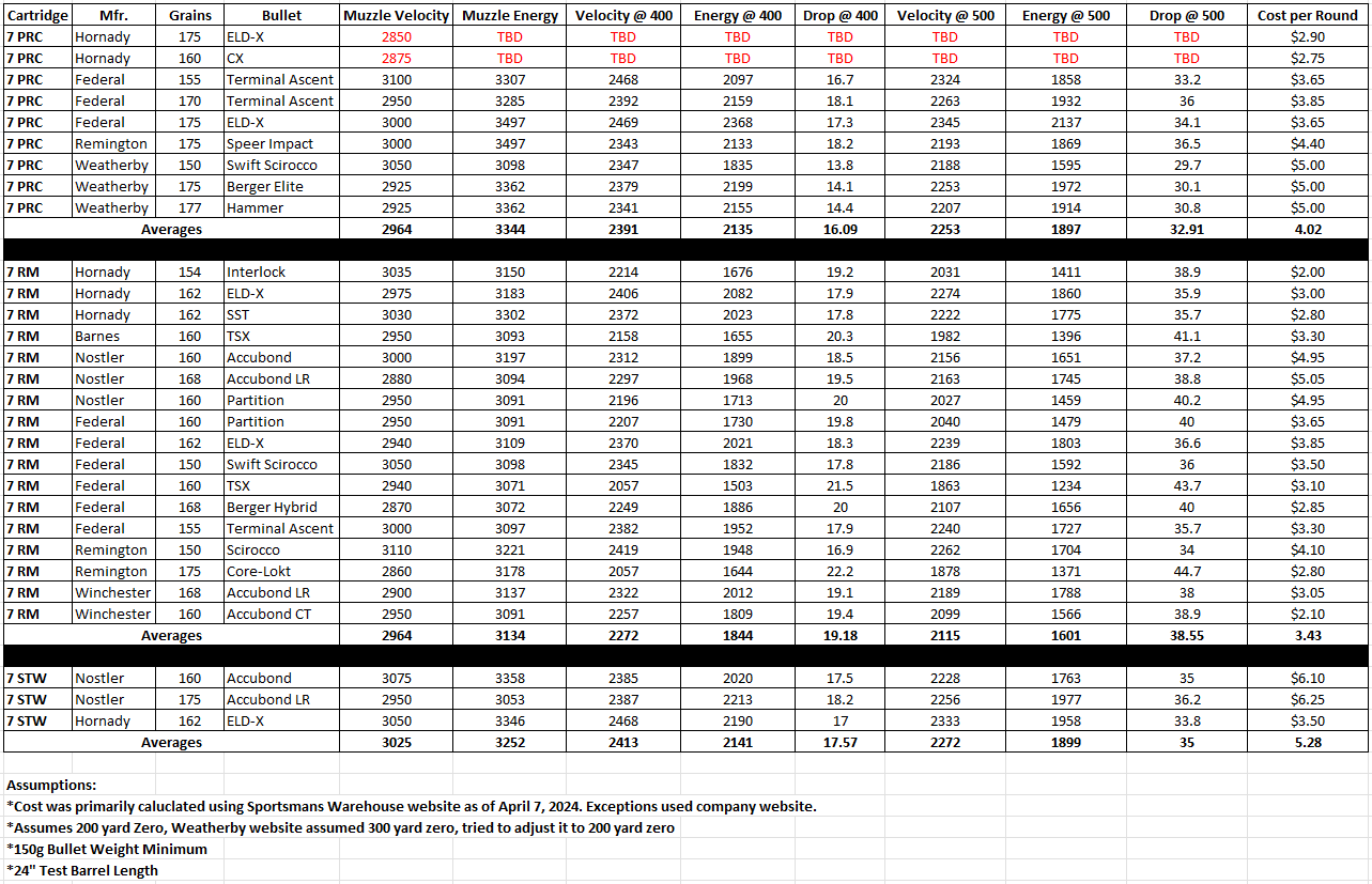

I wanted to see how the 7 PRC and 7 RM compared at realistic hunting ranges. If anyone is able to calculate the Hornady 7 PRC with their current performance, please let me know and I’ll update the spreadsheet. Some of the data averages are skewed because there’s not as many options, but I’m trying to present an unbiased comparison of the cartridges for hunting.
Let me know what you think or if you find an error that needs to be fixed.
*Added more 7mm cartridges and the 6.8 Western
Personal thoughts after reviewing it all:
The 28 Nosler ballistics are insane. The higher recoil doesn’t concern me, but the short barrel life (400-800 shots from what I read) kills it for me. It’s also stupid expensive per round.
7 PRC still beats the other cartridges for the most part assuming the other manufacturers ballistics are close to what they advertise. The cost per round is a lot closer to the 7 RM than I expected it to be.
