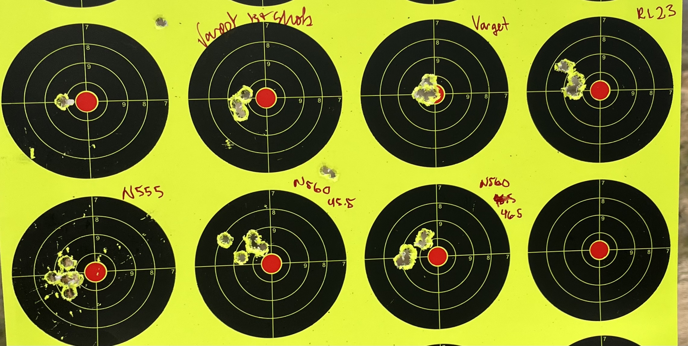

  1. Very accurate. Since it’s a wildcat most likely you’ll be going with a custom barrel which are typically more accurate than production barrels.
  2. “consistently produce 0.5 moa or better” is an interesting question. I don’t really do enough testing to say one way or the other. Typically, I will do 5 shot groups 1-3 times to get an idea of which load is accurate and then just load up a bunch of that. I have my go to powders bc powder is cost prohibitive and certain powders are not always readily available. But whatever seems to be accurate, with reasonable SDs (10ish or less) and no pressure signs is what I am looking for. Then I’ll use that load until I have reason to change it. But after my initial load development I’m mostly looking to hit steel at distance at that point. I maybe wrong, but I think most people including myself don’t really determine what a rifle can do consistently. So many environmental variables and so much time and money would have to be invested to really answer that question. What I do, I would describe as “good enough for me”. Not sure if any one has looked at Preston Moore’s YouTube videos on barrel accuracy testing but I think a system like his AZED score would be a deeper but practical way of testing barrel accuracy and then your effective range with that rifle. I’ve been meaning to try and reproduce his method with some of my rifles, but shooting a string of 30 shots at 100 yards doesn’t seem as fun as shooting farther out trying to ring steel. Here’s some 5 shot groups I did with my 7 saw. Berger 168 vlds. I ultimately went with Varget. The guys over at WTO seem to use Varget as well. I have shot 162 eld-x out of it as well using n140. I kind of want to give vv n150 a try.

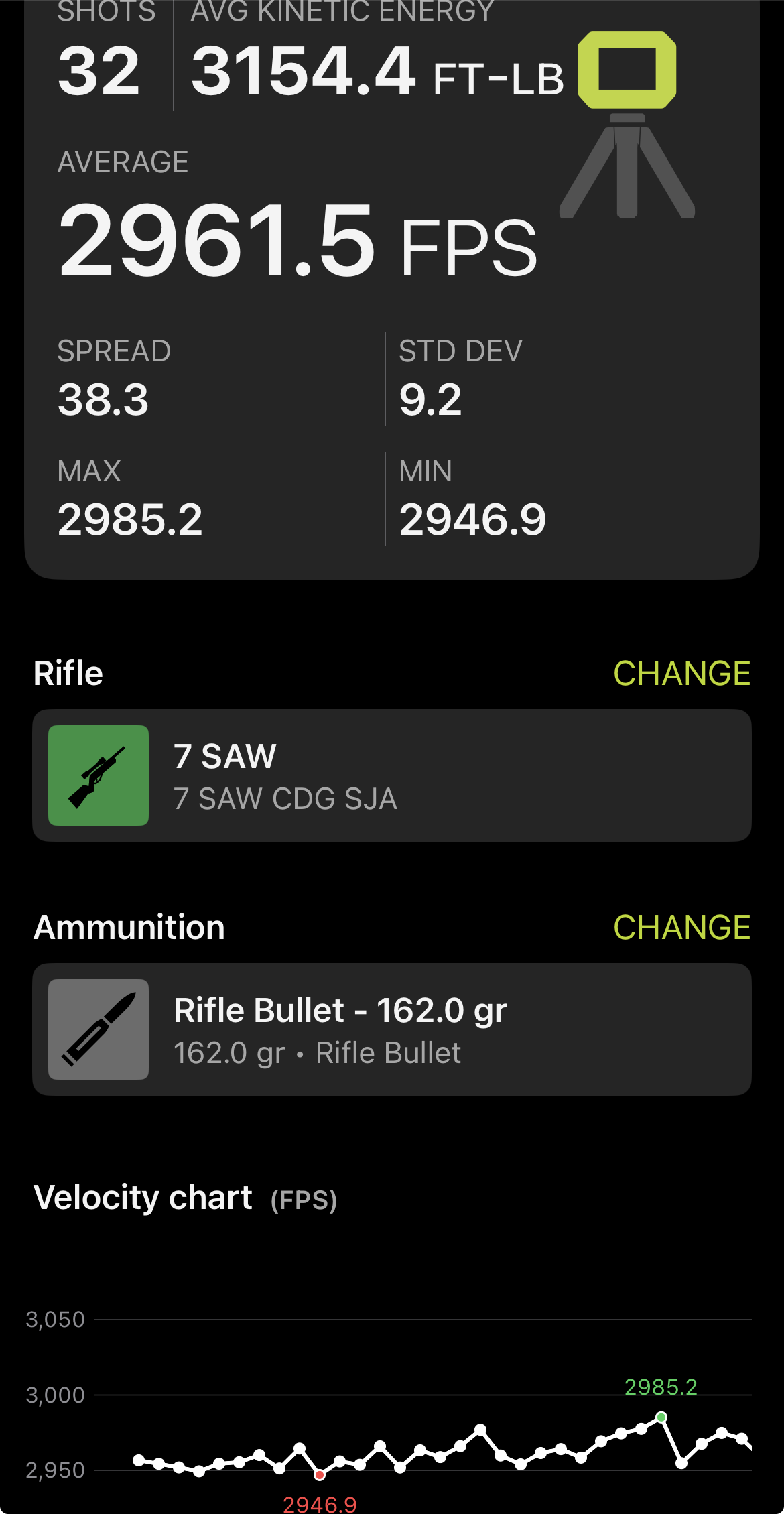

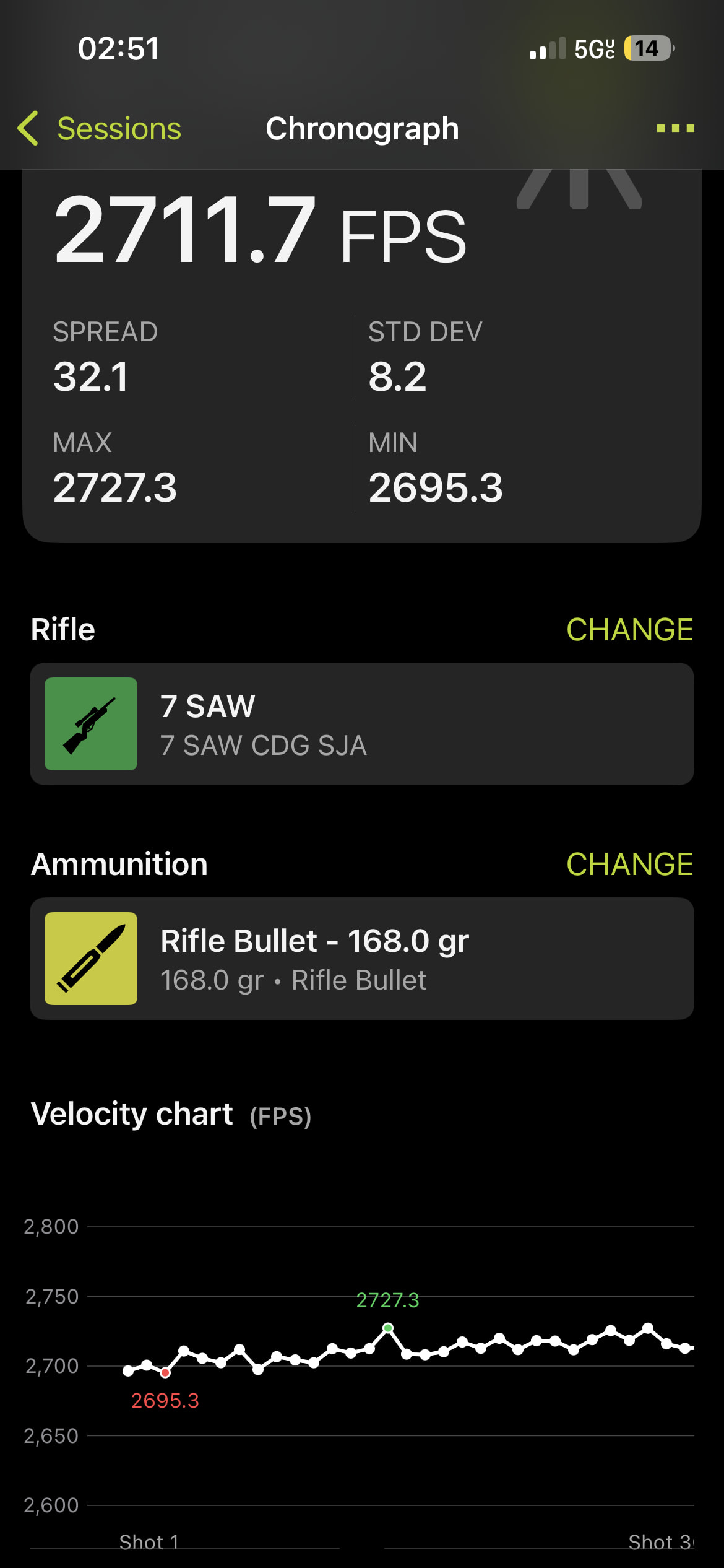

Here’s some chrono data across a long string of shots. Pretty interesting. These are 168 vlds
And 162 Eld-Xs..

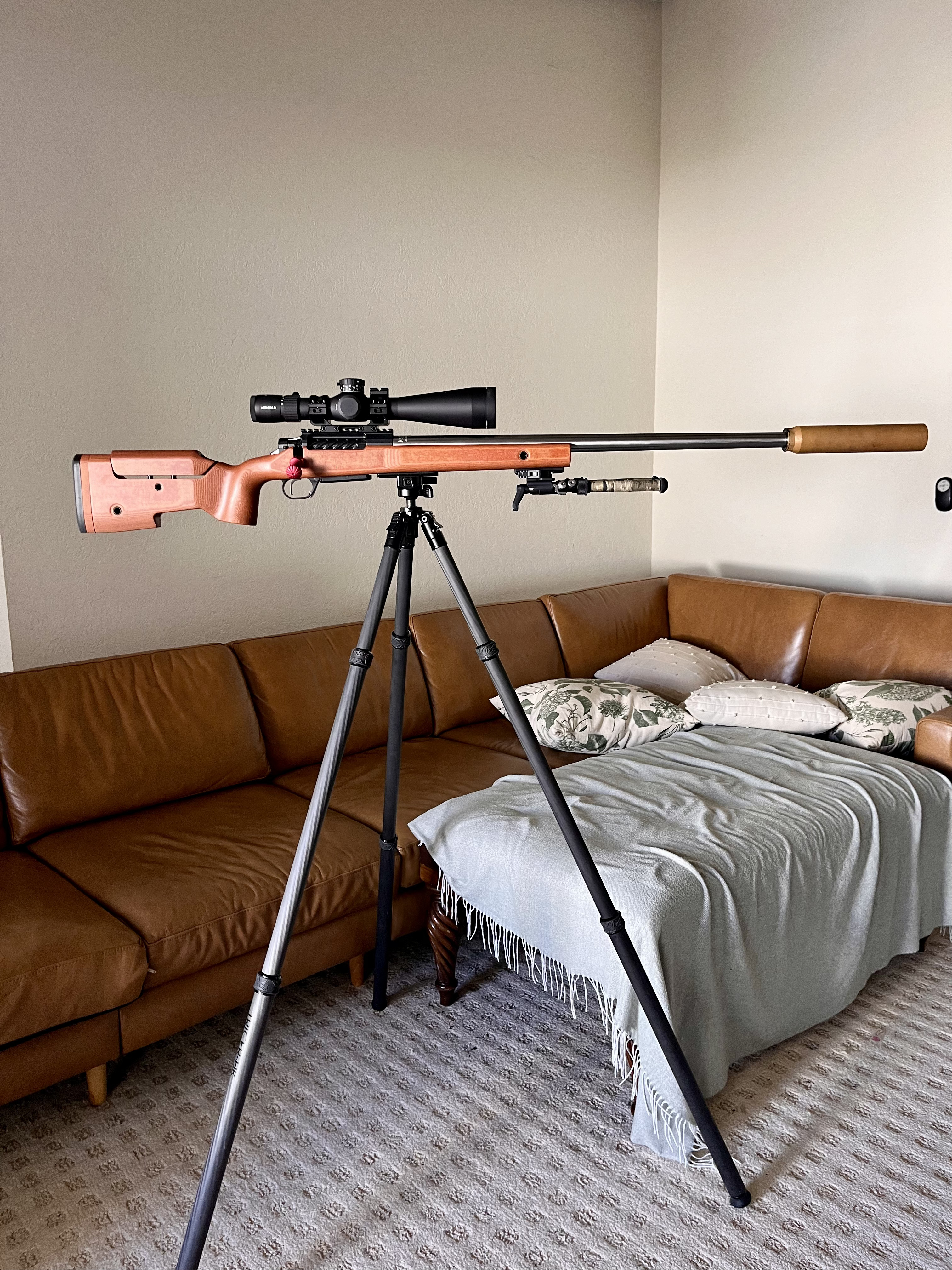

  1. My 7 saw is 26". I think if I was gonna build a hunting rig I’d do it on a tikka action with a 22" barrel and a #3b or #4 contour. For long range shooting, I like my 26" MTU contour.
  2. I think if you will never go above 168, 1-9 twist would be fine, but if you may go with heavier projectiles, then 1-8.
  3. It’s hard to compare recoil in real life bc rifles and projectile weights are so different. That being said, 7 SAW seems to be closer in recoil to 6.5. creedmoor than it is to 308. I have an old hunting rifle in 25-06 without a brake or a suppressor and it feels surprisingly good to shoot, but maybe it’s bc I expect it to recoil more than it does. Overall I’d say the 6.5 creedmoor has the least recoil of the bunch.
The specs of my rig are arc coup de grace short action, straight jacket armory 26" MTU 1-8 twist 3/4-24 muzzle threading. Foundation Exodus stock. Hawkins bottom metal. trigger tech diamond trigger.

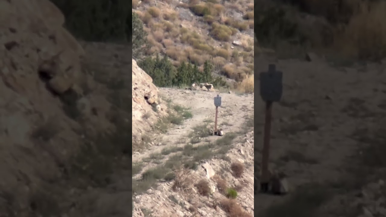

And here’s some plinking at 1200 yards with it.
