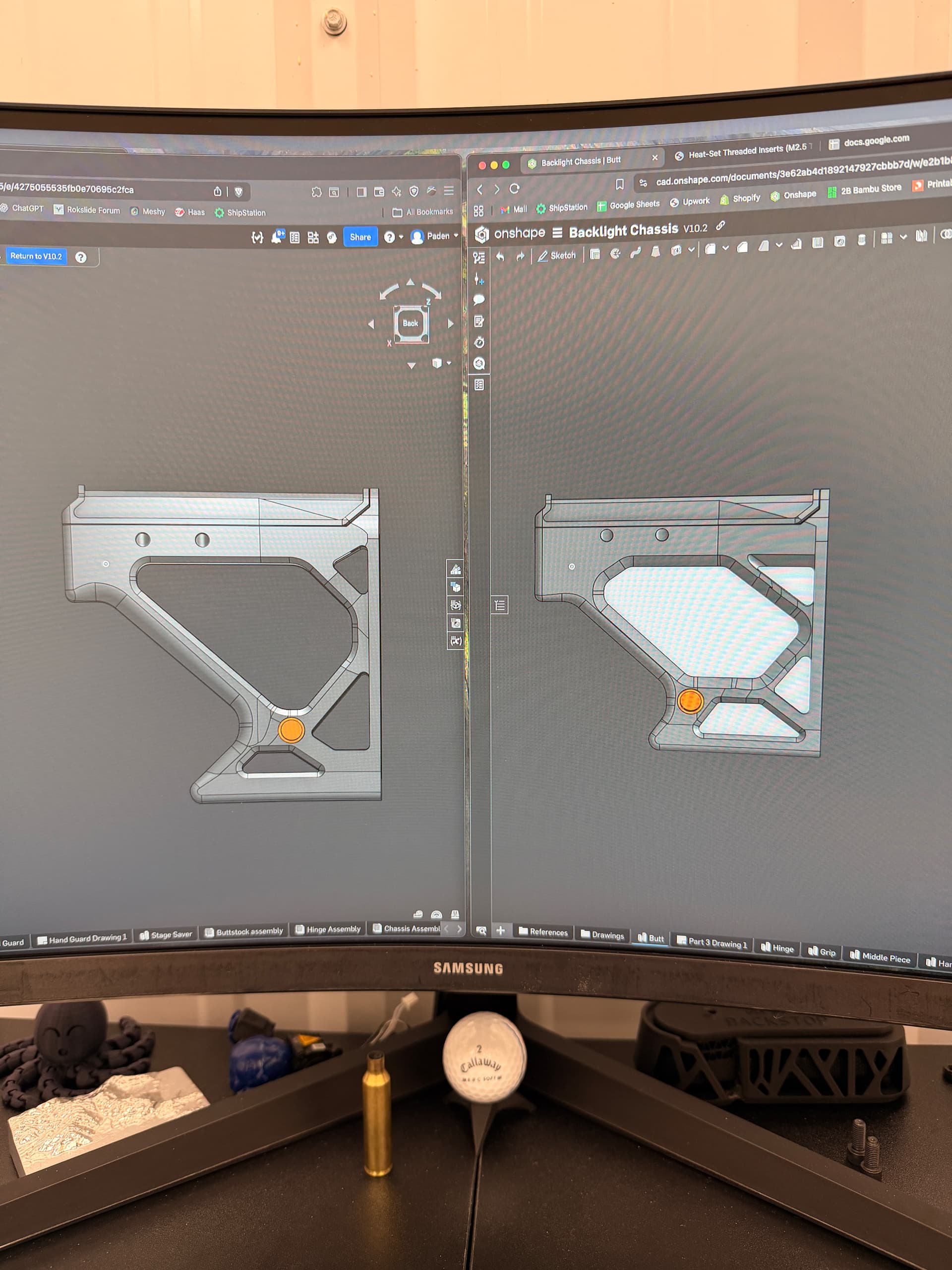

A photo of the upcoming Backlight chassis
This is purely aesthetics comment: I think the buttstock is a little blocky / chunky looking. It looks a little like the 3 parts: Fore end, chamber & grip area, and buttstock were all designed independently and put together. The design lines don’t feel like they flow / mesh super well together. Just my personal opinion on the aesthetic design. Don’t hate me.
This closely resembles the PRS-winning setup from 2025, aside from the swing stock. I prioritize performance over appearance. Many attractive rifles fail to perform. If the design emphasizes function over form, offers a stable platform for producing small groups, and is reasonably priced, take my money.
Thanks, Jim. Getting interesting! Will it be drop mag only / no floor plate option? The butt stock is taller than I was expecting. How would LOP be adjusted? Same for cheek riser? What is the source of rigidity for the forend? Really like the pic foward and long arca rails! Will the grip have any type of “rubber” overmould or “ grippy” texture? I’m stalling on a HNT26 in anticipation of this. Thank you for sharing.
It will be mag only. I have never seen a chassis with a floor plate but that could be kinda cool in the future.
I agree with a couple of you commenting on how big/chunky the buttstock is. Really helps from a shooting perspective but I agree that it’s probably too much.
We’re working on some adjustments to the buttstock to put it on a diet :grin:
For me, having gone through a broken stock on a minor fall on day 2 of a 5 day hunt, I don’t miss the extra material. I think you rethink the aesthetic of the cutouts. They are asymmetrical, but nothing else is (at least by what I see). Some symmetrical might blend the size better.

We’re working on some refinements of the buttstock. I really like it as is because I think it will contribute to the best shooting experience, but I also have to balance that with the visual look of the chassis and it does look like a watermelon on a toothpick :grin:
Lefty option?
Here’s the new look for the buttstock based on y’all’s responses that the buttstock was just looking too giant. The one on the left is from the previous pic I posted and the one on the right is now not as tall, reduced the angle on the hook to be less snaggy, has more symmetrical cutouts… and loses another 1.7oz.
Appreciate the ideas. We have been staring at these designs for literally thousands of hours so it’s nice to have a fresh set of eyes on it to highlight the things we don’t notice anymore because we have seen it so much.
We’re making over 50 little tweaks this week and will manufacture another prototype to be ready by middle of next week.

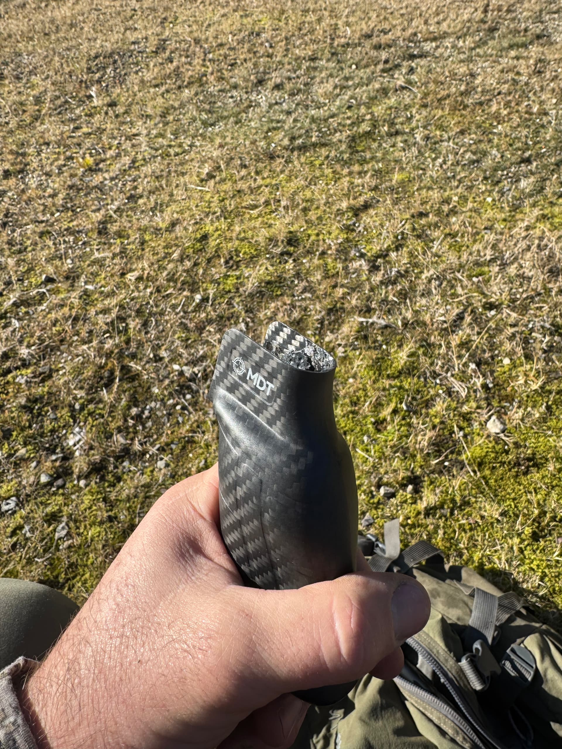

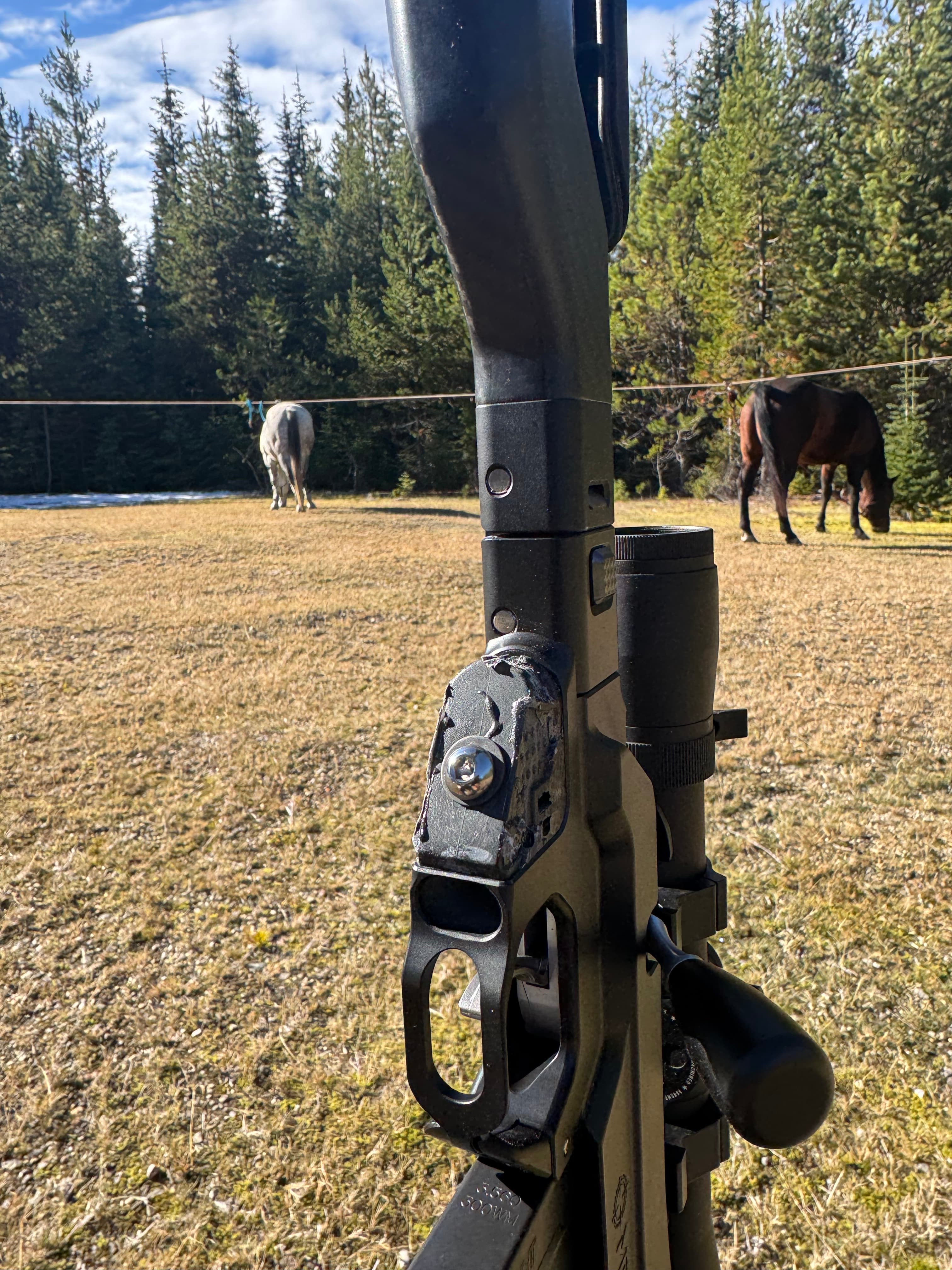

My two cents, don’t glue the pistol grip on! Had the expensive competitors version of this. First hunt I took it on in north Idaho this fall. It was a Cold day and the glued on pistol grip broke on me 8 miles into the back country.
Legit owned it less than a month, had it long enough to put on, site in and carry strapped to my pack hunting.
Did it break off in your hand, under pressure, while strapped-in, etc? Curious as to what MDT said and how they responded?

I strapped it to my bag and rode my horse in. When I went to take it off my bag, the handle fell to the ground.
I have a EXO Mt pack with the rifle holster and it was strapped to that. So it’s not like the weight of the rifle was on the grip and I didn’t drop the pack or go tearing through rough country. I had the butt stock in the holster, then two straps across holding it to the bag. One below the scope and one higher up. It was around 20 degrees out though so I’m guessing it had something to do with it going from being in a warm truck to a cold environment
They offered to glue it back together and fix a mag well spring issue that I was having. I had an issue where the roll pin for the mag release kept working out every couple shots, which they told me was a weak spring
Their customer service was very good. They responded quickly to my emails and answered all my questions. Ultimately I asked to return the stock because for 1700 bucks I don’t think they should have those kinds of issues.
Specifically the grip only being glued and falling off just seemed cheap to me. I hunt in some very remote places and the last thing I want to worry about is my grip falling off every time it gets bumped.
To be fair if it had never fallen off, I would have probably never had an issue with it being glued.
They gave me a full refund and paid for return shipping. It was a bummer though because have a folding stock was amazing for the short time I had it.

I never would have expected a grip to be glued into position. I thought that’s the whole purpose of having a grip screw.
