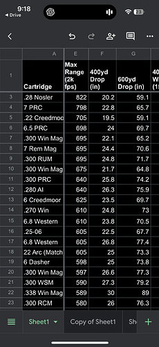

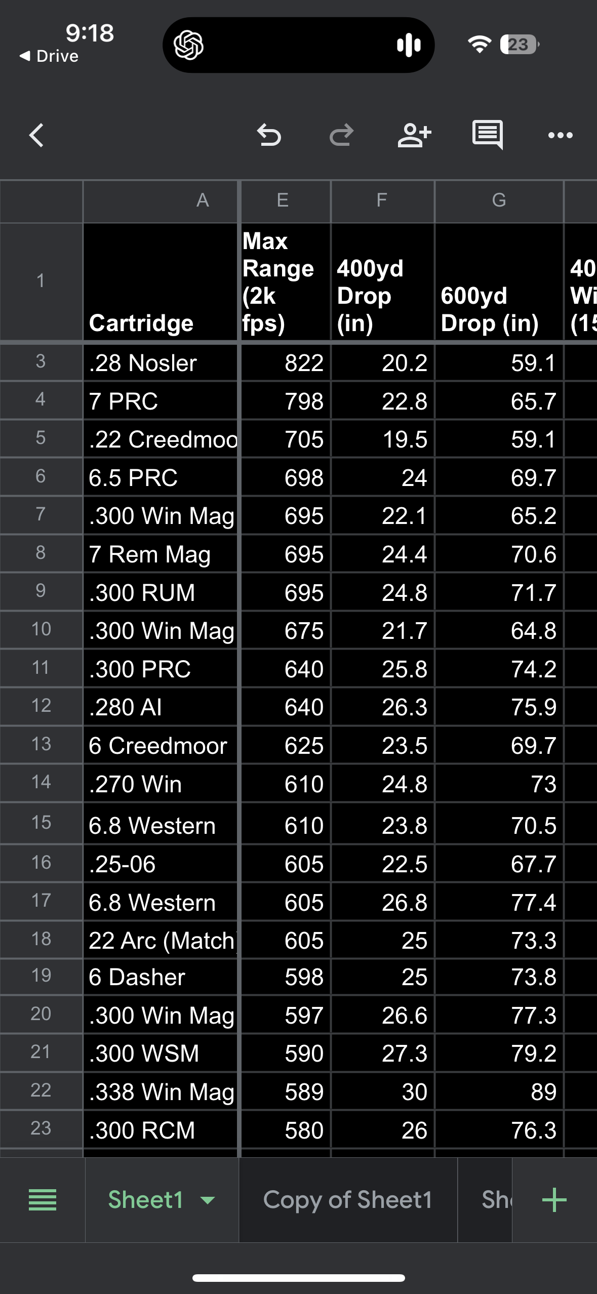

Options are certainly limited if you’re wanting to reach 700 yards. I really like maintaining 2,000fps of bullet velocity at target to help the bullets expand well.
This image shows some options and their max effective range. Obviously some are too small for elk, but still have a long effective range.
For me, three options jump out. 7 PRC, 300 Win Mag, and 280AI.
For what you’re describing, it sure sounds like 7 PRC is a fit. But it’s still a LOT of recoil. More than most people shoot well.
If you could reduce the mex distance to a still very reasonable 640 yards, there are 280AI loads that would be fantastic.

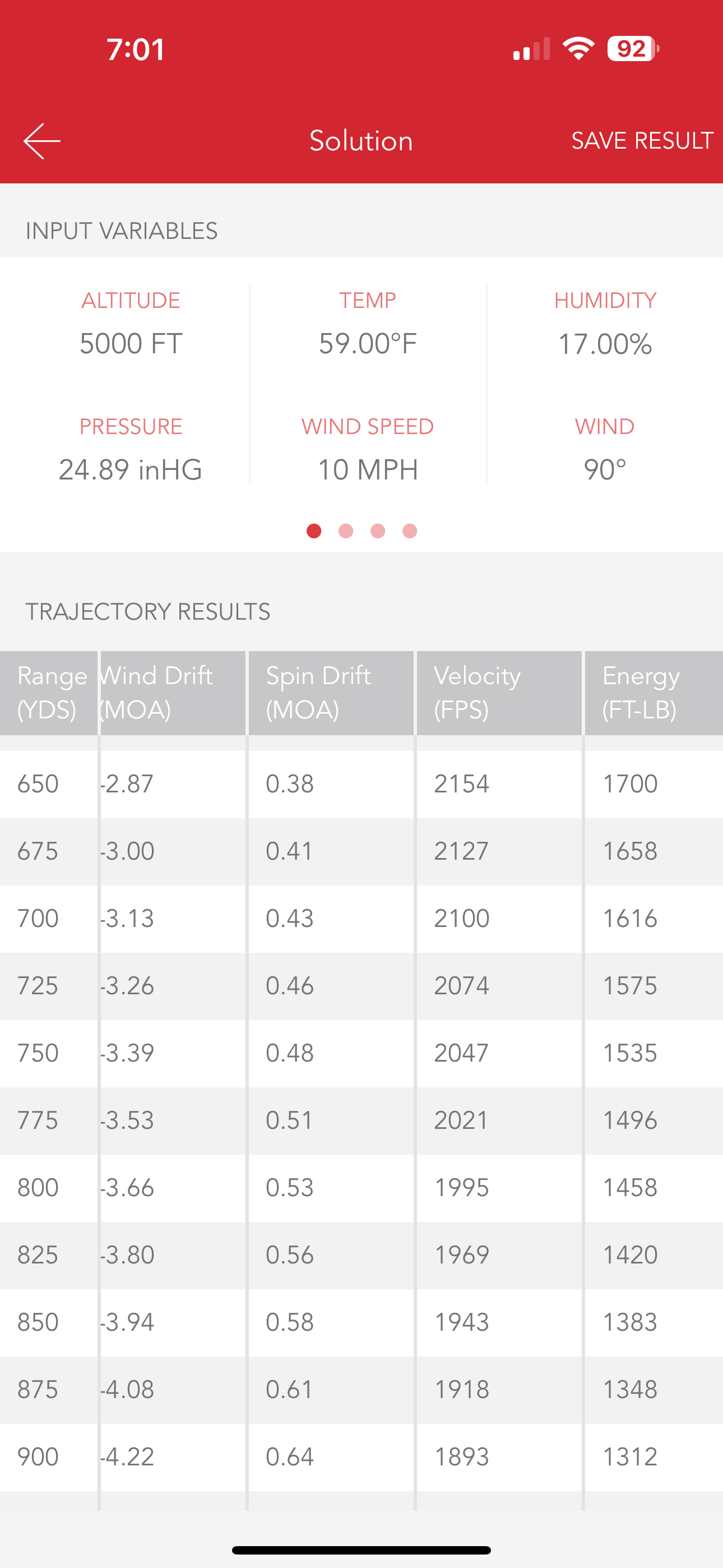

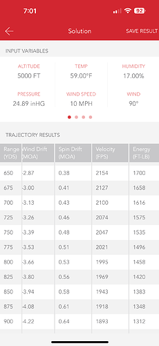

@backfire Jim, why with all other cartridges do you use their best set of data but for the 6.8 western you don’t. The data you show doesn’t show what this cartridge can actually do and makes it seem so much less than it really is.
With Winchester expedition long range getting a velocity of 2930 at 5,000 ft. Elevation this rounds maintains 2000fps out to 780 yds.
