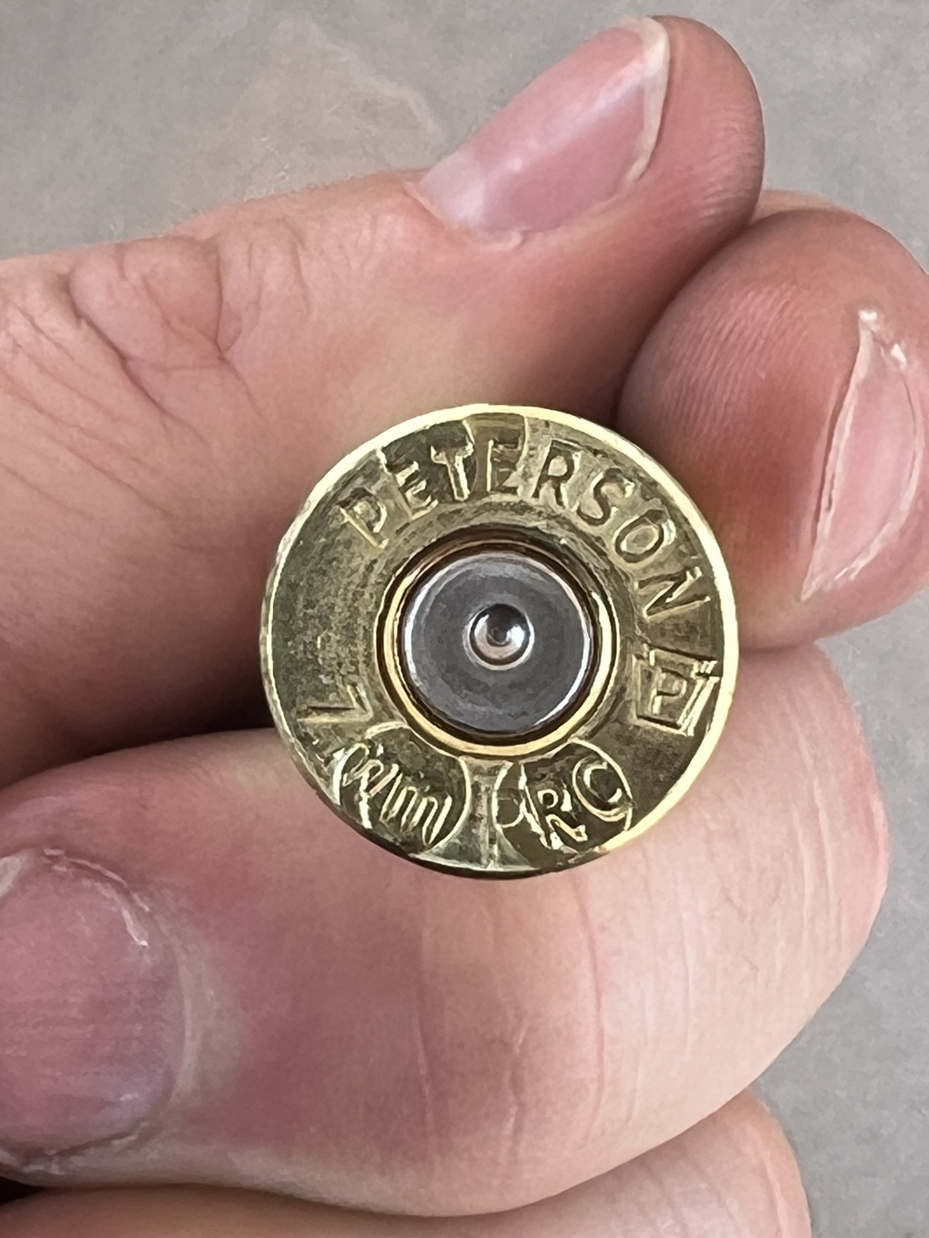

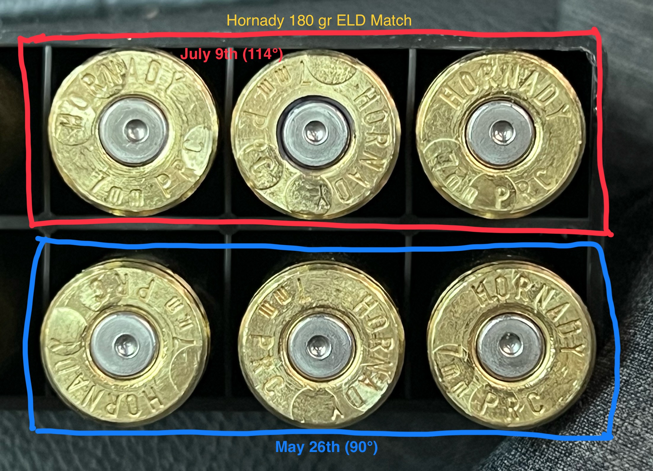

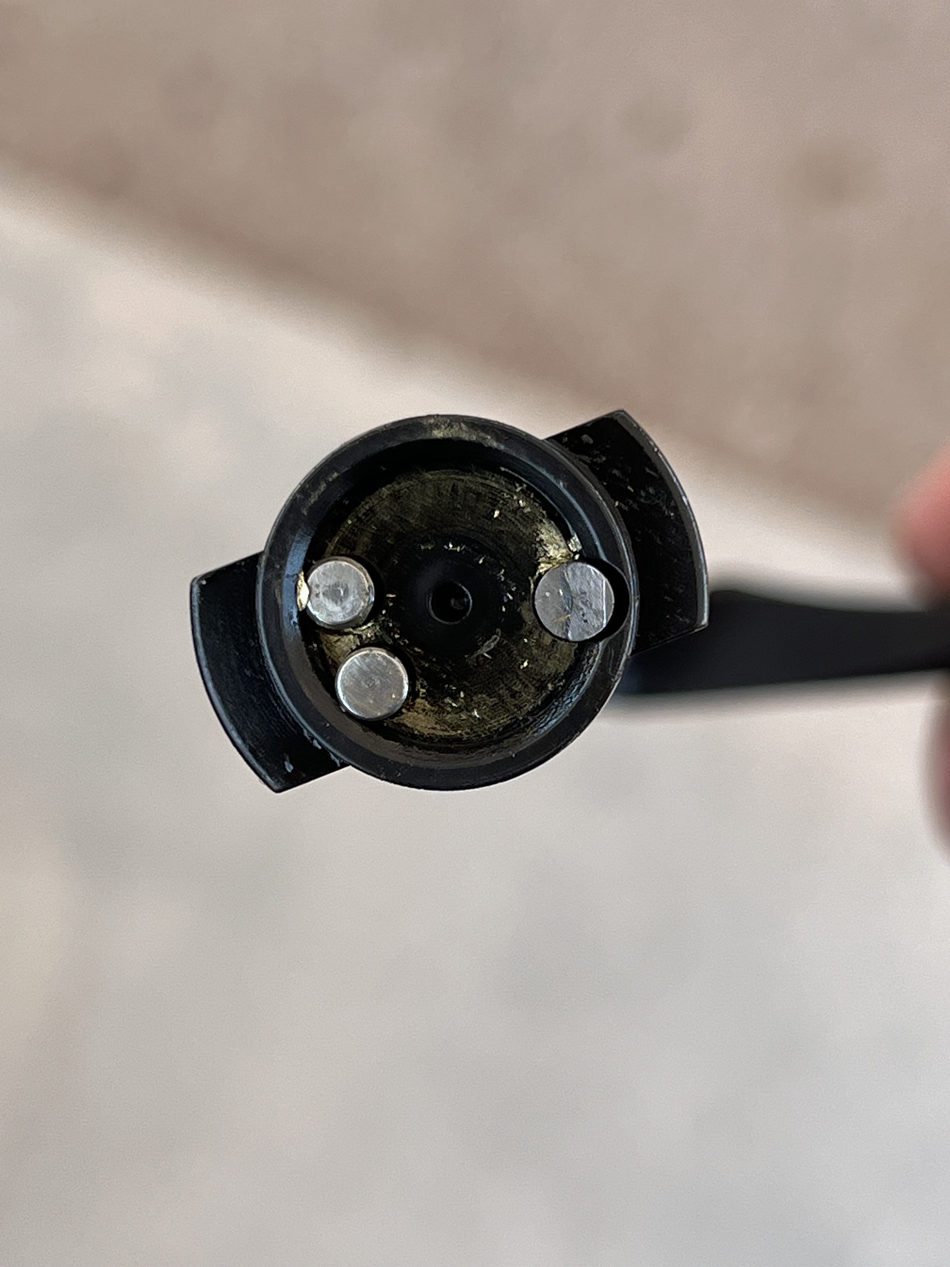

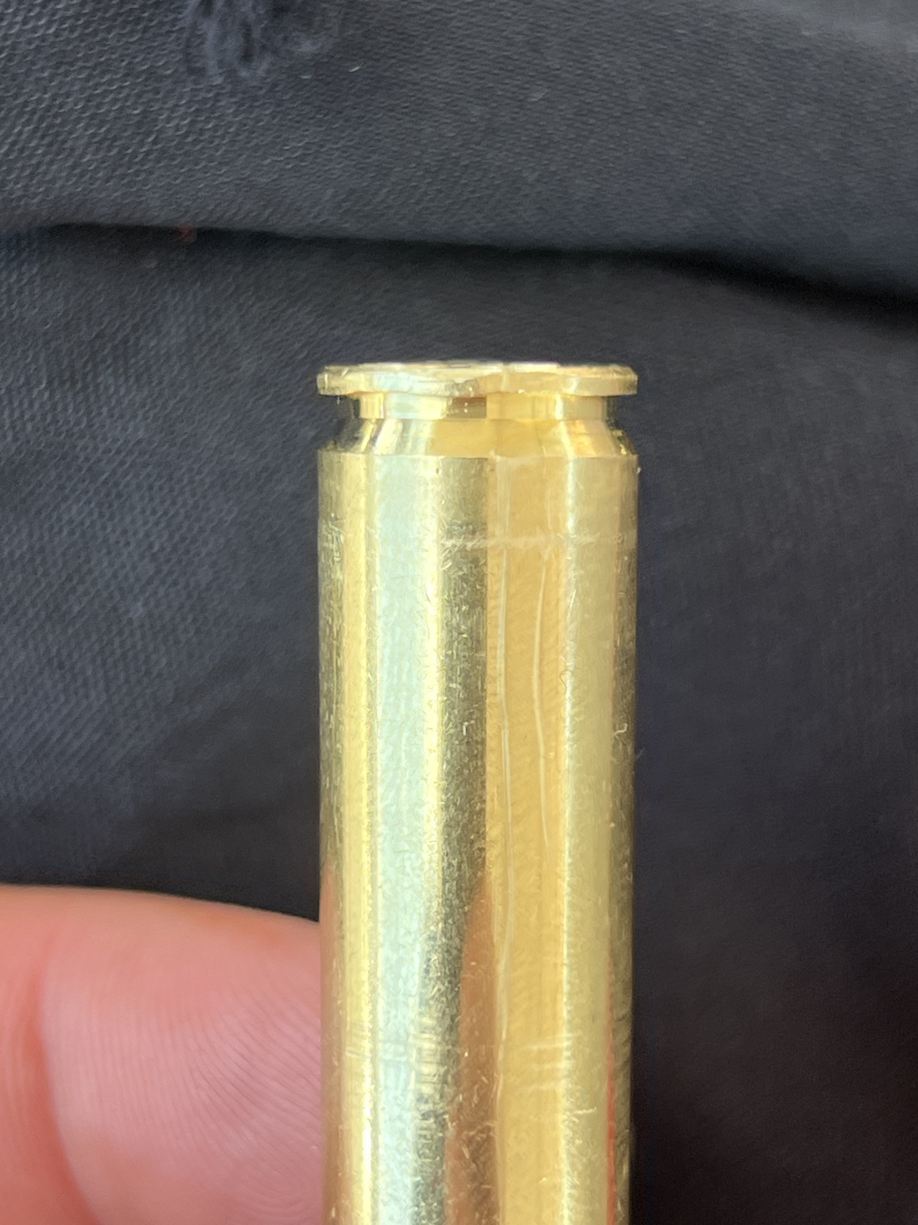

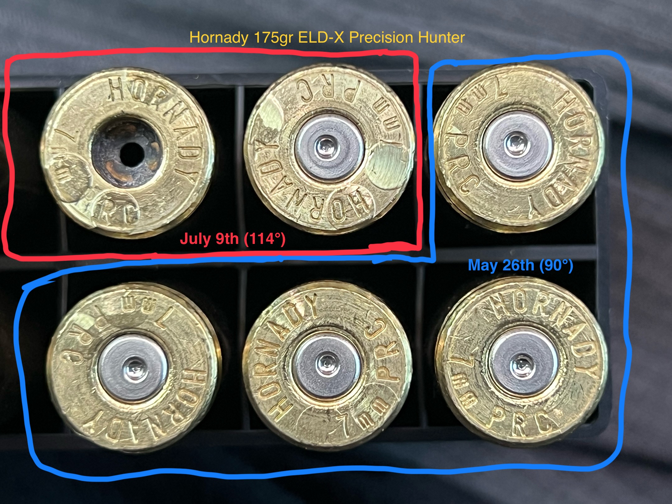

I tried to continue my load development on my 7 PRC today. I live in Vegas, and it was around 114 today. I was shooting from a bench rest in the shade but decided to stop because I was getting signs of over pressure in both the factory and custom loads. Extremely stiff bolt, bolt face marking on the case head, and deformed case ejection lips. The precision hunter actually blew out a primer, so I stopped after the second shot of that. I even had all my ammo in a cooler so it should have been relatively cool. Here are a few pictures.
Holy crap!
Even with Factory loads, not sure what to make of that.
It feels like 115F here, but that’s due to the high humidity. It’s never gotten above about 96 so far this year.
Wow. Thats pretty scary.
I’ve seen that here in St George where I keep the ammo cool and in shade and such but still go way over pressure on hot days.
Wonder if it has more to do with the metal of the gun more than anything.
I imagine that when it is a 114° outside, the barrel stays pretty hot, and it probably only takes a few seconds of being in the chamber to heat through the thin metal of a case, so I don’t know if keeping the ammo cool before hand actually does anything to help. Just my speculation.
Maybe the only true way to know if it is the load, (too hot) is to take the same box of ammo, and save it till the fall when the temps are back into the 50’s. If it still does it then, it helps to eliminate a variable as to what is causing it.

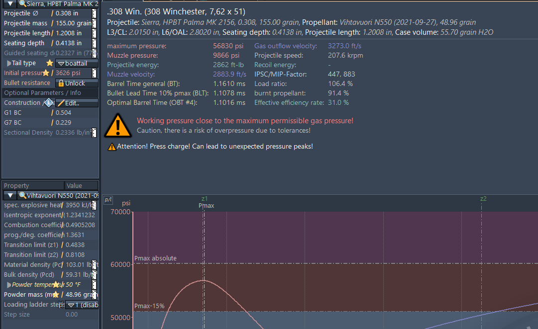

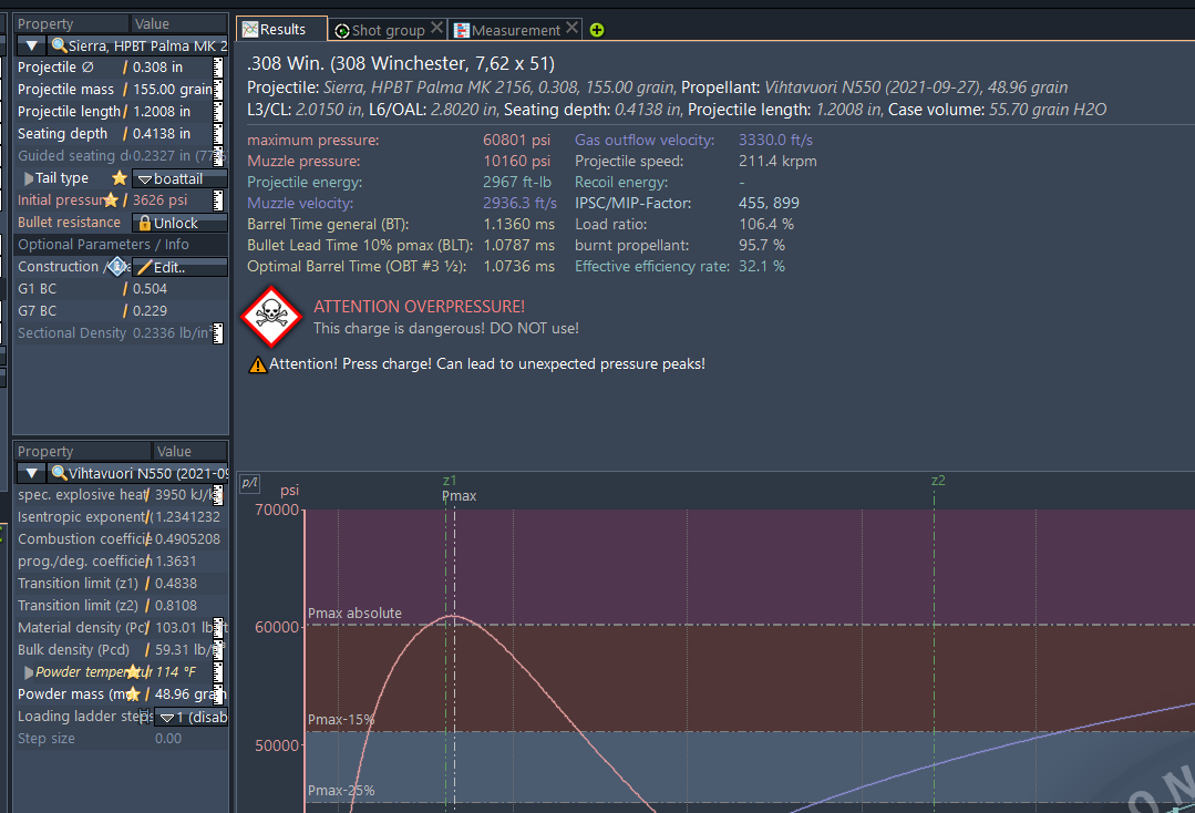

If you learn how to use GRT or quickload you can predict temperature effects on your loading and adjust your powder charge to compensate with a high degree of accuracy. Here’s the same charge of a “temperature insensitive” powder gaining 50 fps and going overpressure from 50F to 114F.
