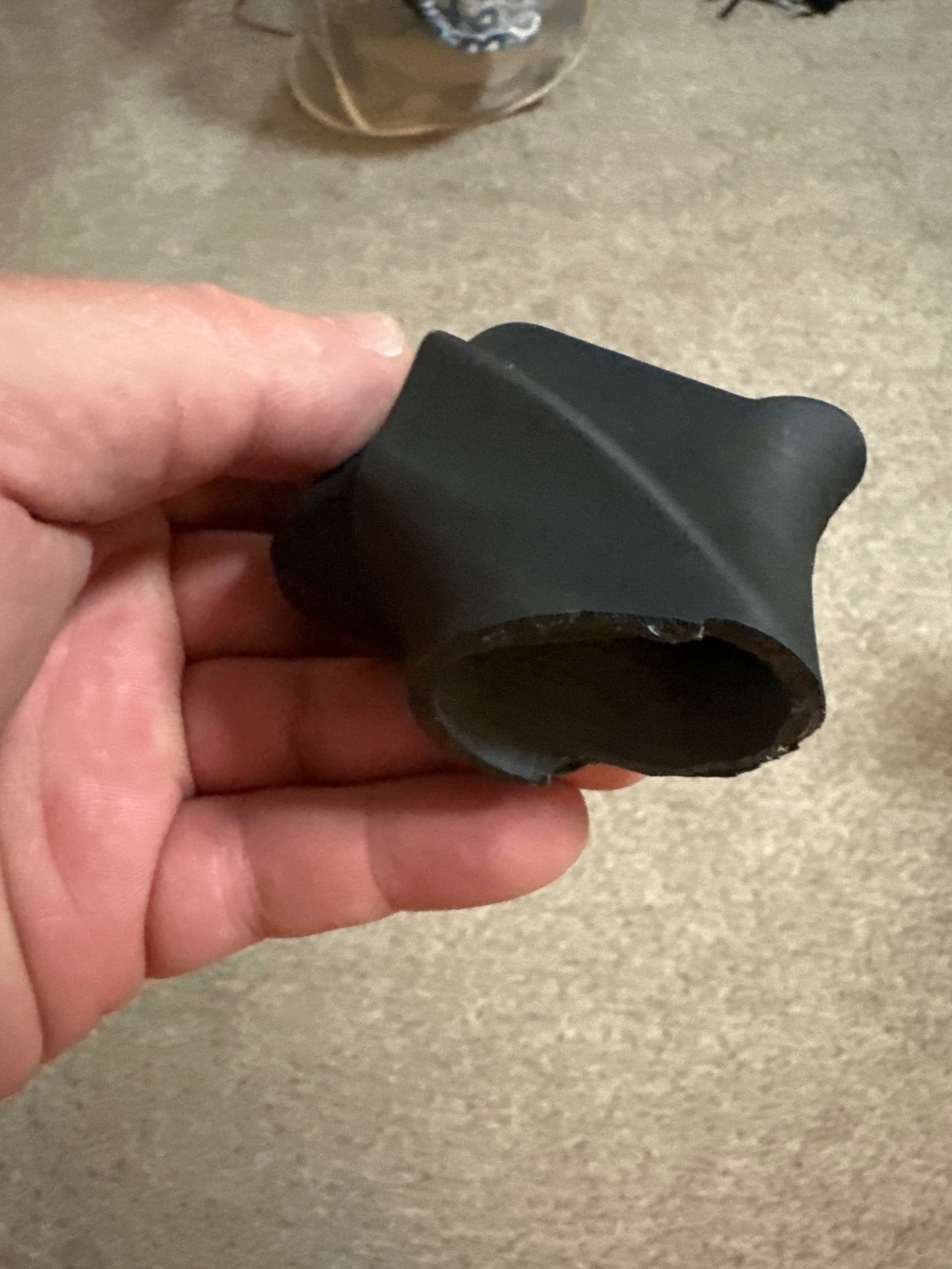

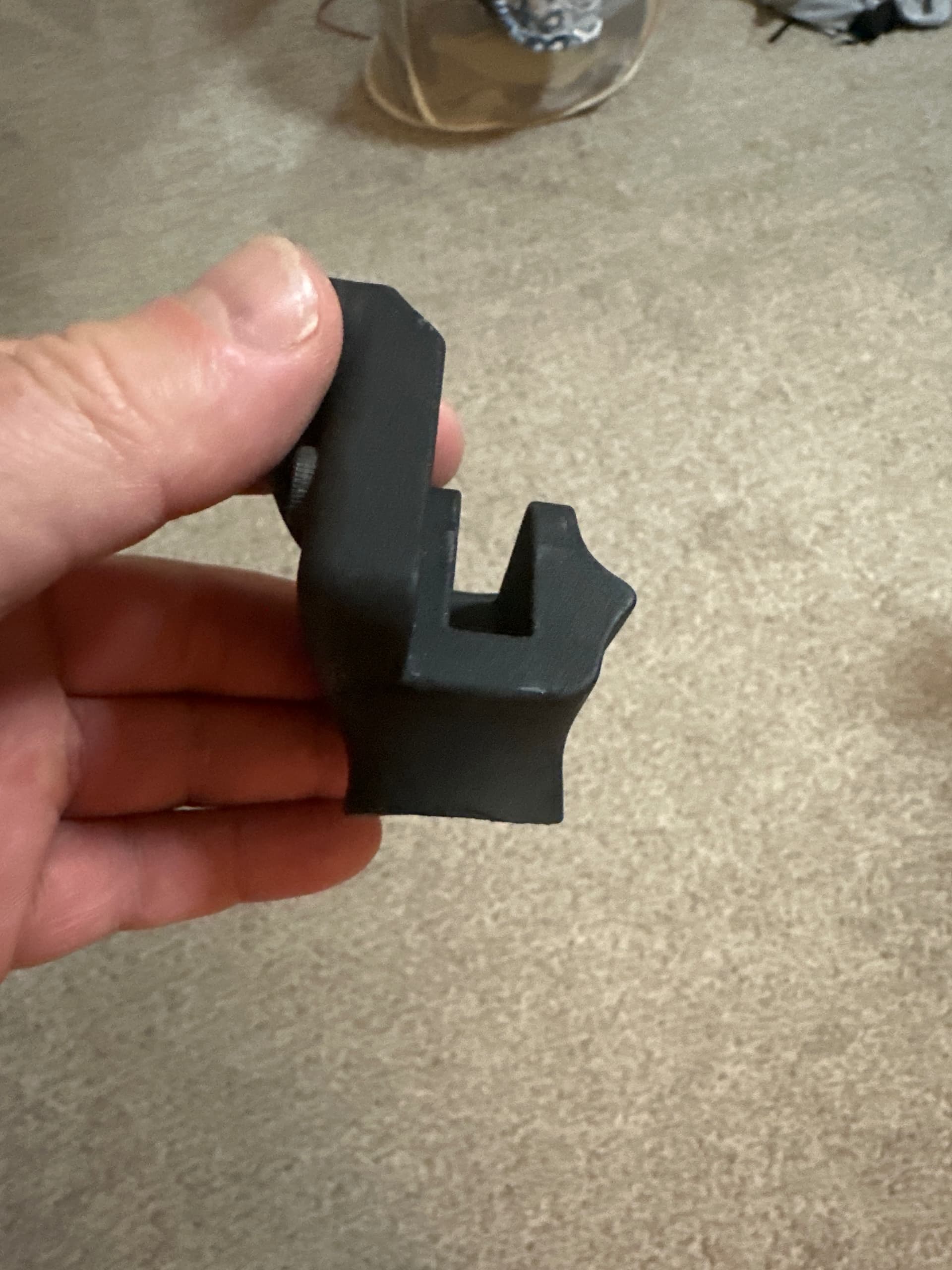

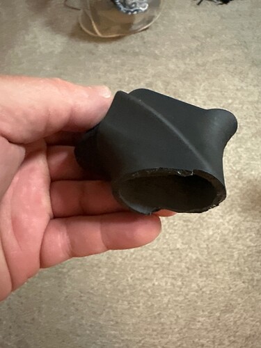

Sorry if the title is misleading, but my chassis is a Ultradyne. It broken right at the vertical:
Ben So sorry that happened must have been a huge bummer… Bonus you had another . 2 is one 1 is none. What is the chassis made of? Composite? Didn’t see on the website That is one light chassis as I looked at It. at some point when it gets that lite with repeated stressing either from heat sun exposure cold or all of the above these things have to get weak at some point . Thats just an educated guess mind you. Im an Electrical engineer not a mechanical but for my early classes materials stress etc.
ASA Thermoplastic. I thought it was magnesium, but I guess I shouldn’t be surprised it broke since it’s plastic. Ergonomics of it really good.

Ah, I can see why that happened. Ultradyne used an fdm 3d printer for the grip. Terrible call because fdm has major weakness along the x axis, which is exactly why you see that clean break through the x axis of the part.
The Backfire chassis and grip is built completely different.
