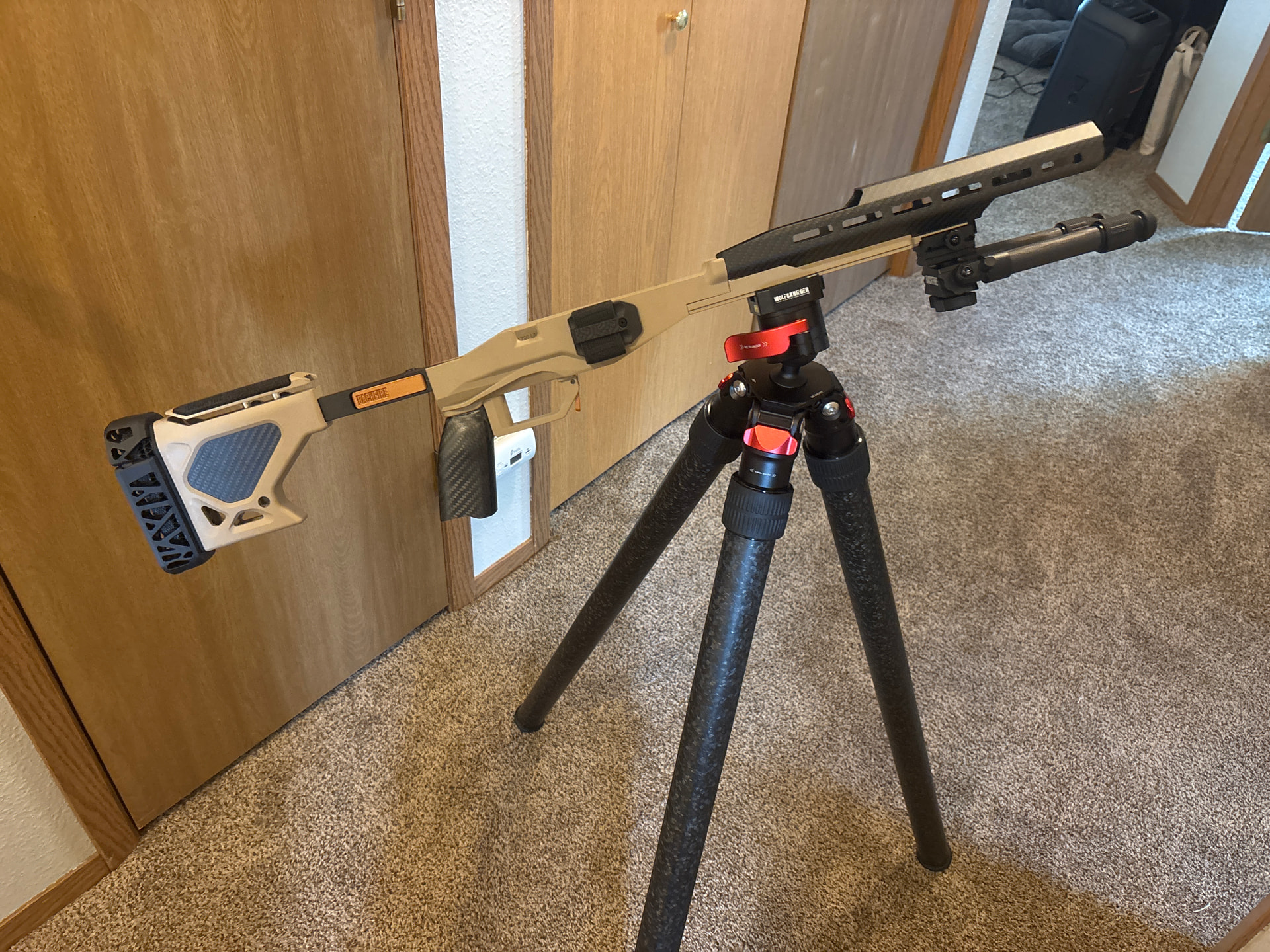

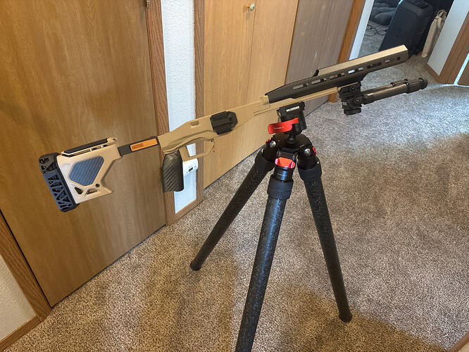

Its pretty nice just need my action to come in for it and I’ll be ready to go, some minor issues as well I’ve found but they are easy fixes.
Minor issues with the chassis?

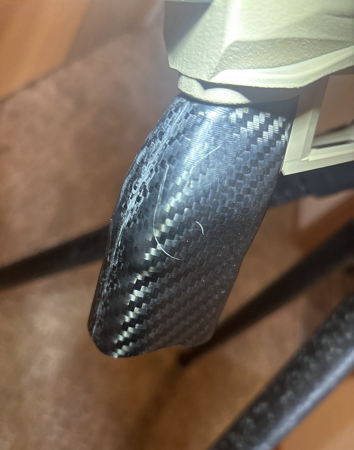

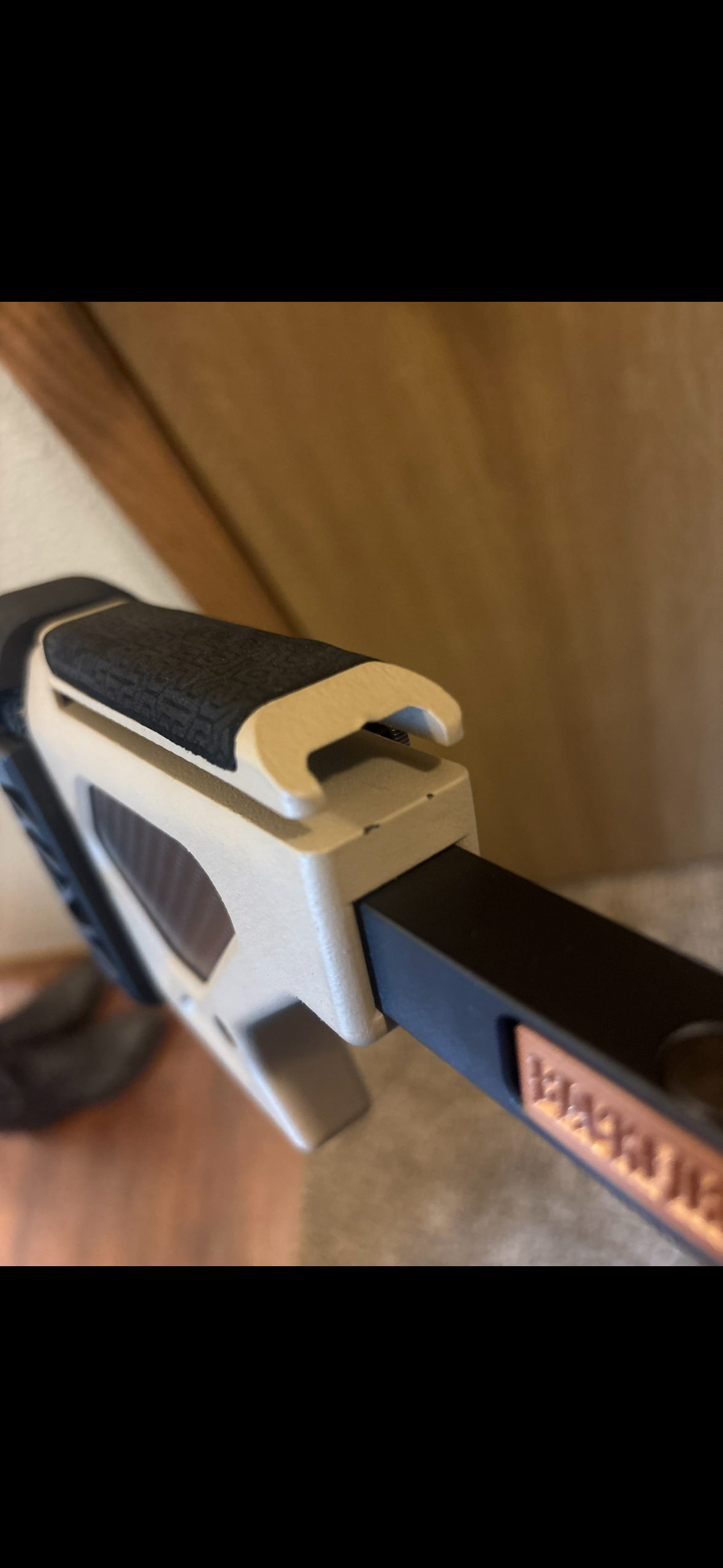

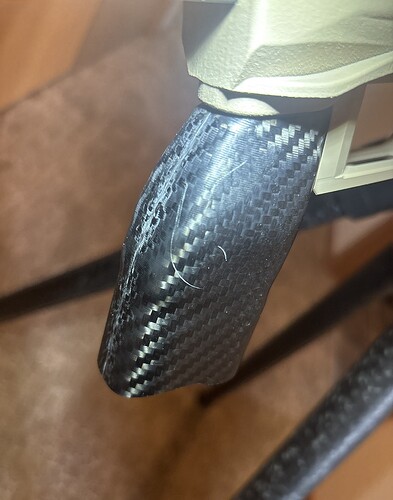

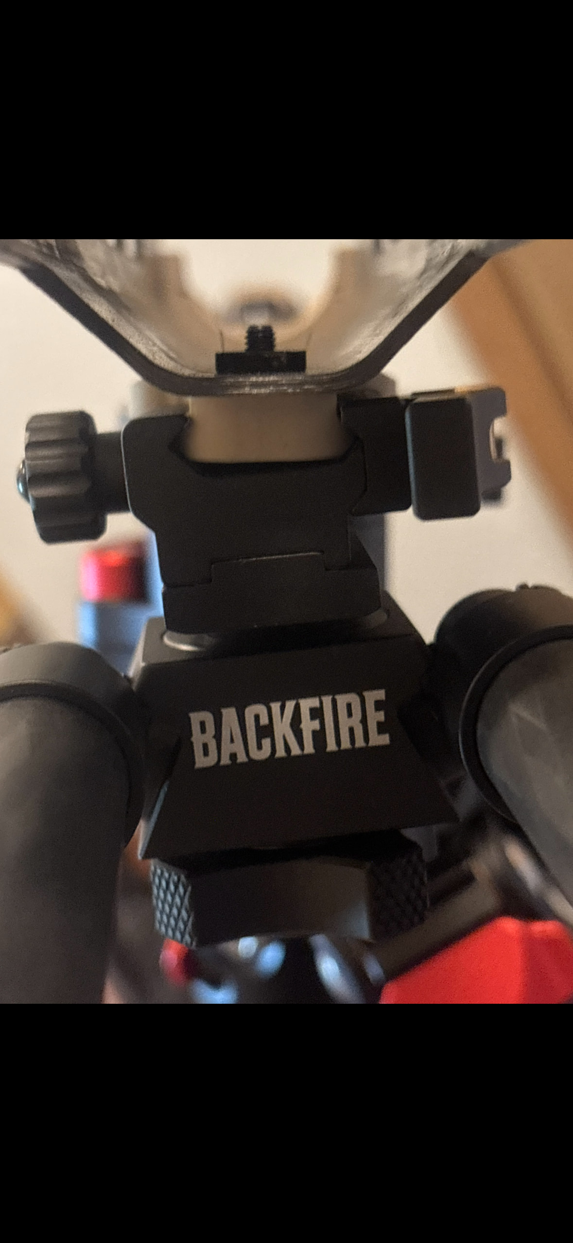

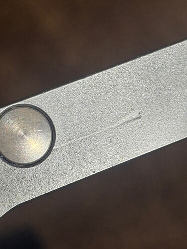

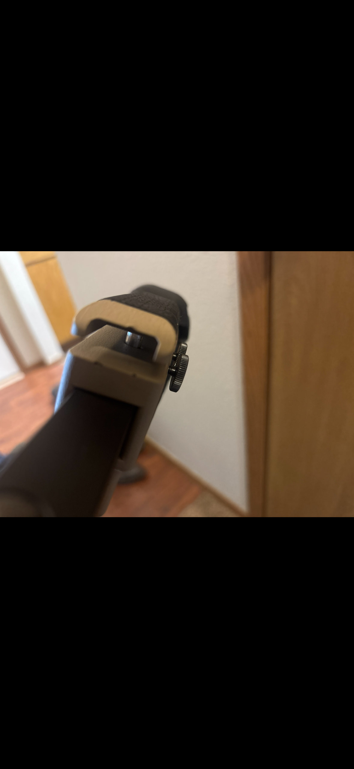

Some quality control issues that are very easily fixable. I also have splintering on both sides of my hand guard/NV rail and the bipod rattles in the pic mount with it being tightened as much as it will go but the videos won’t upload on here. Already emailed Jim about it waiting on his response
Yikes! That is not okay at all. I’ll get with you on email. Not sure who shipped this…
Just sent these pics to my team. We’re gonna get you a return label and send you a perfect one.
It’s crazy around the shop and I’m just hoping our shipping person did not ship from the blemished pile.
Thanks for being patient with us. Will be fixed immediately.

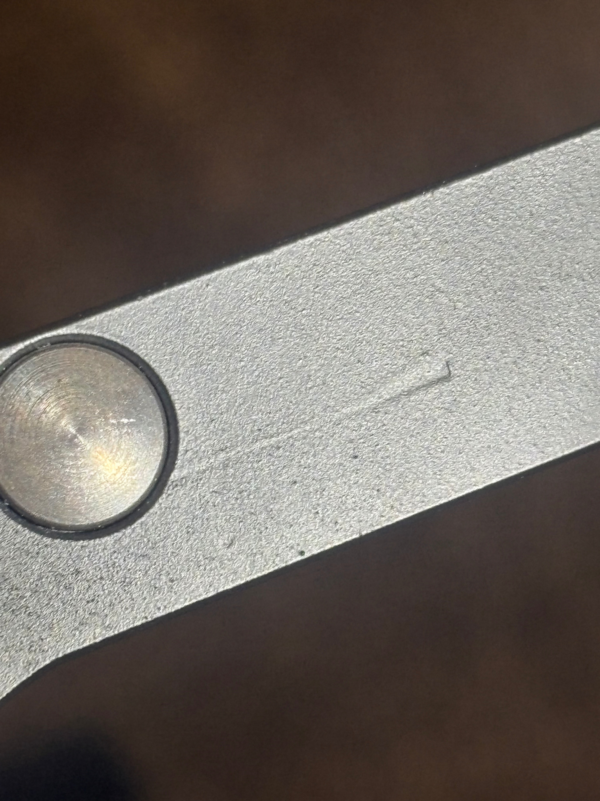

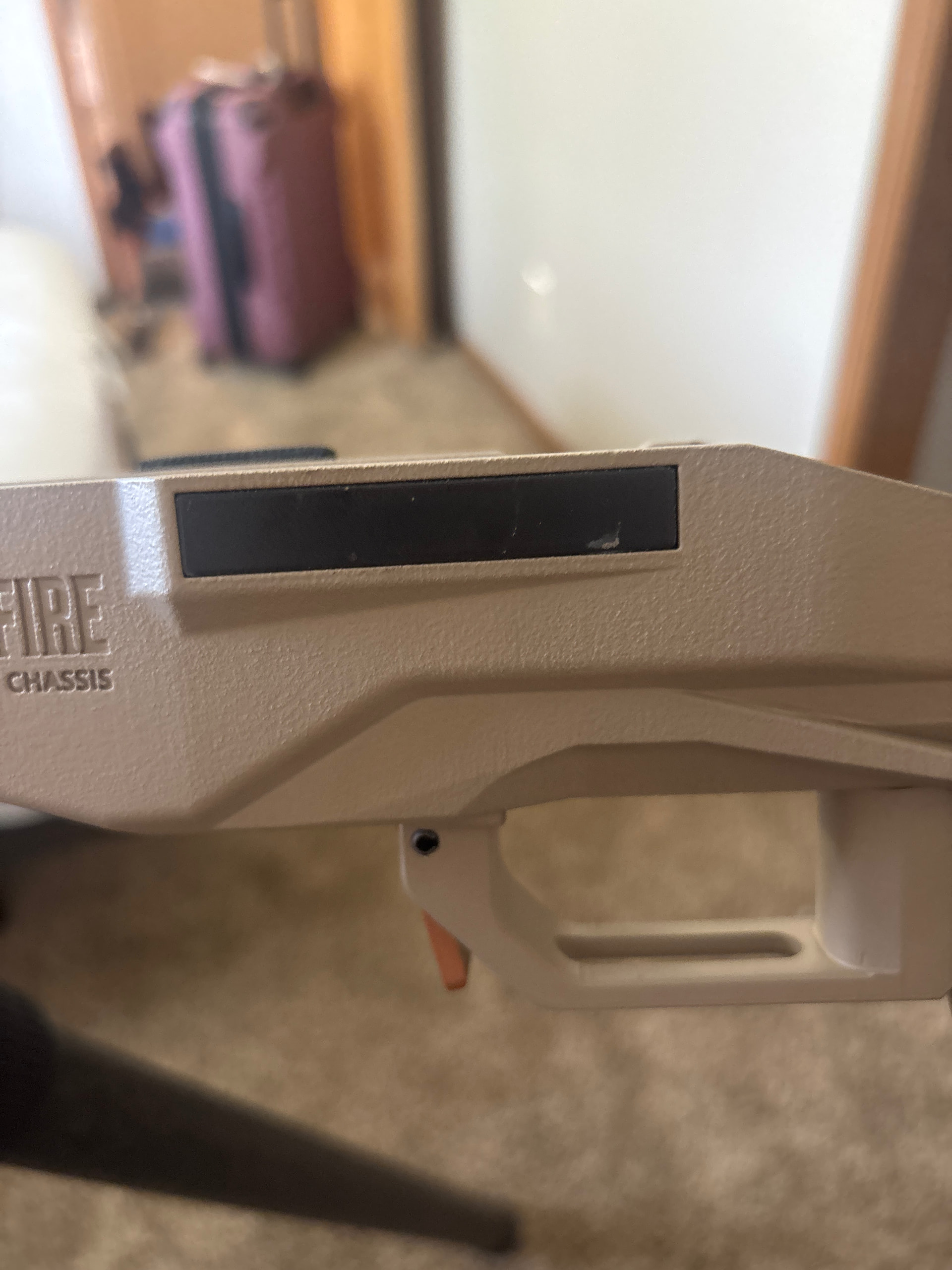

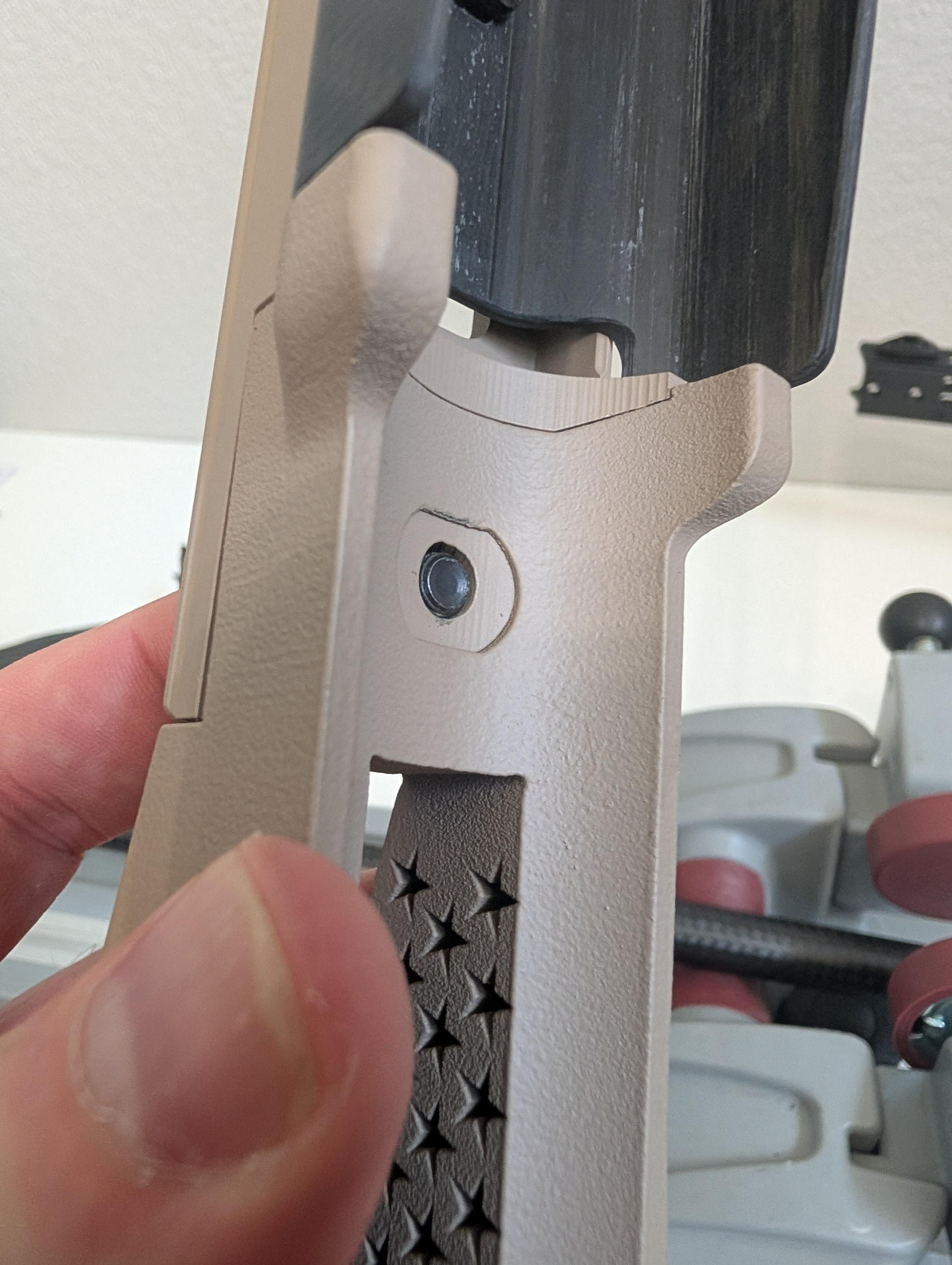

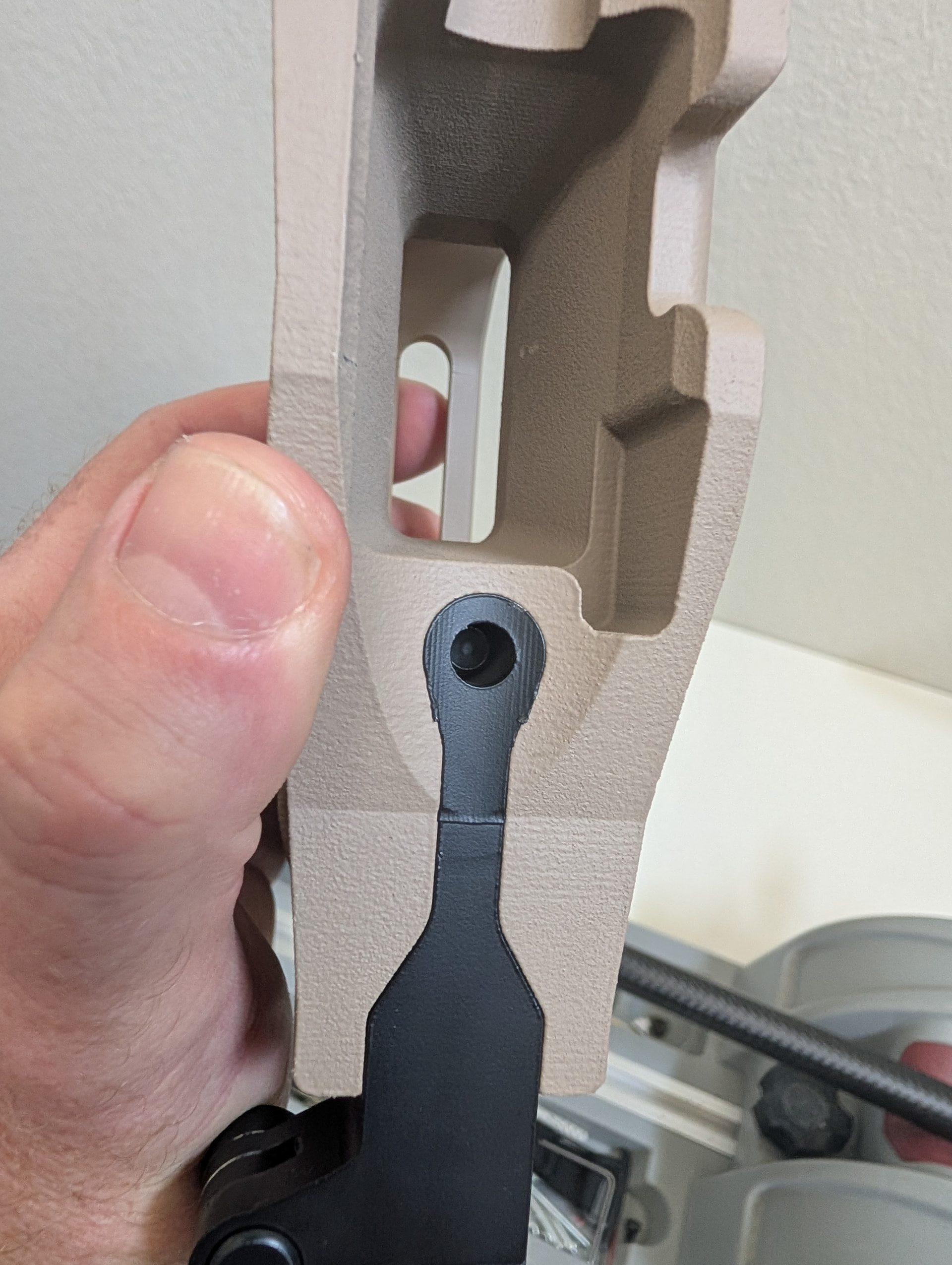

Hey Jim, I think I may also have received a chassis from the blemish pile. Neither action screw is able to reach the action through the stock, see images (action screws inserted as far as they will go):
Or is this normal and I just need extra long action screws? I’m using the screws that came with my Bergara.
Took out the caliper and found zero in the chassis so I could measure what size actions screws are needed:
1/2" Front
1 1/2" Back.
My Bergara has .33" front and 1" back.
Going to see is the local big box has some stainless 1/4"-28 Hex head bolts that will work. Thought I’d share that in case others run into this one as well.
