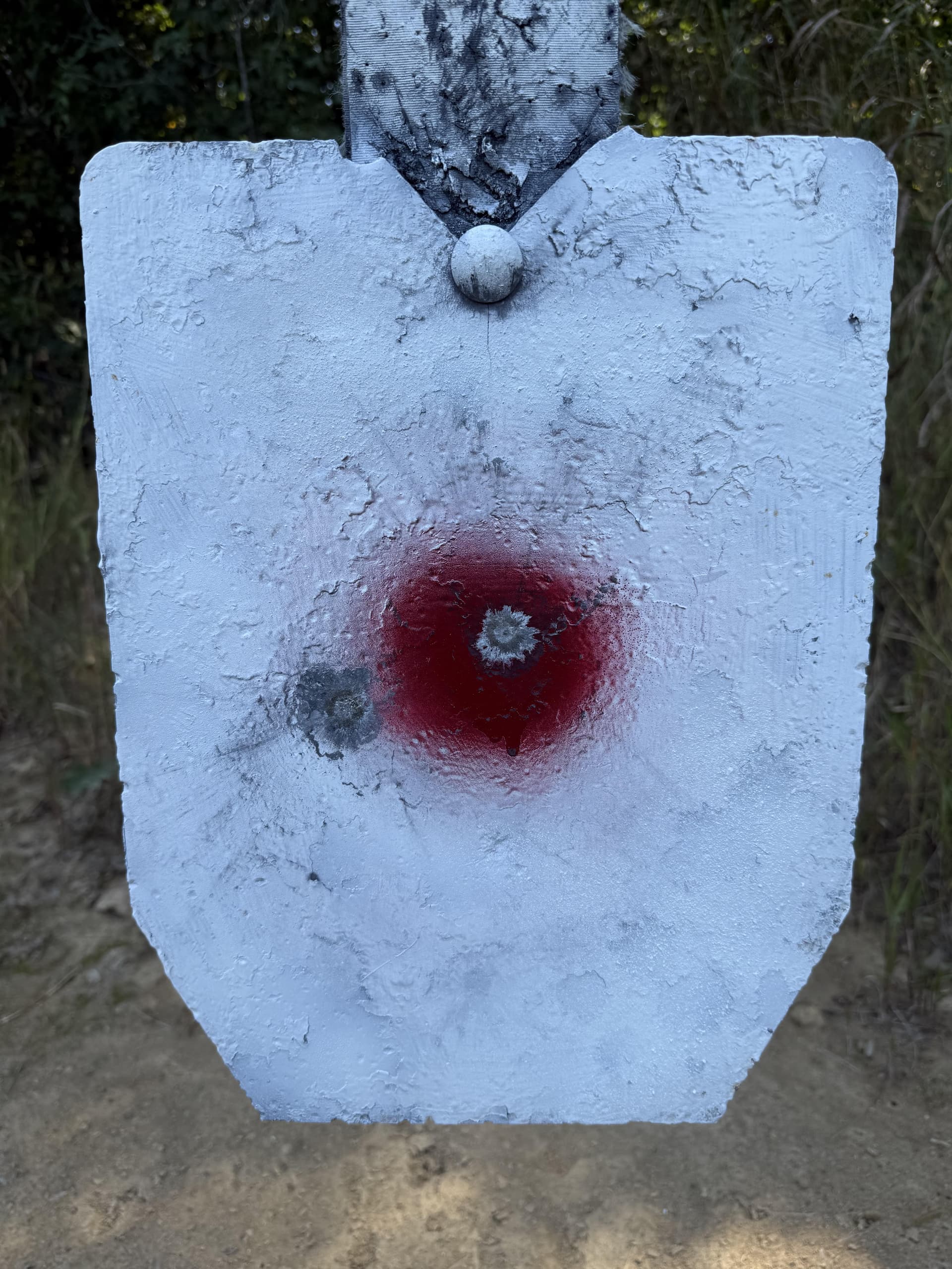

I went out to my local range today that has targets from 100 to 810 yards. I did surprisingly well for having never shot out to 810 yards. I was actually nailing the bulls-eye at 810 with my 280 AI and custom reloads. With that said, I used the Hornady ballistics app, but it was high at every distance. 300-500 yards I realized that I could multiple the MOA it gave me by 90% and it would be almost perfect. At 600 yards it required less correcting and I used 98% of the listed MOA, At 810 Yards I used 96% of the MOA listed in the Hornady app.

Two shots at 810 yards.
