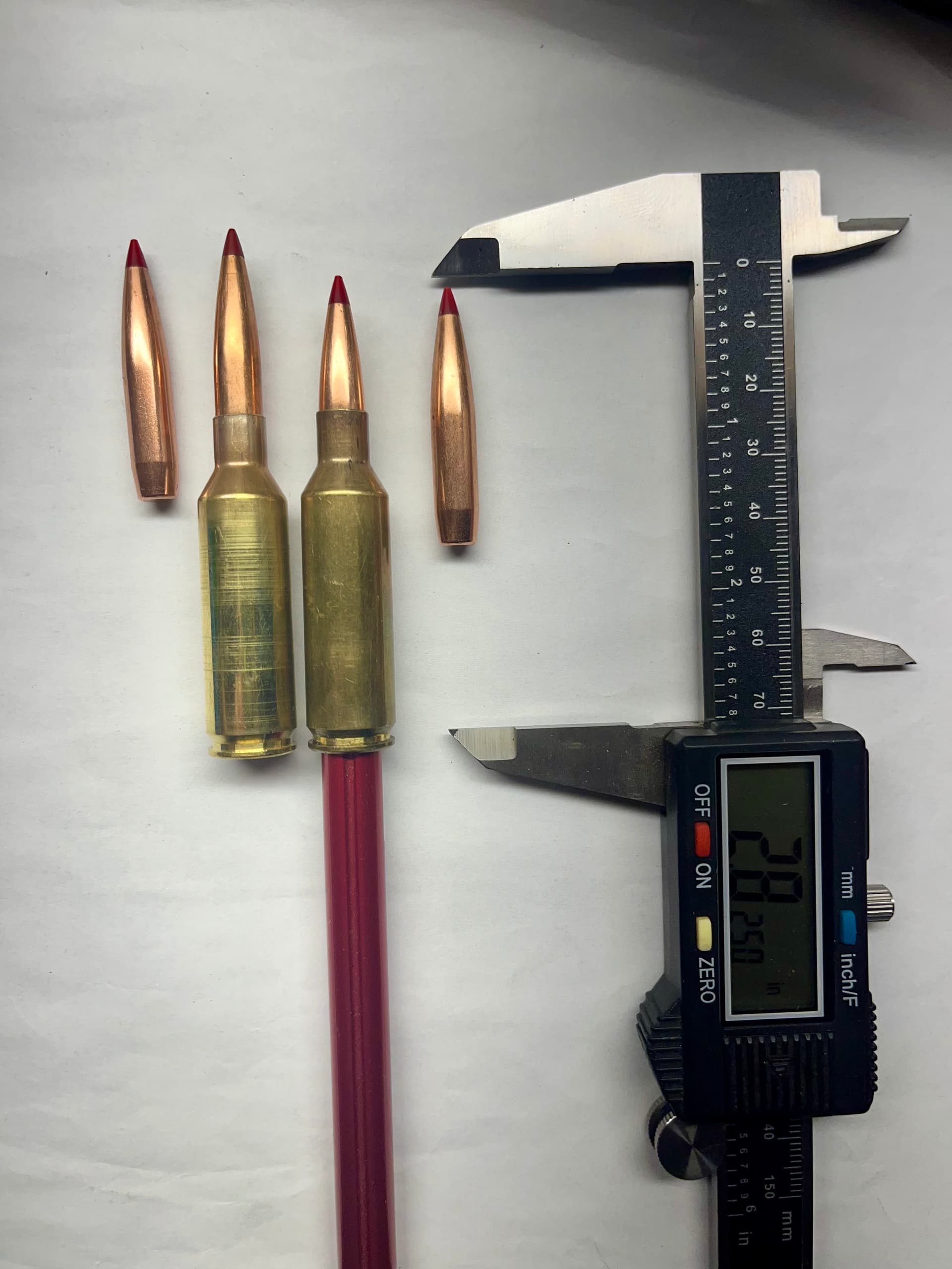

This kinda conveys what I mean. The Sammi length for 7 SAUM is 2.825” as seen on the right. Notice how far the projectile sticks into the case. On the left is the same cartridge, but the OAL is 3.150”. Both projectiles are 175 eld-x.

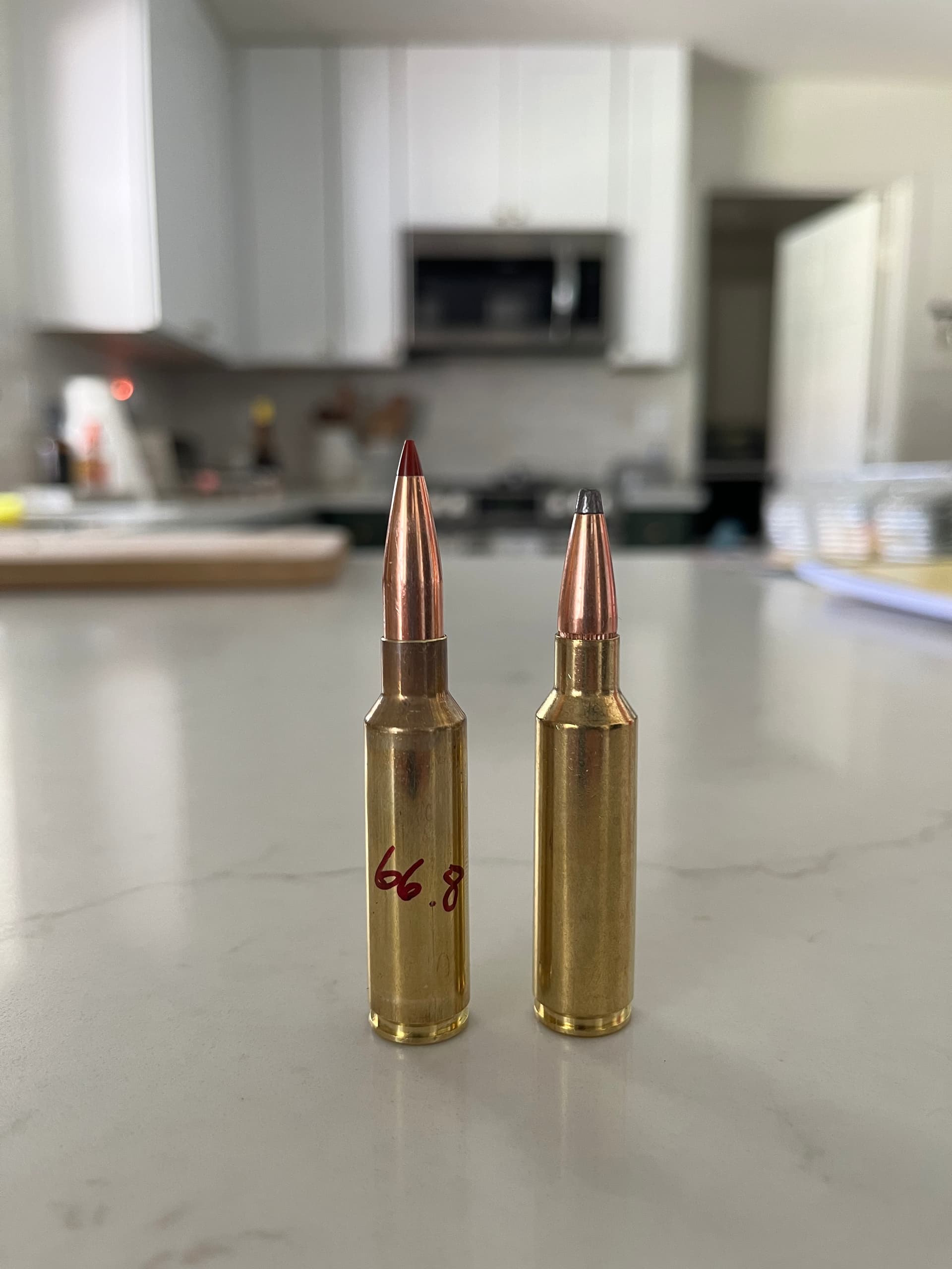

Here’s a comparison of a longer OAL 300 wsm hand load vs a factory offering…

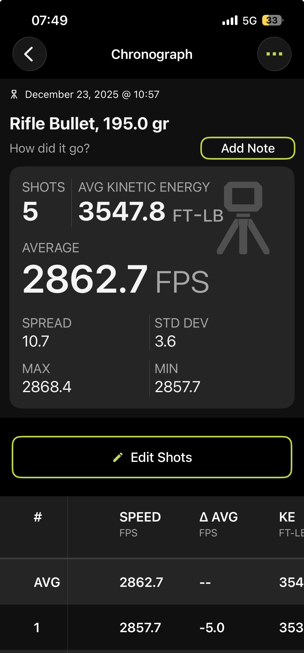

as an example this is chrono data for 195 elite hunters out of a 30” 7 SAUM barrel on a tikka action with 60-61 grains of n560 powder and a coal of about 3.14” (I’m at work and don’t have the exact load data on hand).
