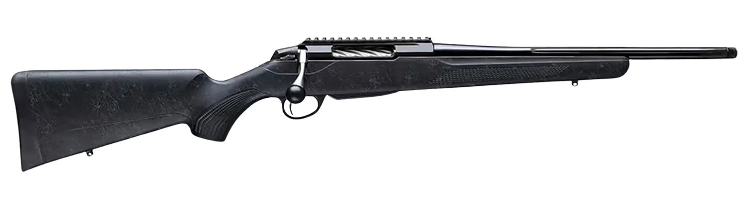

This shows currently out of stock but this is my primary hunting gun I use. Sounds to be about what you are looking for. Its under your budget too so you got room for upgrades if you wish.

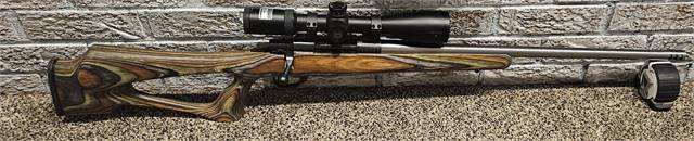

If you live near Idaho or maybe the guy will ship it? Here’s a interesting deal
