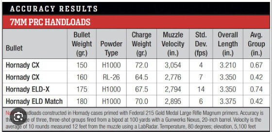

H1000 data for a variety of bullets. Note the 20 inch barrel length.

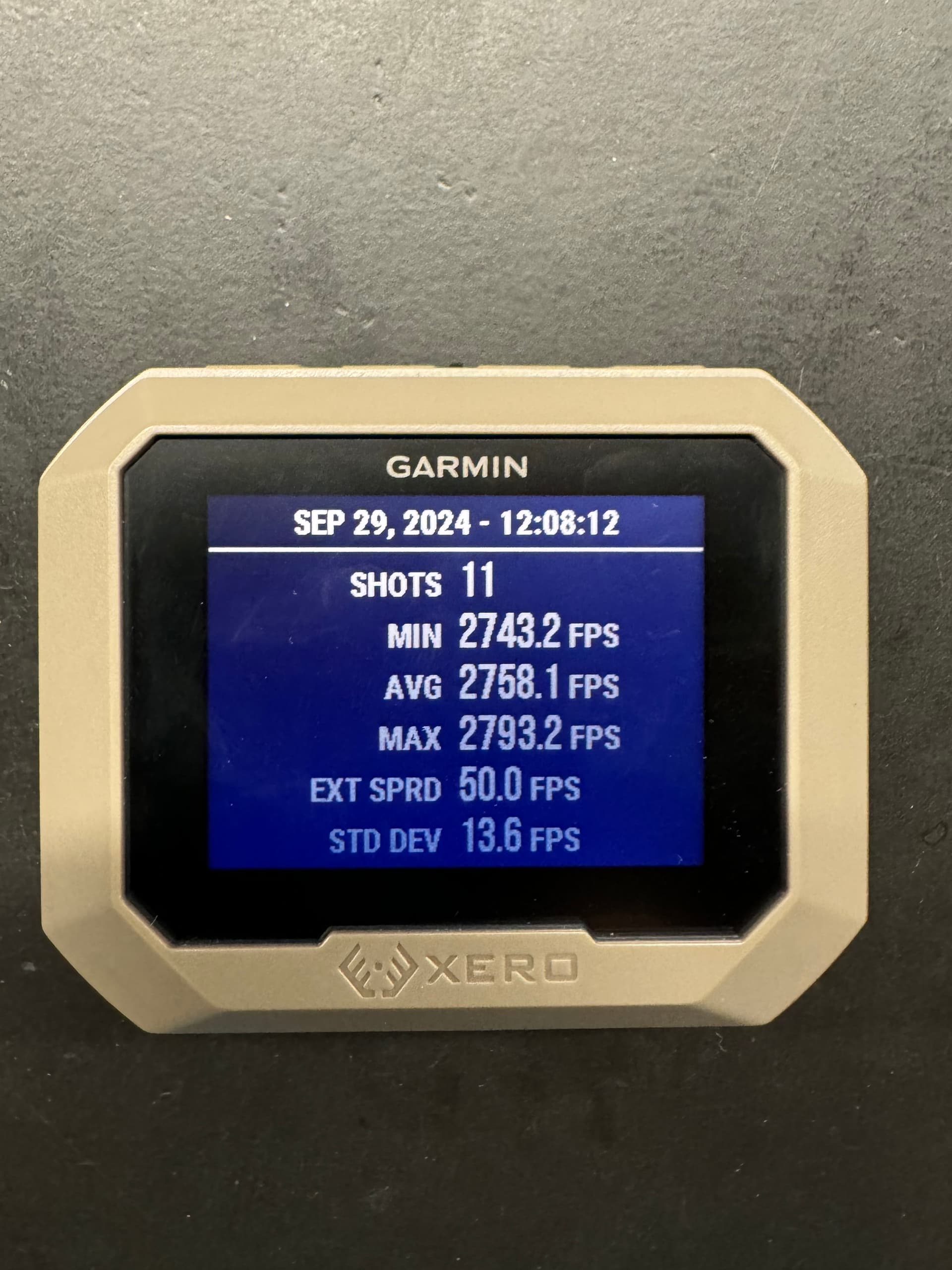

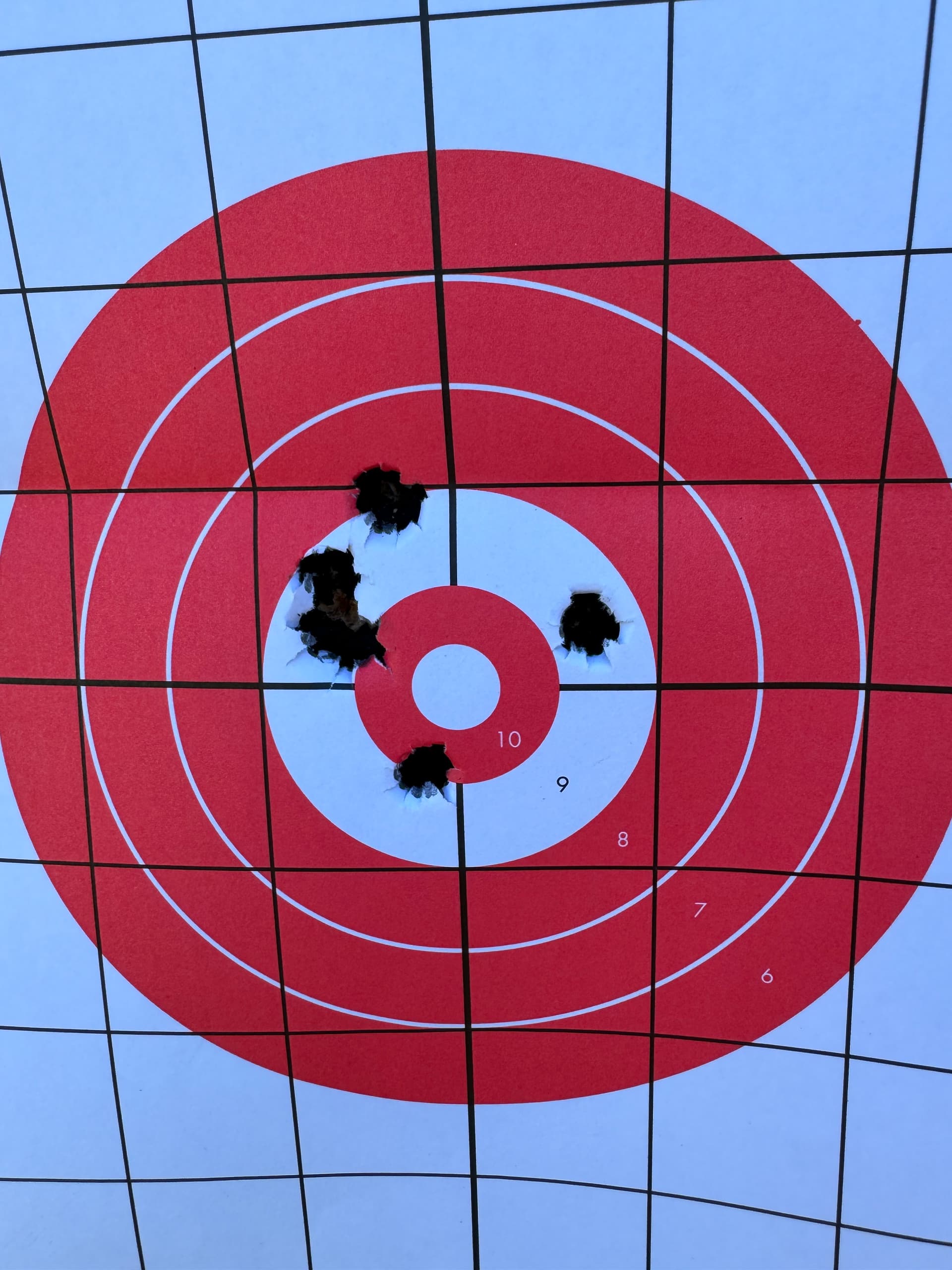

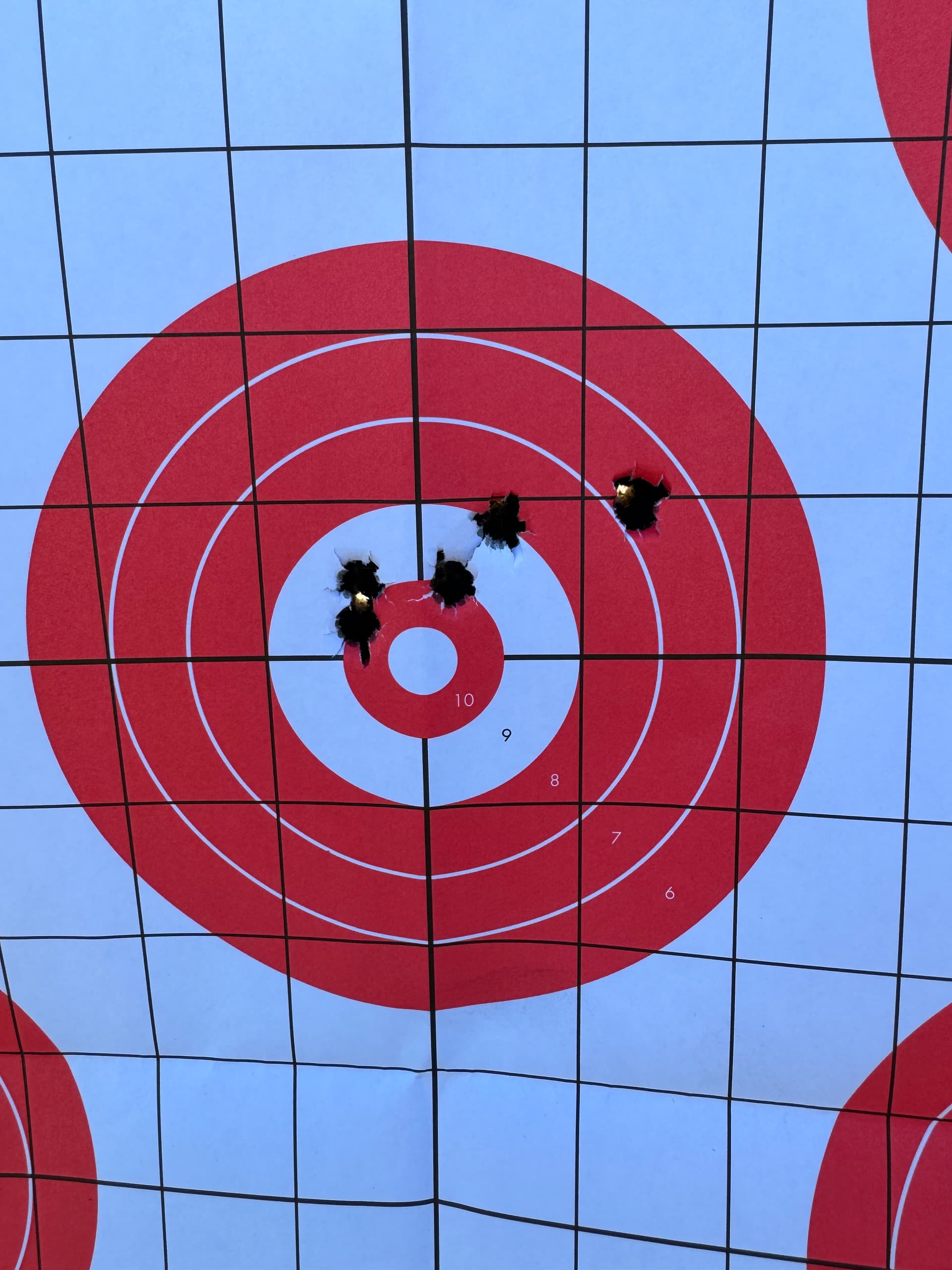

This was my first attempt on 7PRC. Just started reloading. So here is my dope.
Once fired Hornady 7prc 175gr ELDX brass
175gr Hornady ELDX Bullet.
Winchester WLRM Magnum Large Rifle Primer
65.9gr H1000 powder
I think the accuracy is better than these 2 targets show. I had changed rings on my Burris Veracity and did a rough sight in, The rifle was fairly hot and the mirage off the suppressor was terrible a had difficulty in seeing the crosshairs. Anyway this was my attempt including chrono.
