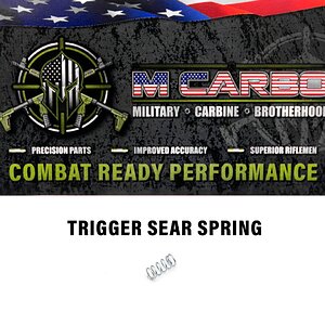

Definitely let us know once the recoil pads are available for the xbolts! I have heard from many people that the trigger is heavy. Do you recommend just switching it out for a Timney trigger or would buying just the MCarbo trigger spring kit work just fine?

And how much is a mcarbo trigger going to set me back for?
Thanks
The MCarbo is a sear spring kit. It’s relatively inexpensive.
I almost never recommend buying a spring for a trigger. Most triggers are engineered to only be safe with a heavy spring.
An xbolt may be an exception. I was told by a rep for the company that it’s literally just a lawyer thing and the trigger can work safely with a light spring. Based on that, a cheap mcarbo spring could be a good choice if you feel it’s safe. But it still makes me uncomfortable so I usually get a timney.

I put an MCarbo spring in mine and set at 2.5 lbs - much love. My daughter uses factory trigger with OEM spring at 3.5 lbs and she’s happy with it. Very accurate & precise.

Thanks for the link. A simple $13 spring will take care of the problem at a fraction of the cost of a Timney trigger. The link also has a video on DIY. Love vendors who go the extra mile to provide the customer with as much information as they can to make life easier.
