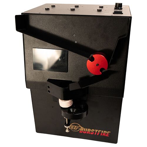

Burstfire 2 in one Induction Annealer
Hey all has anyone used this yet The burstfire 2 in one annealer and prep center? Looks really promising
I have the knock off. Just like the Burstfire Gen 2 2-in-1. It works well. I do it at night so I don’t have to mess with the Tempilaq anymore. Listen to tunes on the patio and just watch the glow and adjust the time in accordingly. Much less trouble. Great job for less money.

When you set up your anneal times Its just visual as ther is no Aztek like mode on this annealer. So what’s your process for each lot /batch headstock setting do you set It up for location first with no anneal then start at the lowest and increase time until It just faintly glows light orange in the dark and say you are good?

Yes… pretty straight forward. Select the caliber needed on the turret wheel, drop a piece of brass in with machine off and adjust the auto case ejector height. Once that’s done, turn on the water pump/heater and run a piece of brass through. We are looking through the top of the heating element to see when the case neck starts to turn red before ejecting. Once ejecting we also confirm we if we need to adjust case height based on anneal line. We make adjustments to timing and anneal height as needed, then run another case through. It may take a few cases to get set for each brand/lot but once you have that set, you have the setting for the next time you run that brass through. The process we are using is not an exact science but it if you have annealled with a flame annealler, you will know when you have it setup.

Thanks that’s what I figured and yes thinner walls wil go much faster. I’m pretty much using lapua for my reloading right now I have just a few calibers and it’s all precision nothing else. So on your lapua brass have you found a setting area that works well? I’m sure It can vary
Listening to some music and just watching the glow. Because it goes so fast, I am busy moving the annealed brass out of the way from the drop pot to another larger container. It also gives me a little time to think about other things I am designing and modifying. ‘Tim the Tool Man’ upgrades constantly.
24-26 seems to be the range we have seen for Lupua brass … at least for the brass lots I have.

So I’m at 56 for 308 lpr Lapua with lights off It just pops orange night bright. Will seat the first carts today and see how It goes. Thanks for all the input.
I love mine. The prep center was an added bonus. Easy to change the feeder from magnum to smaller cartridges. You don’t have to ruin a cartridge to use it as well. It’s probably not as. Precise as the amp, but it’s wayyyy better than a flame annealer and the price is right. Also you can load it and go. Works flawlessly once you figure out the annealing time for individual cartridge companies and caliber. Has been the single biggest game changer in reloading for me so far. Cuts the annealing process by 1/4 or less. I actually look forward to annealing.
