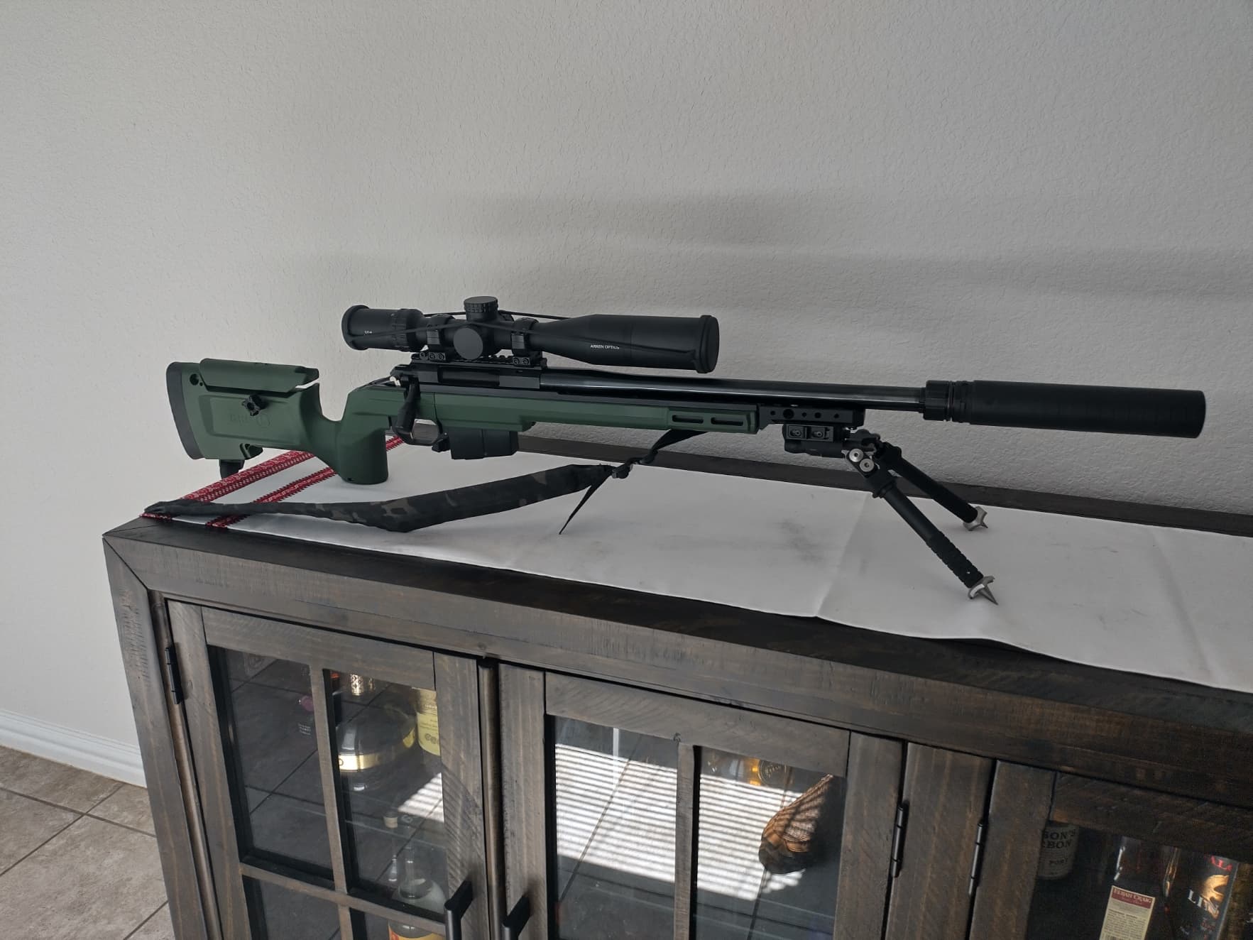

This is a rifle that I assembled myself exactly that way -
Aero Solus action, PBB barrel, KRG Bravo chassis, timney two stage trigger.
