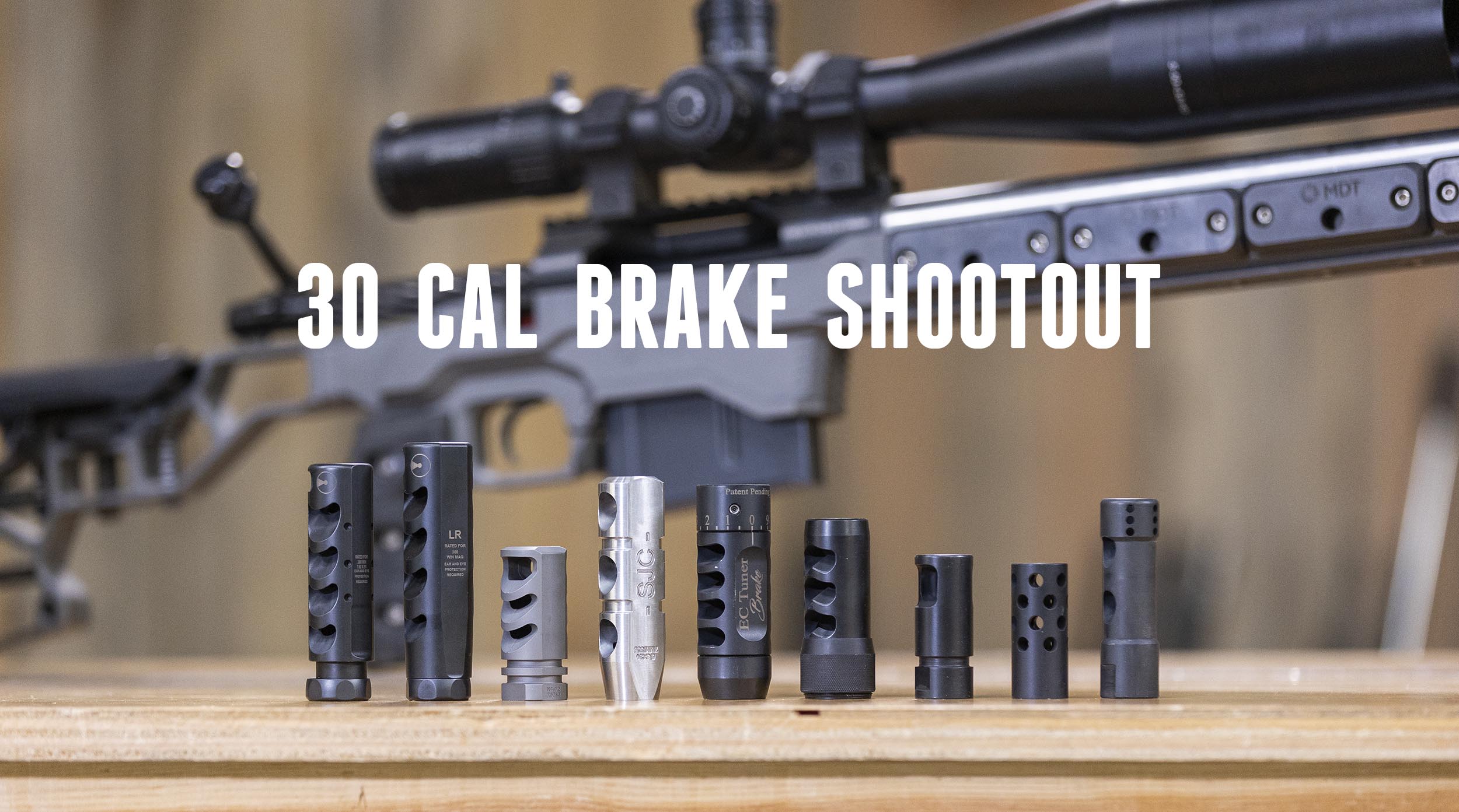

What I have seen in videos discussing brakes, is that sometimes the design, the hole pattern, the alignment of the brake not being perpendicular to the weapon; or aligned slightly crooked, the way the gas exits the port will push the barrel one way or another. Some brakes perform better than others at trying to control muzzle flip and recoil. You may want to google Ultradyne, they make brakes, highly recommended ones, and see what they say on the subject.
There are some good videos out there that speak to this so would recommend doing some searching and reading to diagnose what may be your issue.

Ben, down into the article he speaks to sight picture disruption with a brake; probably has other articles to help you out.

I’m a fan of Ultradyne. I have 2 of their chassis, so I am giving their Apollo LR a try. Unfortunately is about 4.5 oz heavier than my current break, but if it works I won’t care :slight_smile:

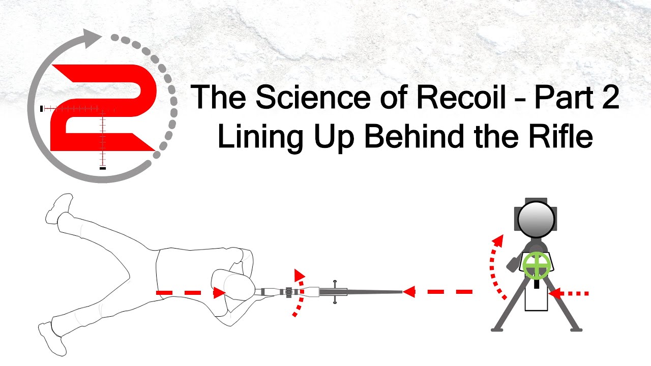

Not sure now how I found these videos, but video number 2 helped me re-evaluate my setup on my rifle. It specifcally went over why I see muzzle rise and bounce to my left. I was able to make a smal tweak that I think will help.

Makes sense. Sometimes, when we shoot off a bench, it creates a situation where are leaning over the rear stock to get our cheek weld and line of sight, and so the stock is not flat against the shoulder, but on the edge of the butt pad. Good data.

Bought the Apollo LR. Got it out to the range today and saw ALL my impacts. Man, I never knew the RIGHT break made that much of a difference. Its 4oz heavier than the one I had on it, but I think I can lug it around without too much trouble.
Thanks for the advice, I really appreciate it.

Nice and short to the point videos. Thanks for posting.
