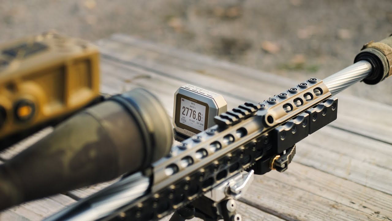

Garmin.
Area 419 people like it

Carter that garmin looks nice from the video and what they are saying on the website.
The size is nice and an option for bow is great.

Garmin has just came out with a doppler unit for $599.00. And of course just after I bought a LabRadar!
