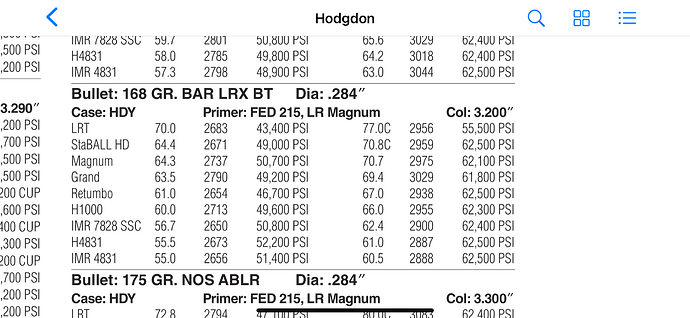

Loading 7PRC with 168 LRX and using Hodgdon data for H1000. 60-66 grn listed.

Then Barnes publishes its data for that round this week and instead of maxing out at 66, they max out at a little over 69 and do note that it is a compressed load.

What a confounding round, Hodgen’s manual shows 66 for the max, does not list it as compressed. I will try and load 5 this week and see what results I get. I am going to try the COAL in the chart.
