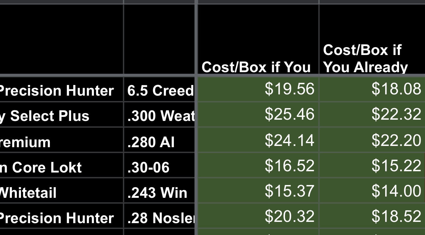

Because the cost of powder, the bullet, and primers have also jumped up, in addition to powder, your breakeven point for reloading, when you have to buy the reloading equipment, is much longer than it used to be in the past. I think it would be probably somewhere between 500 - 700 rounds. If you have a buddy, and just need the dies, and components, using once fired brass, the cost goes to $25 per box vs 40. In todays reloading market, it is difficult to shoot any large capacity round a lot and be economical. I would tell you to start looking at garage sales, classifieds, and asking around about reloading presses, etc. to get you started. My first press was 30 years old when I got it, and I still use it as much as my forester coax. Lot of people get into reloading, get bored, frustrated, and want to sell the stuff now sitting in a garage…just like golf clubs.
