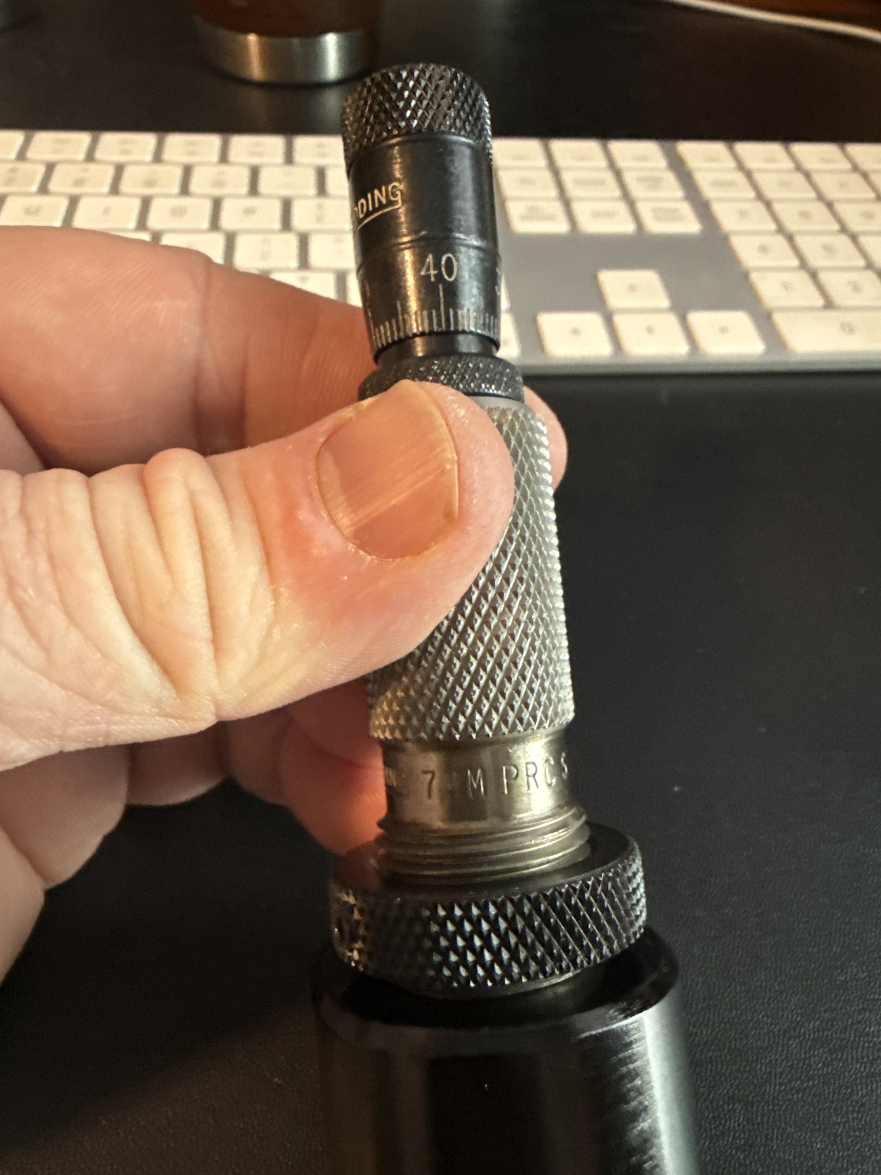

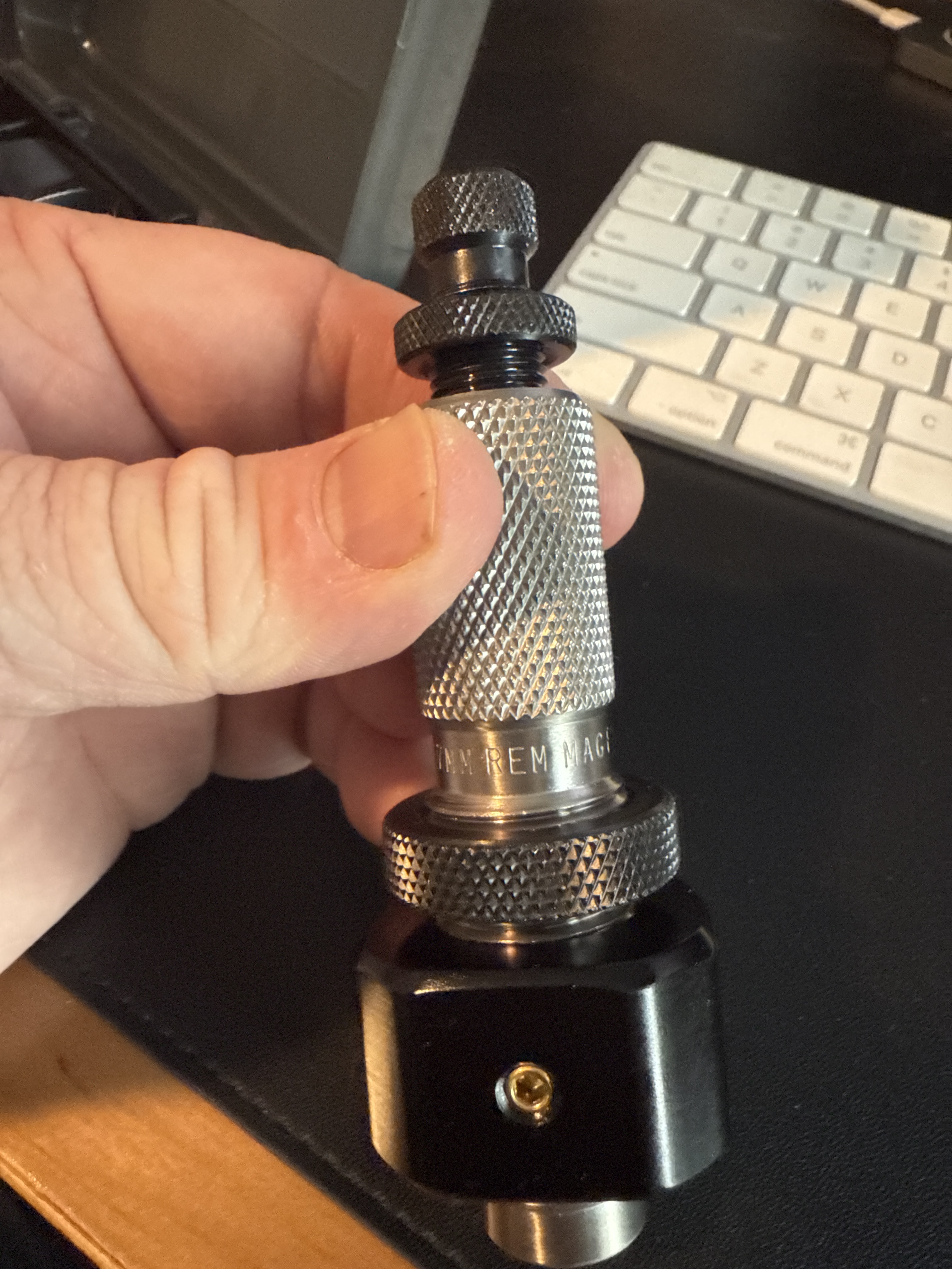

Are these dies correct? One say 7prc and the other says 7mm rem mag. Just ordered them off of midway.
If you have a 7 PRC, then only use 7 PRC dies. 7 Rem Mag is a completely different chambering.
What I figured
