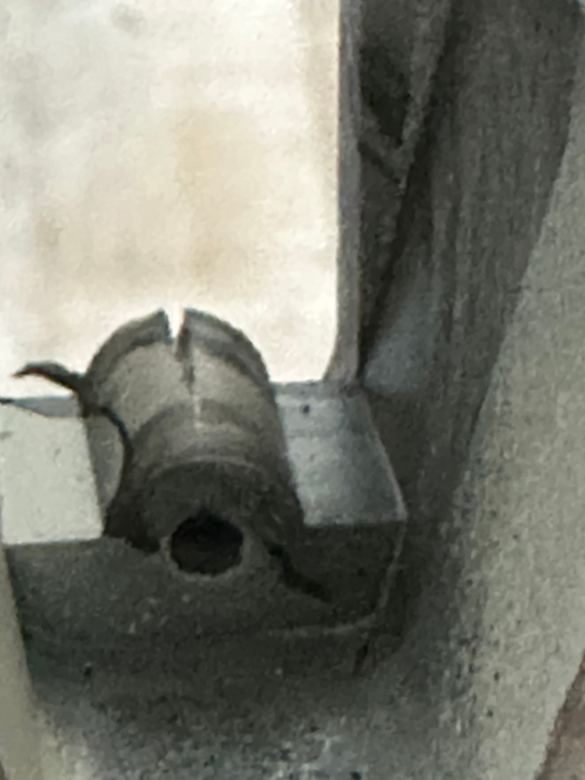

Crack in stock @ rear action screw
I was putting new rings on my Savage 110 (Polymer Stock) .243 and felt that the action tighten up. After investigating I discovered that the stock has a tiny crack @ the rear action screw. Enough so that it will not tighten to the 40inlbs is supposed to be at. Not sure that has anything to do with the action tightening up (its still tight even outside of the stock), but I don’t like that I have a crack there.

I went ahead and purchased the Ultradyne UD. $299 for the Anodized black (which hides wear better that Cerakote) and you can’t go wrong with black. I have some spare parts from AR builds so all in all this could have been much worse and in the end I am getting a significantly stiffer stock, an Arca rail and QD flush cups. Not really needed on this gun but you never know…
