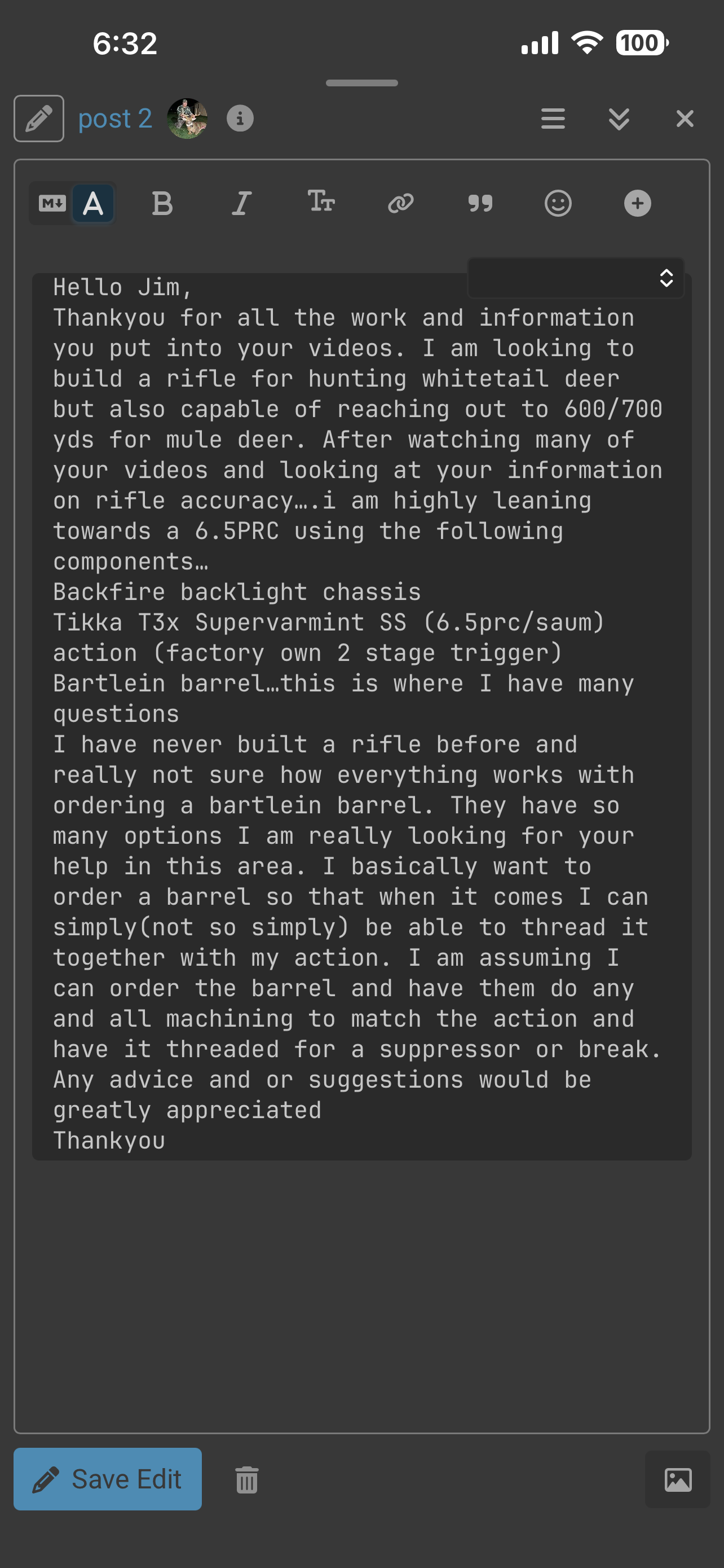

Looking to build 6.5 PRC. My thoughts in screen shot comment.

I set out to build the same setup! I’ve tweaked as I went along but I’d be curious who you’ve talked with thus far.
Stuteville precision - Jim recommended Wade for his expertise and quality Bartlein barrels. He said he’s best of the best. He really only does impact actions so that’s where it got tricky for me because I still needed to add a trigger/rail which got to be on the higher side for what I was wanting to pay for a nice hunting setup. Still an option though.
Preece precision - Garret was also mentioned and he seems to be an expert with Proof barrels and tikka actions. He does the chambering. At one point Garret did say he could take a barrel (maybe from Stuteville) but when I talked to Wade, he recommended to stick with one gunsmith. He’s also reasonably priced and I’m leaning towards this setup at the moment (with a backlight chassis).
Blue mountain precision - another place mentioned but they do Benchmark barrels with Zermatt/other custom actions.
Oregon mountain rifles - they have lots of tikka customizations but I’m not sure if they’d take a Bartlein barrel.
Hopefully this gives you a couple things to consider.
Jon
